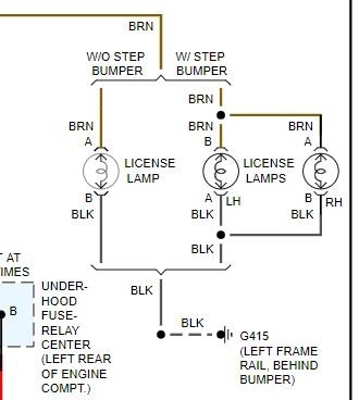

Okay, lets start over. I attached the portion of the wiring schematic for you to see. Now, according to the schematic, there are two brown wires, one to each of the two lights. Then, there are two black to ground on the frame.
If you are getting power to the brown wires and you have a good ground, I cannot see how it does not work unless the sockets are bad. I misunderstood earlier. I thought you did not use the new socket.
What I want you to try is this. Make a long jumper wire that will reach from the black ground wires from the lights and run it directly to the negative battery terminal. If they work, you have a bad ground. I realize you have cleaned a new ground, but it may fail under a load. This way we can confirm if a good power supply is going to the light. If it does light, we need to make a new ground. I cannot tell you how many times I would check continuity for ground and it checks good until a load is placed on it.

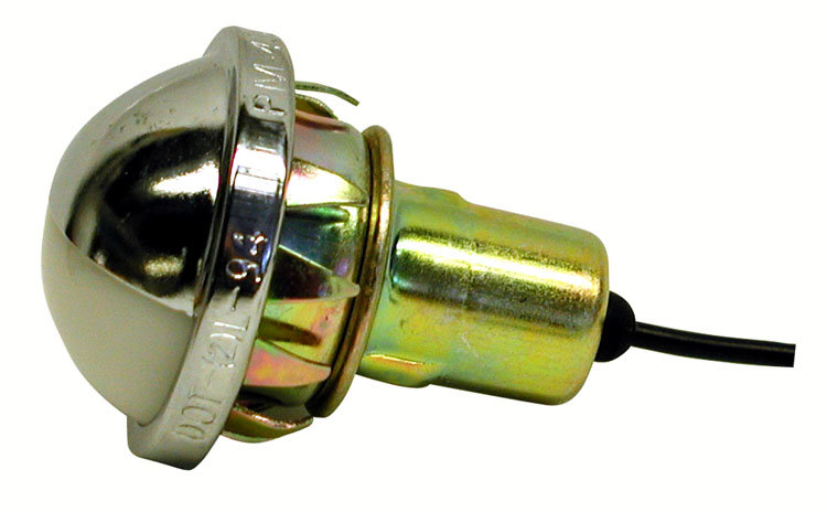

Okay Joe, this is not a factory bumper. This has the single wire tag lights that have been around for years that are suppose to ground when you push them in the hole but when that failed is why I solder a wire to the socket to create a better ground. I was just discussing this with a friend and we thought about running a jumper direct from the battery checking both power and ground as they did work when I battery tested them before installing them. So that will be in the morning and Ii will post my findings. One thing I did not think to mention as it is not a constant issue but sometimes the left turn light on the dash does not come on yet the bulbs are blinking on the outside. Did not know if maybe that is related some how as it is all exterior lighting except for the turn lights in the dash.
Nov 24, 2018 at 12:26 PM
GANDALF776
  • 10 POSTS
This is the style I have, but on mine I have soldered a ground wire to the outside of the socket.

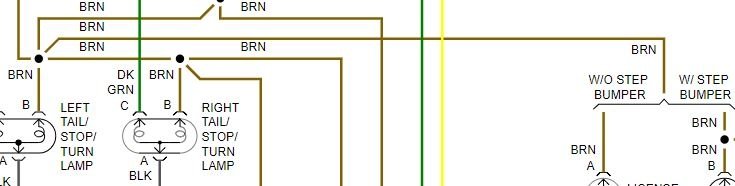

With that in mind, here is what to do. The power to the brown wire comes from the left rear tail light. It attached via a splice in the wiring. My guess is there is a weak connection at that point. What I would do is simply go back to where the splice is located and check it. With the lights on, wiggle that splice around to see if the lights flicker.
If they do not, cut the brown wire running to the lic lights and replace it. It must have a break in it at some point.
I attached the schematic that shows where they splice together. Do this and let me know how it goes.
