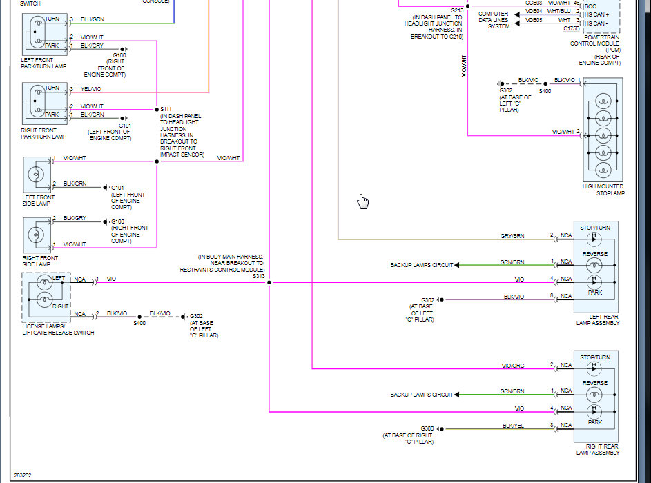

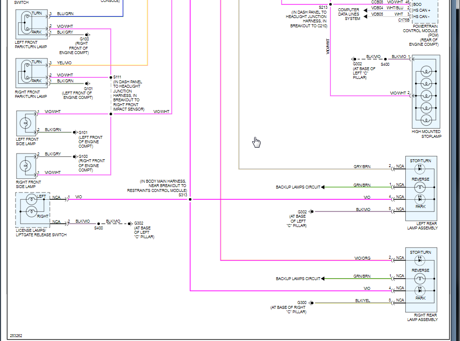

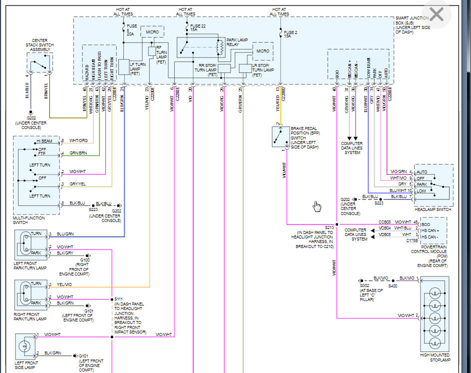

When I start my car listed above (Excel) I didn't turn on my headlights and I have no running brake lights or tag light.
Jan 2, 2021 at 7:14 AM
More then likely this is the smart junction box has failed but we need to test voltage coming out of it when the lights are supposed to be on. I am attaching the wiring diagram and here is a guide that will help with doing this testing:
https://youtu.be/Hlna_kUt7As
The SJB is more then a fuse block as it has a microprocessor on it and they are pretty common to cause issues like this.
Let us know what you find with this and we can go from there.
