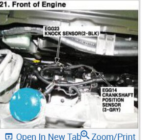

Last night while driving on the freeway with cruise control on I experienced my car "lurching" briefly then the tachometer dropped to zero. I was able to drive the remaining 15 minutes or so home without incident and after arriving home I shut off the car then restarted it and the tachometer started working again. I also went out this morning to start the car and the tachometer is working. What could be the possible reasons for this to happen and until I can have the car diagnosed is it ok to drive it or is there a real possibility of the engine stopping?
Jul 12, 2023 at 1:01 AM
  • 55,711 POSTS

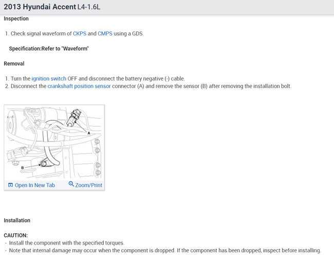

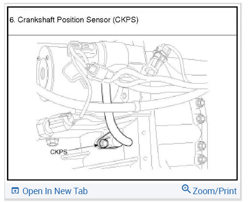

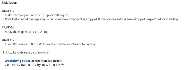

Yes, this sounds like the crankshaft angle sensor is going out. We should run the codes though. this guide can help:
Here is the location near the starter and how to change the sensor out. Check out the images (below). Please let us know what happens.

I just tried it. Idling in the garage for 15 minutes no issues. I backed out and was going to drive around the block. When I put it in drive within about 5 seconds the tach dropped to zero, felt the slight lurch. Parked it and went to restart it and got the check engine light when trying to restart. I would not start until I gave it some heavy pumps of the accelerator pedal then it started. I checked the code reader, and it said Crank Shaft Position Sensor.
Jul 14, 2023 at 3:36 AM
  • 55,711 POSTS
Yep, it sounds like you found the problem, I would replace the crankshaft angle sensor. Please let me know how it goes.
