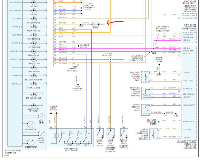

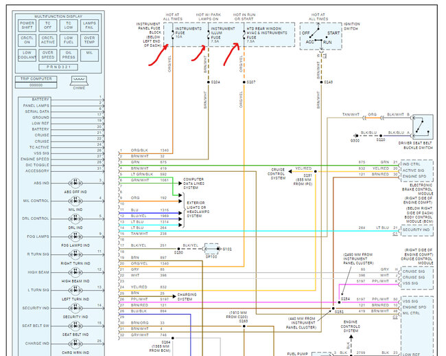

Gauges are always not working.
Apr 11, 2024 at 2:44 PM
  • 55,214 POSTS

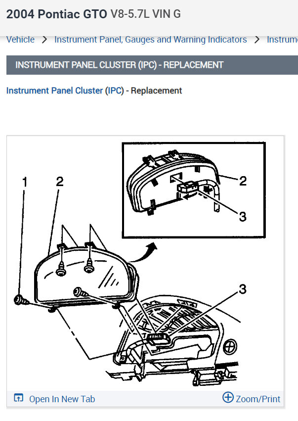

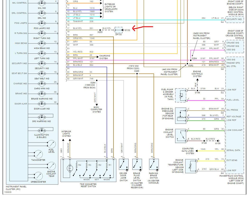

This can be one of three things either the fuses are out, the ground is no good, or the cluster itself went bad which is common. Here is a guide to check the fuses and ground which I have included in the images below:

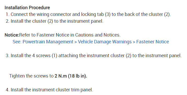

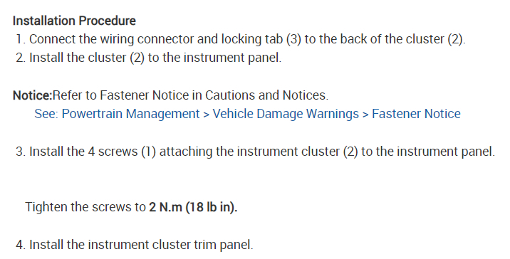

Here is how to change the cluster out, you can get a rebuilt unit by searching Google or eBay. Check out the images (below). Let us know how it goes.
