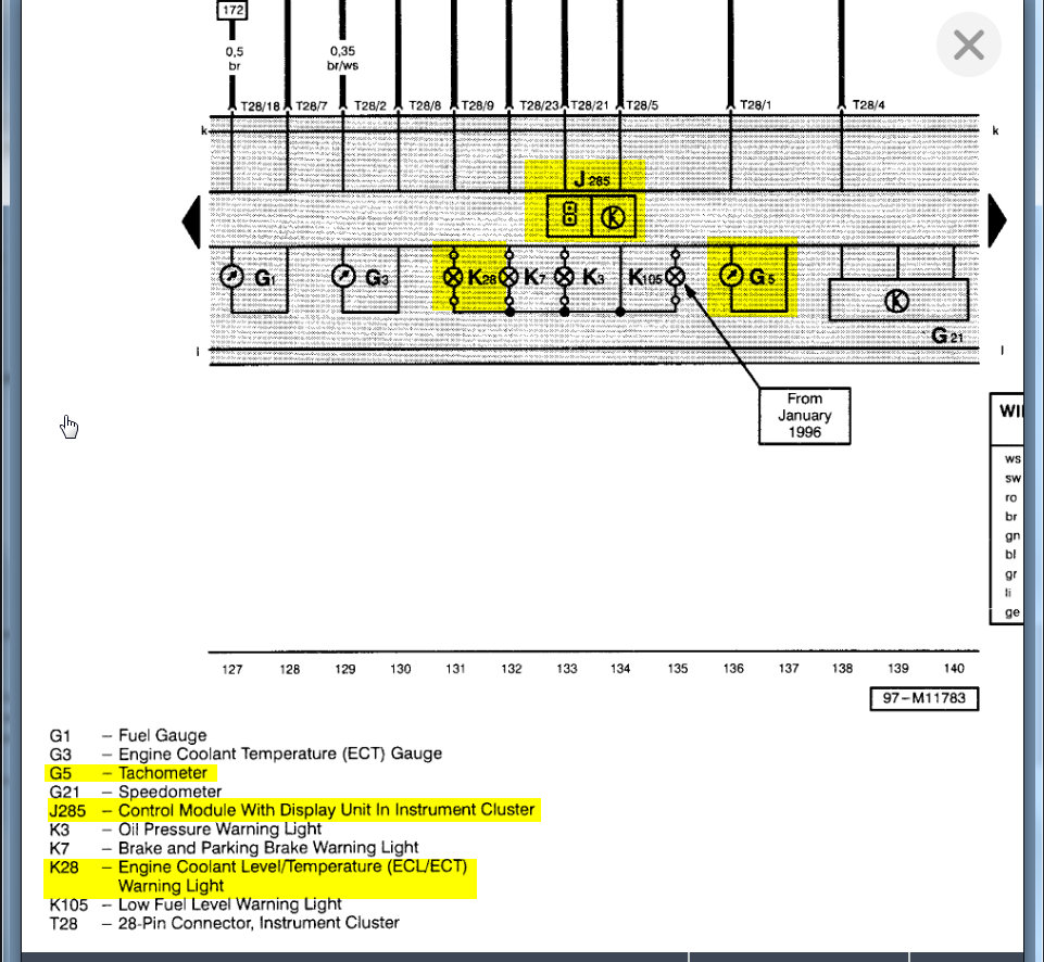

I was driving home and noticed my temperature light flashing (this has been going on for a while now). I recently had the thermometer changed, hoses changed, sensor changed, it just comes back, temperature gauge does not indicate overheating. So wasn't too concerned but then I noticed my tachometer all the way to the max (I was shifting appropriately). I checked today, I see no leaks, but still can't figure out why temperature light keeps flashing and tachometer is at max.
May 14, 2020 at 7:02 AM

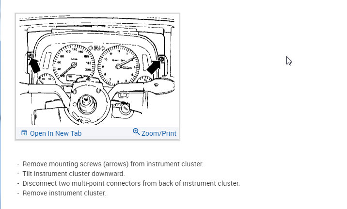

The most likely cause of this is the cluster itself. It has a control module internal to the cluster that is responsible for commanding these components.

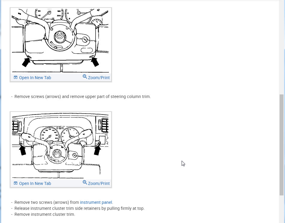

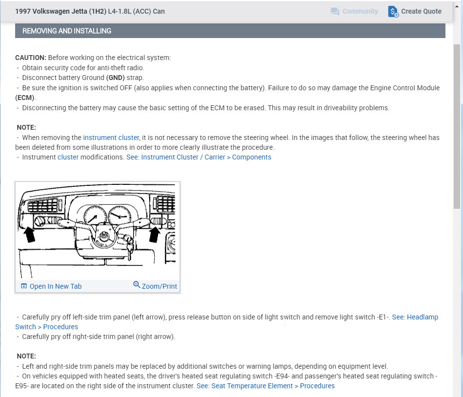

Take a look at the wiring diagram which illustrates this. I attached the process for replacing the customer if this is the direction you agree with.
Let me know what questions you have. Thanks
