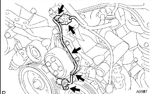

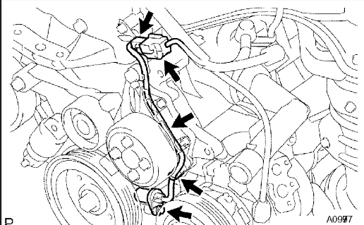

the engine wants to start crank but no start and no spark.
Sep 3, 2025 at 3:25 AM
  • 55,224 POSTS
It sounds like the crankshaft sensor has gone bad, here is its location so you can change it out. Check out the images (below). Please let us know what happens.

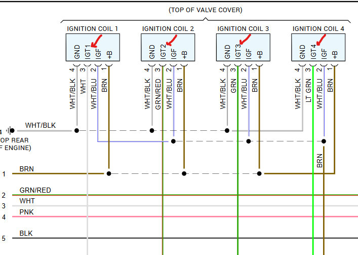

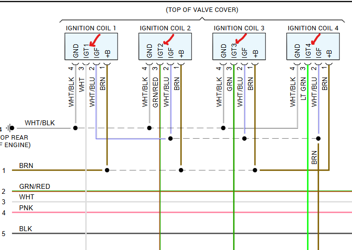

I don't know which wire to connect my voltmeter to the coils have 4 wires connected to it. which one is positive wire and trigger signal wire? hope to find the problem soon.
Sep 4, 2025 at 4:37 AM
  • 55,224 POSTS
There is two wires and a shield wire, use the red and green wires

how do I replace the crankshaft position sensor what all I have to remove out of the way?
Sep 8, 2025 at 5:05 AM (Merged)
  • 55,224 POSTS
Check out the instructions above.

which one of the 4 wires I check for pulse at the Ignition coils wire connector?
Sep 11, 2025 at 3:03 AM
  • 55,224 POSTS
Here you go. Check out the images (below)
Sep 11, 2025 at 3:25 AM
JOE1953
  • 803 POSTS
which wire is the signal wire?
Sep 11, 2025 at 5:00 AM
  • 55,224 POSTS
I marked them for you, check the image above.
Sep 11, 2025 at 7:18 AM

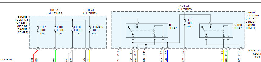

The first thing you should do is check the fuse listed below. Then turn the key on and test for power at the brown wire at any of the coils to see if there is power.
Check out the images (below). Let us know how it goes.
Sep 16, 2025 at 5:12 AM (Merged)
JOE1953
  • 803 POSTS
I check all the fuses under the hood with a multimeter I didn't find any blown, I havn't use the test light yet. do the Ignition switch need to be on for this test? I hope to find the problem soon the car need to be in working order.
