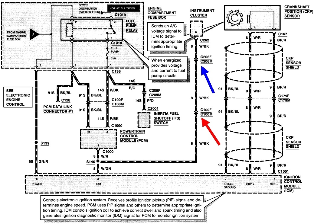

I've been working on this car for a couple of years and this year I decided to rewire the Ignition control module. I lost track of the wire that goes from the ICM to the tachometer. Under the dash I can see the white with black tracer wire that should be the tach control wire, but I can't see where it comes through the fire wall. Can you help?

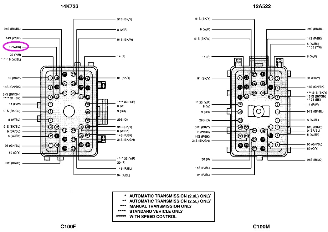

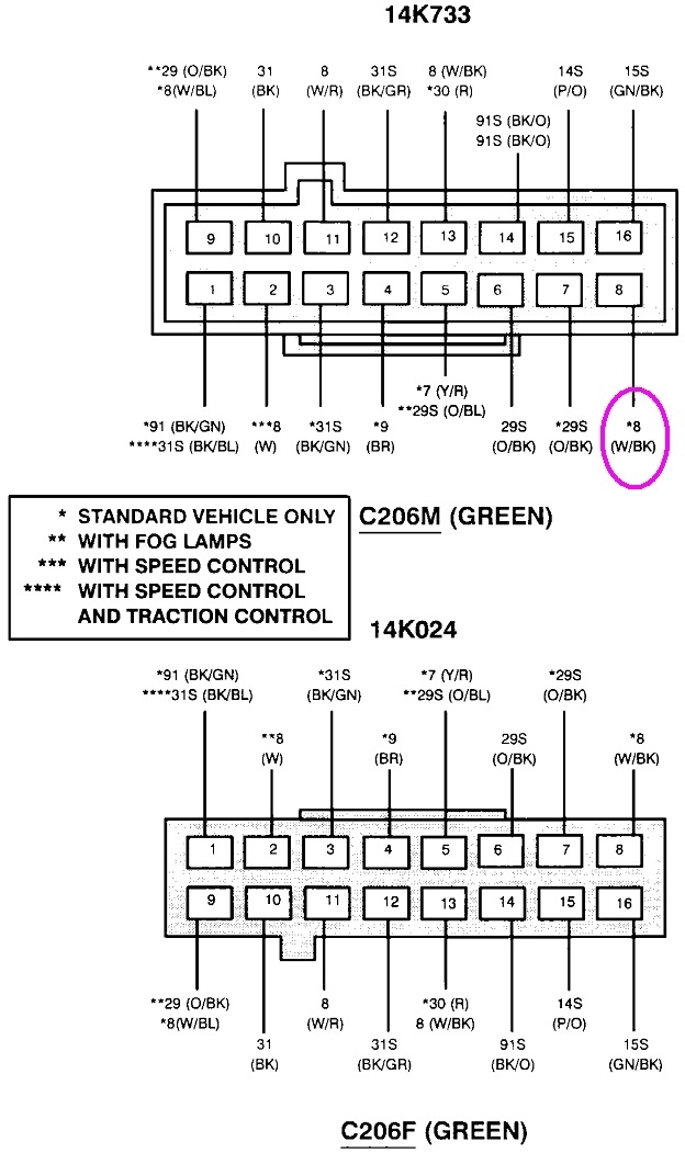

It looks like what you want is connector C100. The connector view is in the second drawing. Connector C206 is also in that circuit. It's listed as being under the dash. I circled it in pink in the fourth drawing.

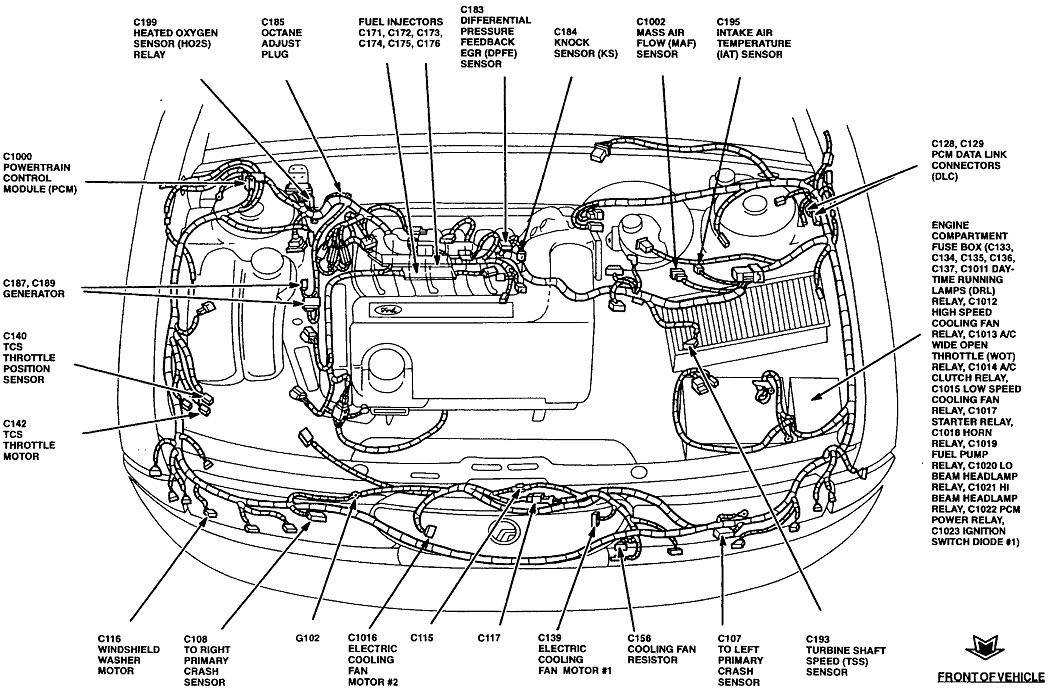

The location of C100 is top secret. It is only listed as:
"C100 LH side of engine compartment, near strut tower"

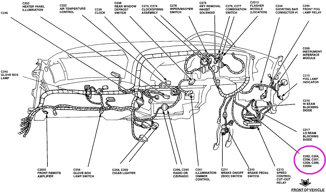

The location drawings all go back to that fourth one I posted, but it isn't on there. This fifth drawing shows the under-hood connector locations. C100 should be around the upper right corner.
