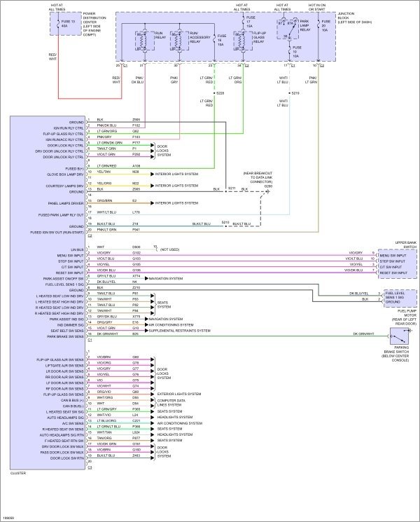

The screen located on the tachometer that would show mileage, error codes, door ajar, is dead. I looked at some fuses and they are all fine. I did the hold reset button and it still did not come on. Where is the specific fuse for it or would I just have to replace a bulb or something? I would have just replace the whole dash, but I want to make sure it wont happen again.

Here is a schematic that shows everything for the instrument panel. Find and trace out the affected circuit to locate the problem.
Jul 30, 2016 at 2:08 AM
SHOEY MCGRIZZLY
All the fuses and stuff looks fine.
Jul 30, 2016 at 2:28 AM
  • 55,649 POSTS
Then the instrument cluster has gone bad and need replacing.
