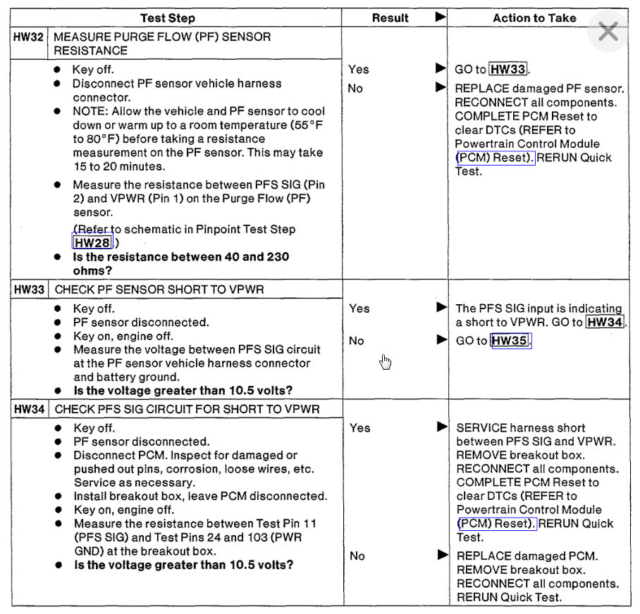

Also I have noticed the negative battery cable gets really hot in sure there is a ground issues also can that cause some of these codes?
May 2, 2020 at 7:00 AM
P0708 - Transmission Range sensor is open
P0755 - Shift Solenoid Electrical malfunction
P0117 - Sensor signal voltage is low
P1445 - Purge Flow sensor circuit issue

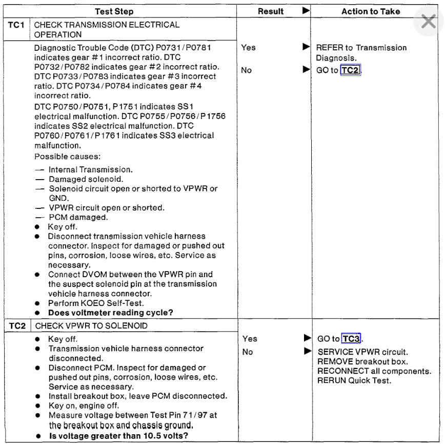

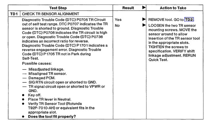

Based on these codes it appears you have a wiring issue with the transmission. I would start with running through these DTCs diag steps and see where it leads you then update me on what you find and we can go from there. Thanks

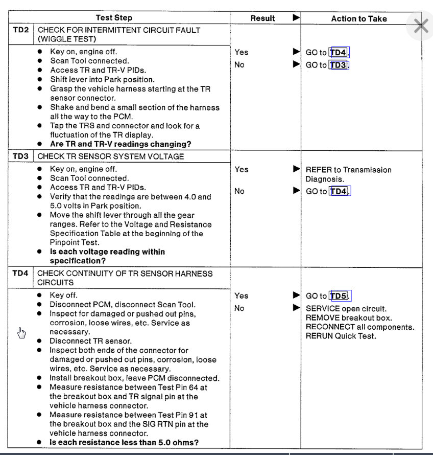

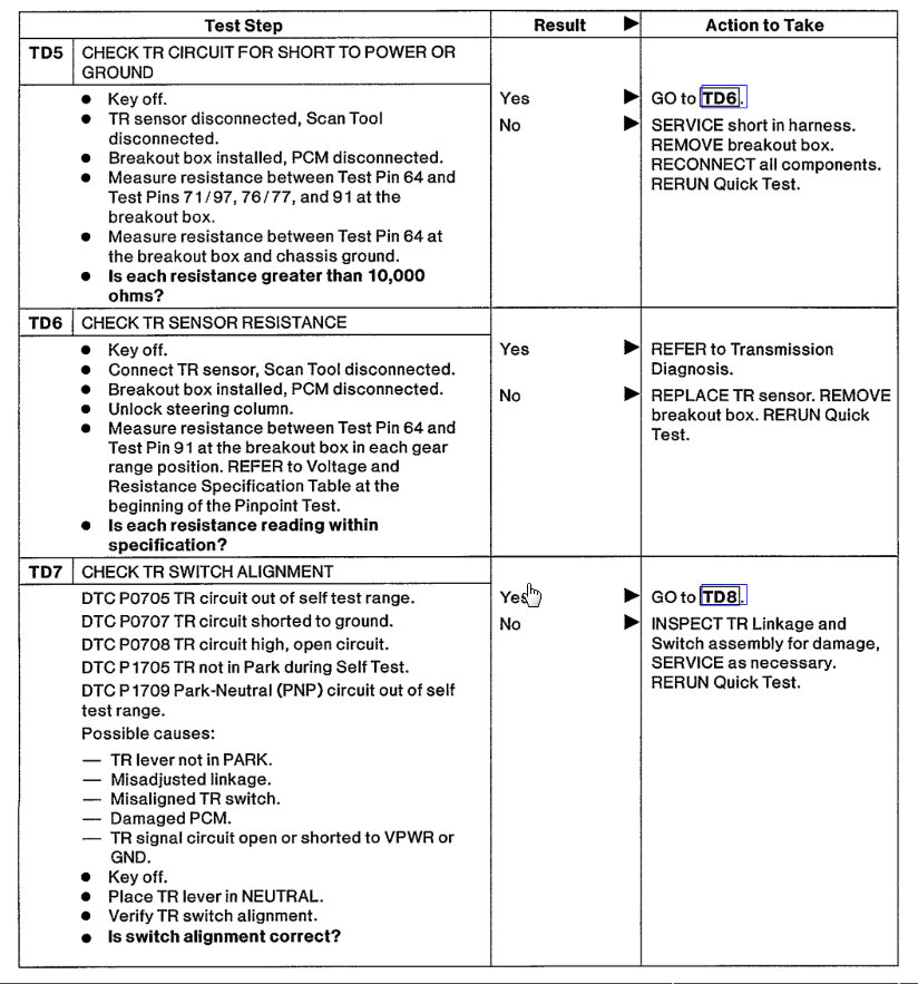

On the instructions it states if the tool fits to go to TD2 however there is no TD2 sheet.
May 3, 2020 at 2:08 PM

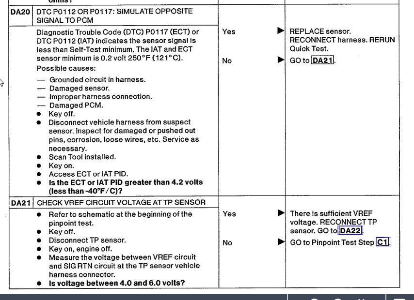

Sorry. Here are the couple of sheets needed. I thought I looked at that but clearly didn't provide it.
