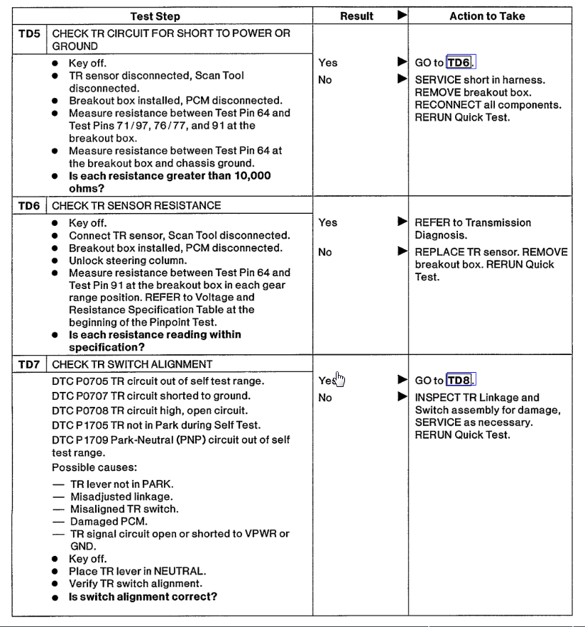

Car has low torque when I first press the accelerator wont even pass a speed bump without a little head start and the tachometer is also not working. I did notice the other day that the overdrive light went off and the tachometer started working again and the torque came back. This went on for a few minutes soon after the overdrive light started flashing again and lost torque again.

So I have checked the codes on the vehicle and they are as follows:
P0708
P1131
P0117
P0755
P1445
Also I have noticed the negative battery cable gets really hot in sure there is a ground issues also can that cause some of these codes?

P0708 - Transmission Range sensor is open

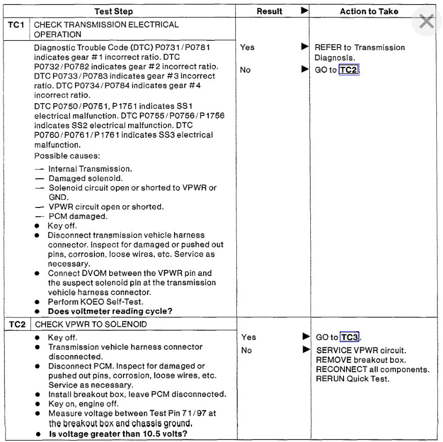

P0755 - Shift Solenoid Electrical malfunction

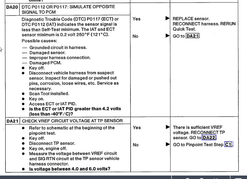

P0117 - Sensor signal voltage is low

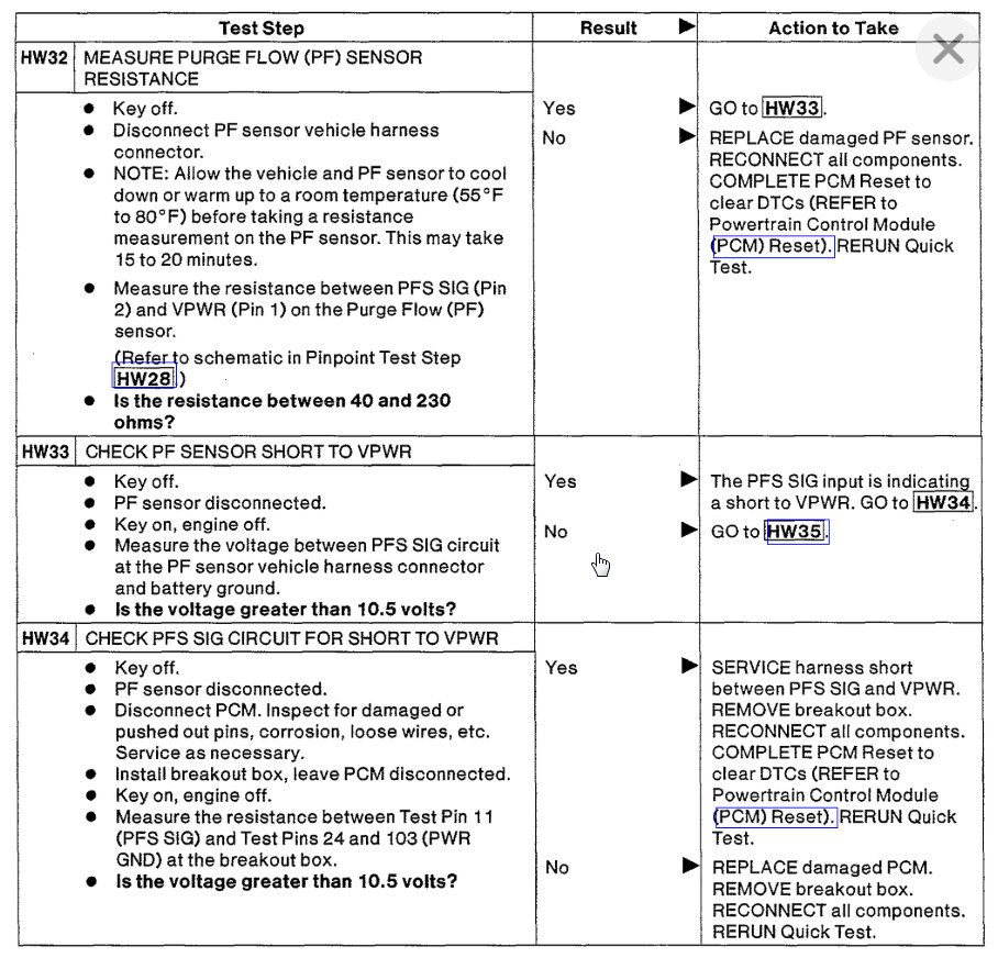

P1445 - Purge Flow sensor circuit issue
Based on these codes it appears you have a wiring issue with the transmission. I would start with running through these DTCs diag steps and see where it leads you then update me on what you find and we can go from there. Thanks

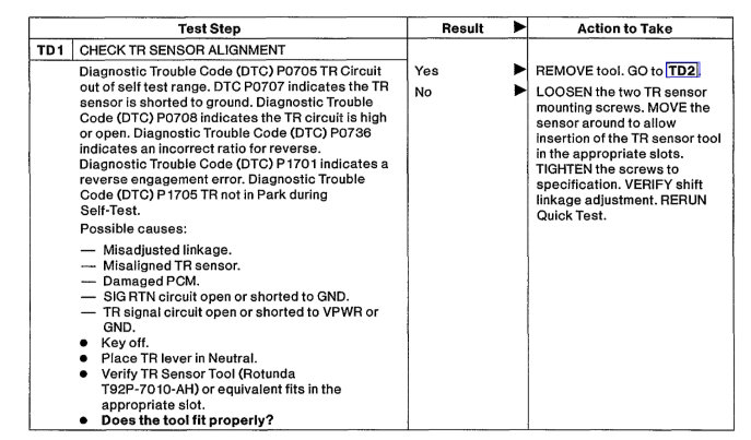

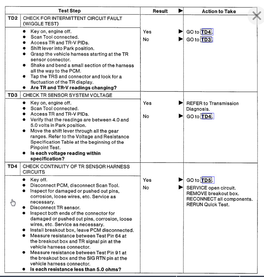

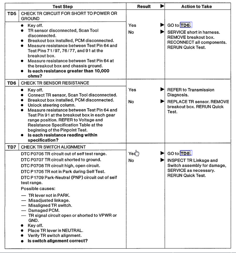

On the instructions it states if the tool fits to go to TD2 however there is no TD2 sheet.
Sunday, May 3rd, 2020 AT 9:08 PM
Sorry. Here are the couple of sheets needed. I thought I looked at that but clearly didn't provide it.
