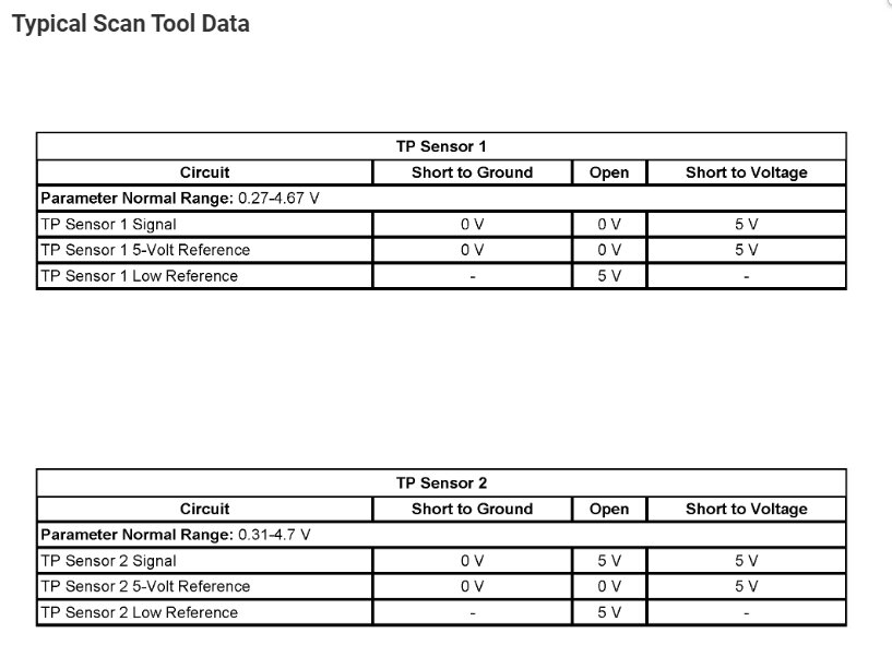

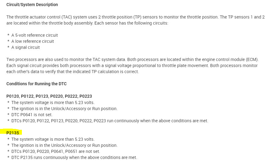

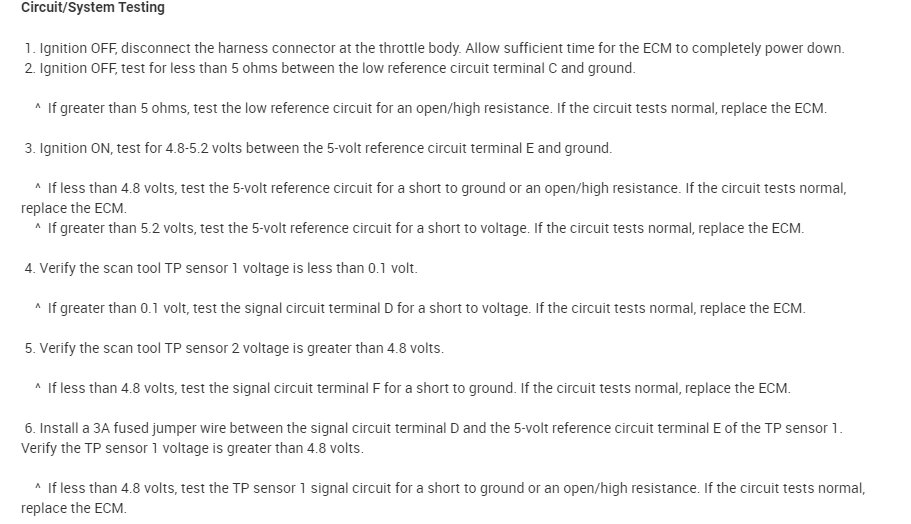

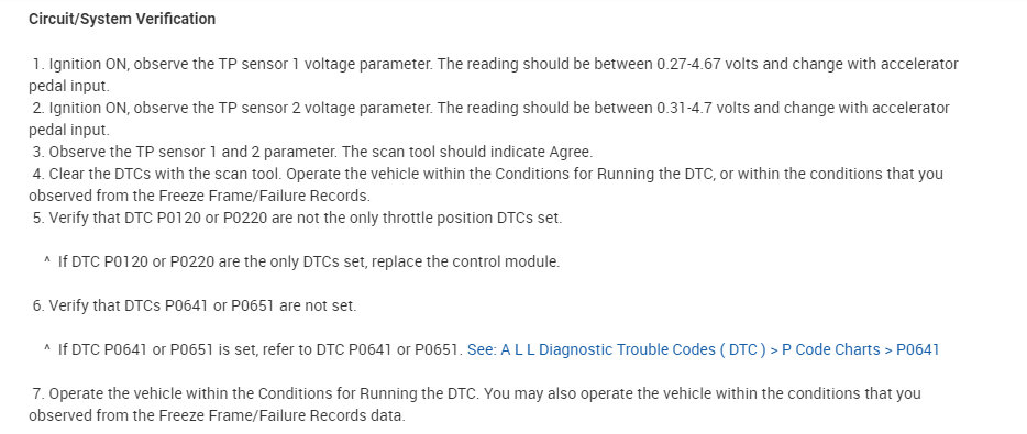

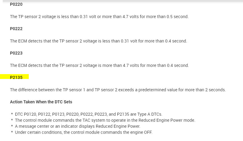

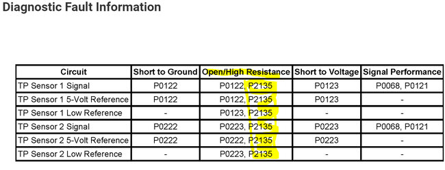

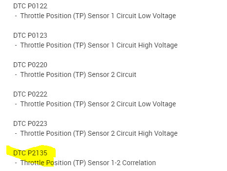

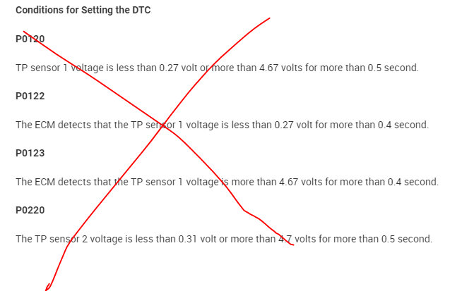

The codes are related to the throttle position actuators. When the P2135 is set, a message indicator should indicate, Reduced Engine Power.
Check the connectors at the throttle body. Make sure nothing is damaged or shorted, and make sure the connector pins are in good condition and not corroded.

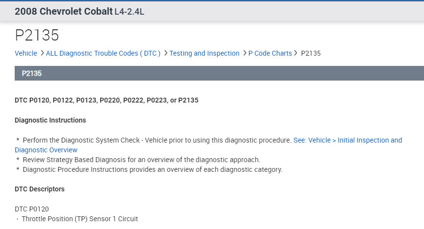

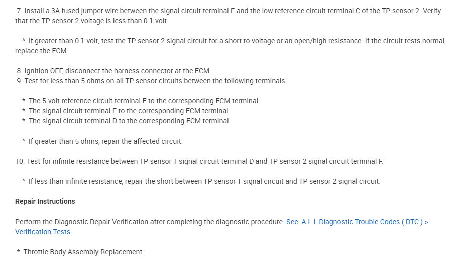

I attached the diagnostics below for the P2135. This is where I would start simply because it deals with an open circuit, and the other code shows a variation in voltages between throttle position sensors 1 and 2.
Take a look through the diagnostics (which also includes48
a description) and let me know if you are comfortable performing them.

Thanks for the assistance, Joe! Where would I find pinout info for the TP sensor connectors, so I know which one has the variable voltage? Also, are both TP sensors actually on the throttle body? Are they numbered somehow? Thanks!
Sep 1, 2023 at 2:24 AM
GOTTAKEEPMOVIN'
  • 42 POSTS
Problem solved, Joe! I found that the TPS connector is so close to the plastic cover that attaches between the air filter intake and the throttle body itself, that the green (?) wire was clearly damaged. Using some solder skills, I was able to install a jumper. Removed the throttle body and thoroughly cleaned as well. Put the car back together and it started right up. Cleared codes (and they all cleared), and away we go. Thanks so much, Joe, for your time and effort here! Kevin
