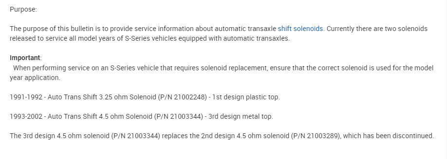

I did a flush. no burnt smell, but it seemed to help at first there was no metal or anything in the fluid. I have read other post and they said to replace solenoids other said to replace shaft input nut. I don't know what shaft input nut does and i am thinking the TCC solenoid might be bad as it seems the engine is putting the power out but transmission is not matching. If i take foot off gas it will shift a lot better. Less banging.

Yeah. It could be a solenoid issue. However, the solenoid does not normally cause harsh shifting. The solenoid just moves the valves in the valve body back and forth. They will normally cause erratic shifting, no shifting, it will go to limp mode if your transmission has that. Also, there are normally codes and a check engine light to go along with it.
Harsh shifting is normally caused by high pressure, valvebody issue, or clutch issues if there is only portions of the operation effected. This is why when you have harsh shifting it is best to go through the transmission and replace what is needed.
You may be able to get by with a solenoid but again, if it were me, I would want to go though everything to make sure it is ok or it can turn into a prolonged issue.

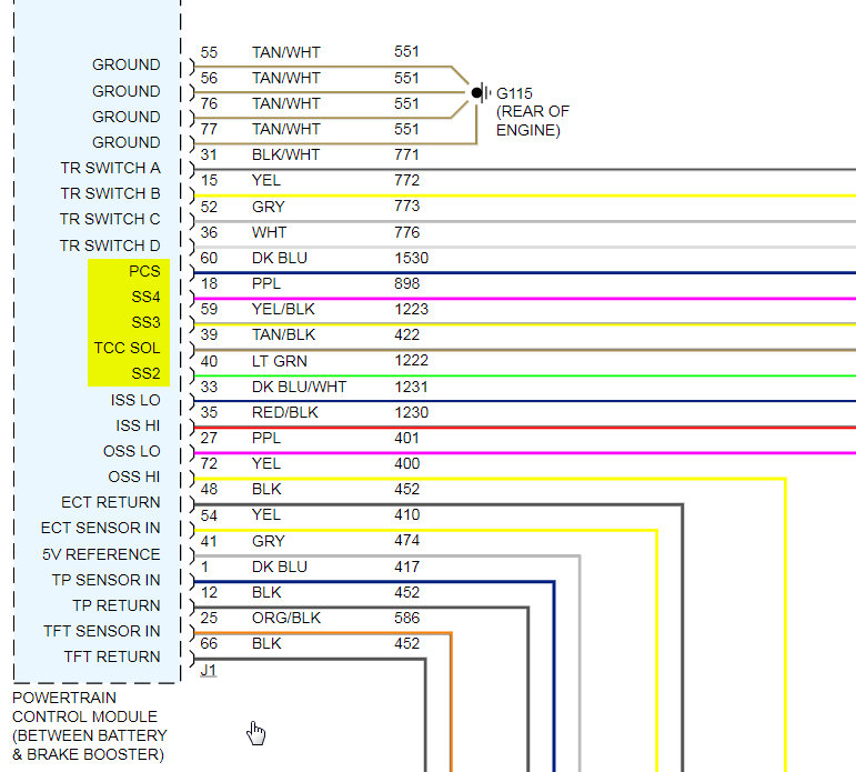

Just wondering could it be a bad ground connection?

Unlikely. You would more than likely have codes. Plus that would not cause a harsh engagement. It would cause a no shift condition. Lastly, the solenoids are grounded through the PCM as pictured so it is unlikely because there is not a specific ground for just the solenoid.

I am not finding one. Unfortunately I don't have step by step directions on these service manuals on the shift solenoid. Unfortunately you may have to just see if there is one when you remove the old one. Sorry I don't have more detail for you.
