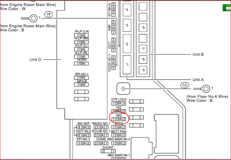

First, have you checked the fuses? It is located under hood on the left side. Here is a link showing how to test fuses:
I've attached a picture of the under hood fuse box and circled the fuse in red. Hope this helps and feel free to ask any questions if needed.Thanks for using 2CarPros.

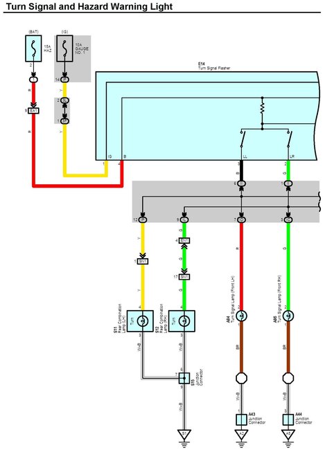

Flashers and hazards is the problem. Danny had me check fuse replaced still nothing.
Dec 25, 2018 at 11:56 AM
  • 110,244 POSTS

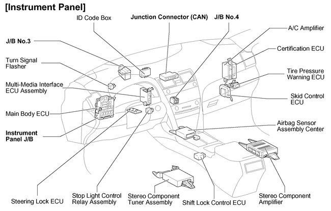

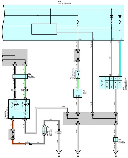

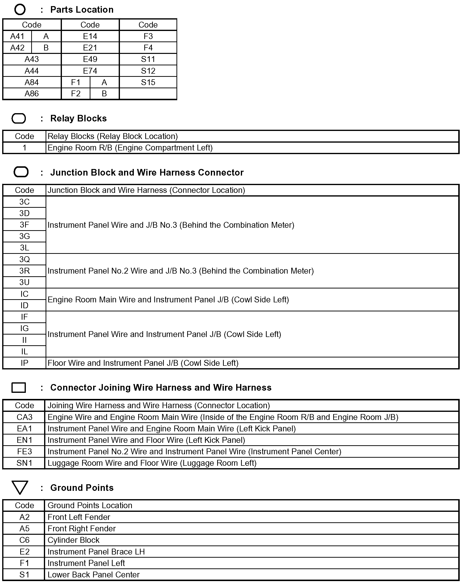

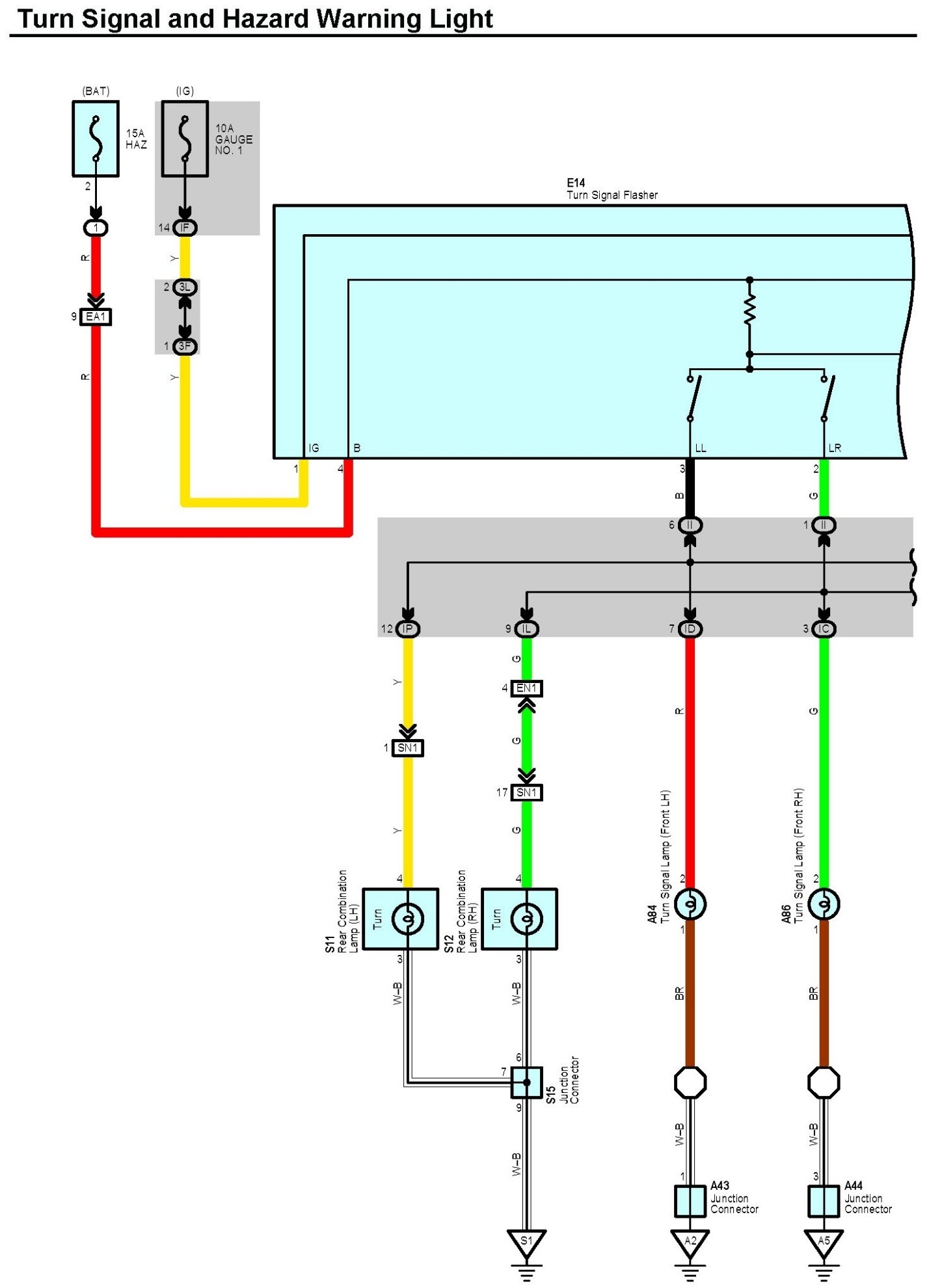

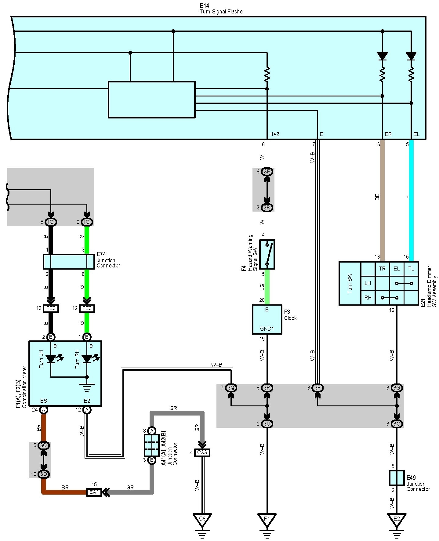

Okay, if the fuse is good and you have power to the fuse, the next thing that needs check is if there is power to the flasher. Take a look at the schematic I attached. It indicates wiring color. You need to make sure power is getting to the flasher and then out of the flasher. Basically, power comes from the fuse, through the flasher, and then to the switch which distributes its destination. The three pictures I attached show the flow of power through these components. The third picture is a legend of ground locations and components.
To trace or check power, you simply will need a test light. Here is a link that shows how one is used. If you didn't check for power at the fuse, use the test light to check.
Dec 25, 2018 at 2:25 PM
NELSON MCCLURG
  • 6 POSTS

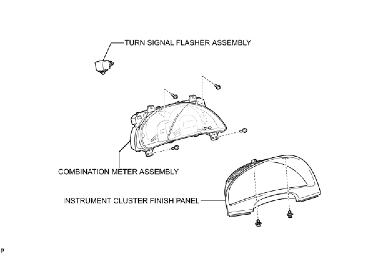

where is turn signal flasher?
I need to trace from fuse box to check power. found blue wire hanging.
Dec 26, 2018 at 5:44 AM
  • 110,244 POSTS

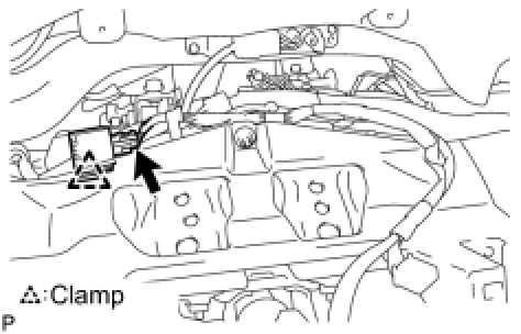

It is behind the instrument panel. I attached two pics.
Here are the directions for removal. Picture 3 correlates with these directions.
___________________
Removal
Lighting: turn signal flasher assembly: removal
1. Remove front door scuff plate left hand see: headliner > removal and replacement > removal
2. Remove cowl side trim sub-assembly left hand see: headliner > removal and replacement > removal
3. Remove lower instrument panel finish panel left hand (for TMC made) see: dashboard / instrument panel > removal and replacement > removal
4. Remove lower instrument panel finish panel left hand (for TMMK made) see: dashboard / instrument panel > removal and replacement > removal
5. Remove steering column cover (for TMC made) see: dashboard / instrument panel > removal and replacement > removal
6. Remove steering column cover (for TMMK made) see: dashboard / instrument panel > removal and replacement > removal
7. Remove no. 1 instrument panel sub-assembly (for TMC made) see: dashboard / instrument panel > removal and replacement > removal
8. Remove no. 1 instrument panel sub-assembly (for TMMK made) see: dashboard / instrument panel > removal and replacement > removal
9. Remove lower instrument panel finish panel (for TMC made) see: dashboard / instrument panel > removal and replacement > removal
10. Remove lower instrument panel finish panel (for TMMKmade) see: dashboard / instrument panel > removal and replacement > removal
11. Remove instrument cluster finish panel no.1 see: instrument cluster / carrier > removal and replacement > removal
12. Remove combination meter assembly see: instrument cluster / carrier > removal and replacement > removal
13. Remove turn signal flasher assembly
(a)Disconnect the connector.
See picture 3
(b)Remove the clamp and the turn signal flasher assembly.
