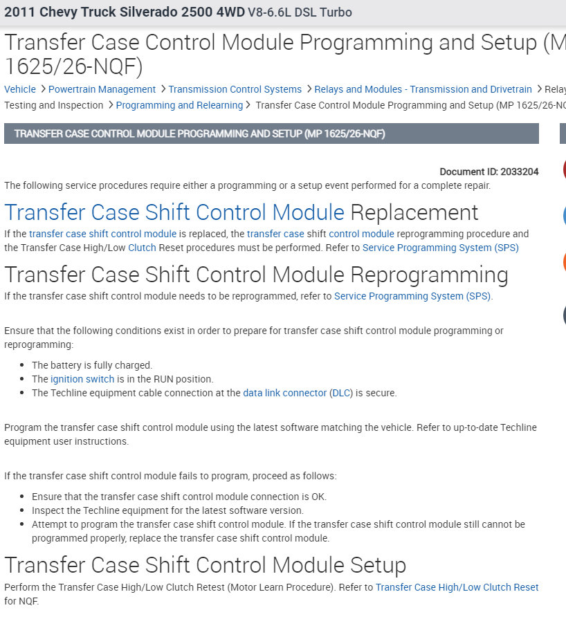

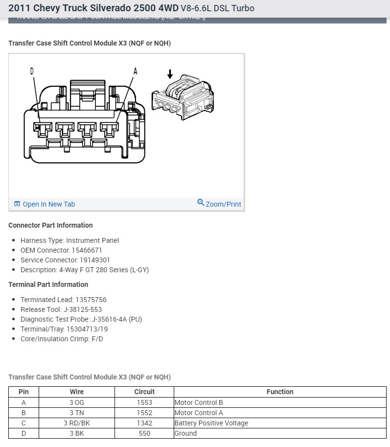

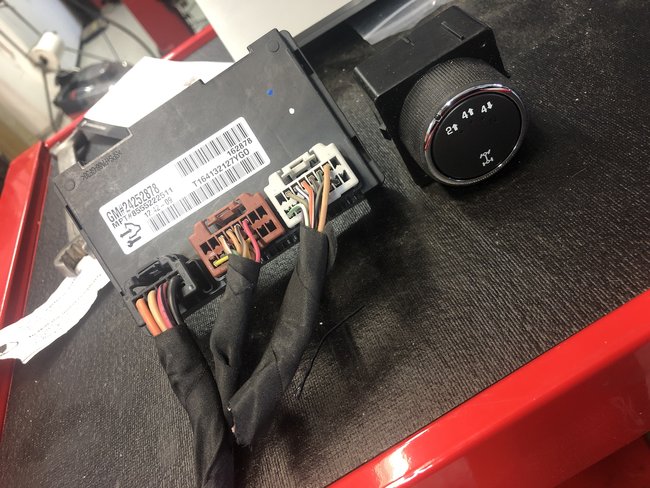

Need help with wire diagrams for Duramax LML 2011- MP1626XHD Transfer case to GM 24252878 module to dash switch. Anything would help be great.
Mar 24, 2022 at 8:07 PM
SQM
  • 6,383 POSTS

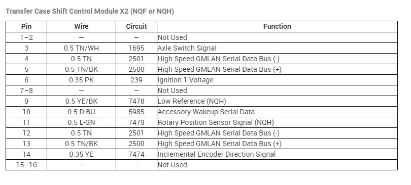

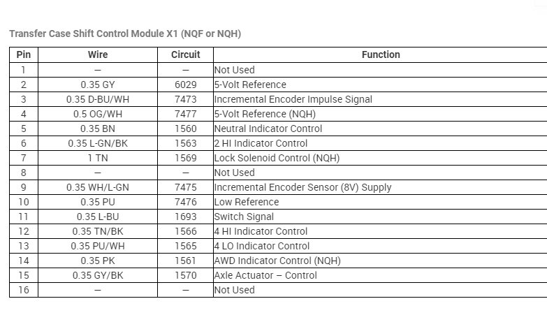

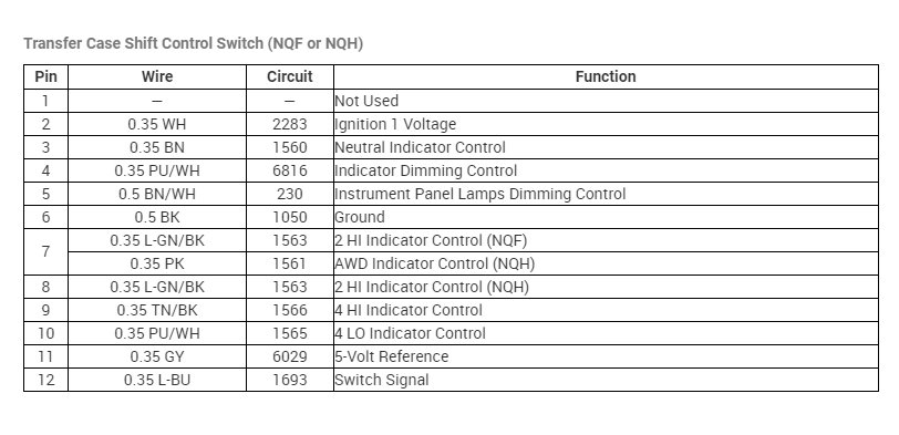

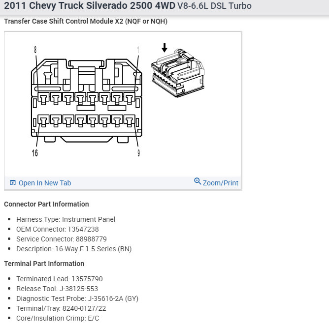

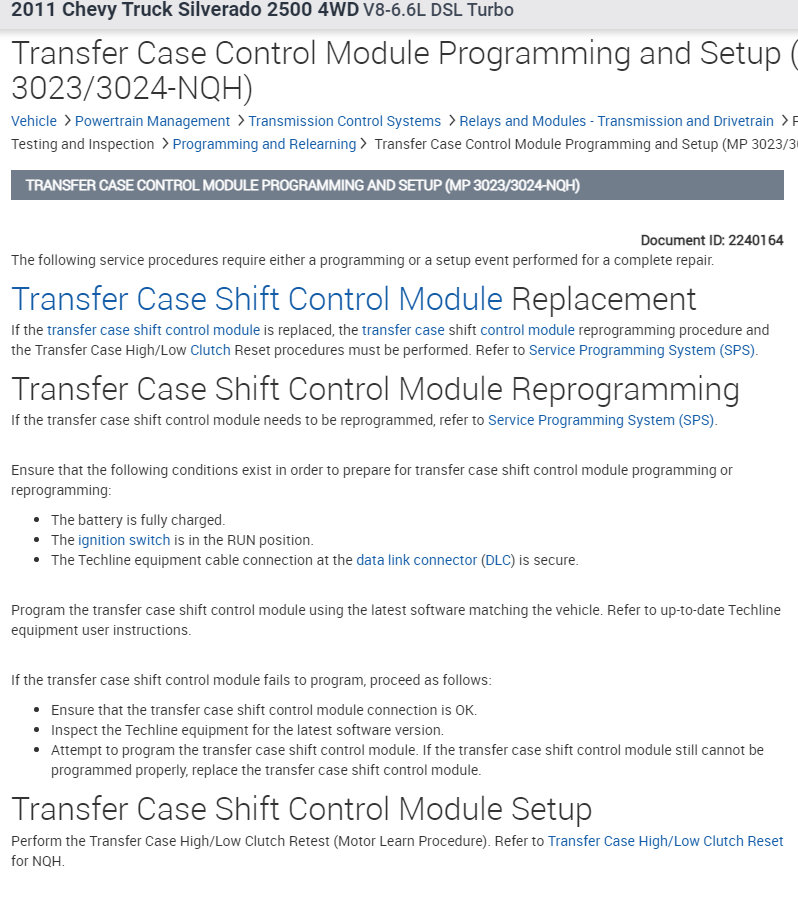

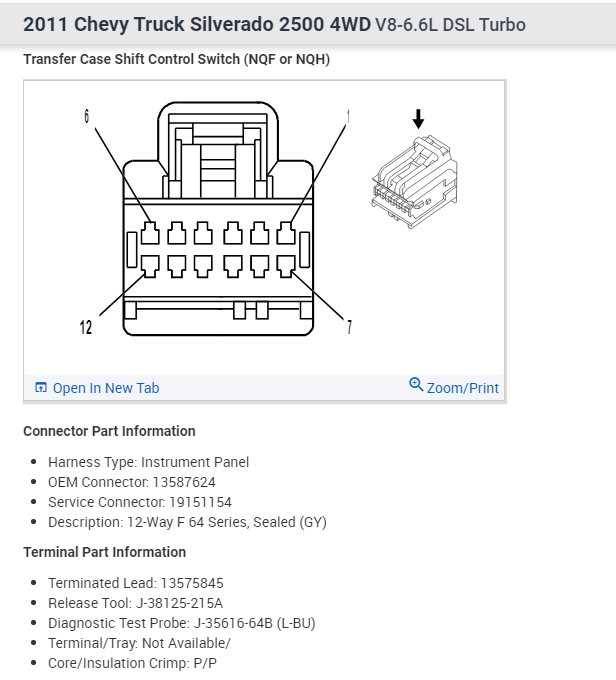

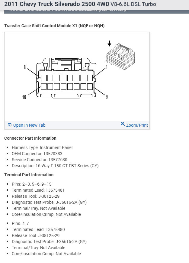

I have attached the pinout diagrams for the module and the switch below. It shows the color and location of each wire.
Keep in mind that the replacement module will need to be programmed to the vehicle.

Thanks, I’ll look into that. Do you know witch wake up signal it gets and from where?
Mar 29, 2026 at 7:47 PM
  • 55,421 POSTS
Wake up signal?
