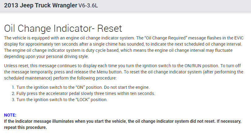

I changed the oil in my car but every time I turn it on the car it still beeps and says oil change required.

This vehicle requires the oil light reset after the oil change.
Unless reset, this message continues to display each time you turn the ignition switch to the on or run.
Here is how to reset the light:
Turn the ignition switch to the “On” position. Do not start the engine.
Fully press the accelerator pedal slowly three times within ten seconds.
Turn the ignition switch to the “Lock” position.
That should reset the oil change light.
https://www.youtube.com/c/2carpros/featured
Let me know of any questions.
