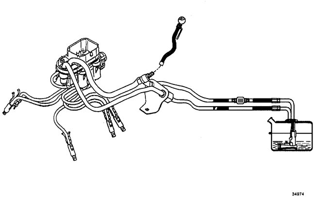

Also, there could be an issue with a fuel injector or fuel pressure. You can actually perform a fuel injector balance test. Here are the directions for it. It does require some specialized tooling.

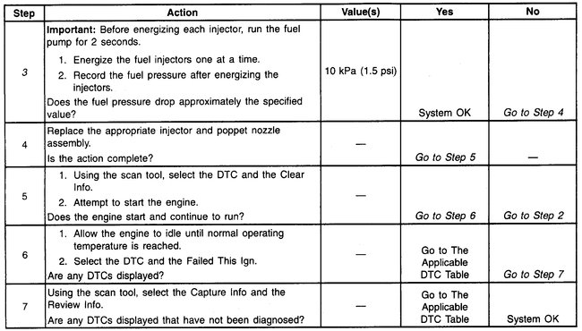

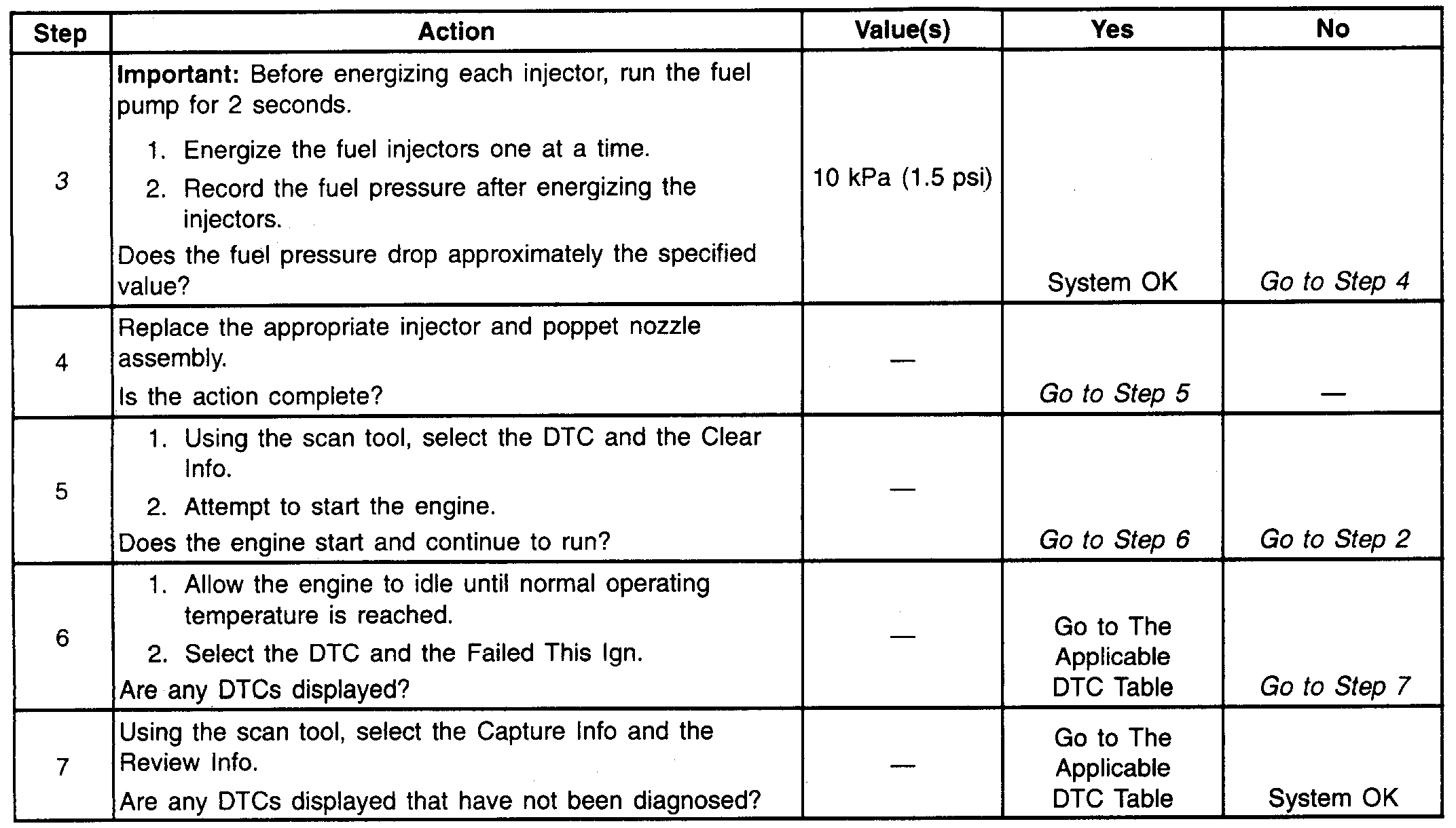

The Fuel injector Tester J 39021-301 and the injector switch box J 39021-210 energize the injector for a precise amount of time allowing a measured amount of fuel into the manifold. This causes a drop in fuel rail pressure that can be recorded and used to compare each injector. All injectors should have the same pressure drop 10 kPa (1.5 psi).
TEST DESCRIPTION
The numbers below refer to the step numbers on the diagnostic table.

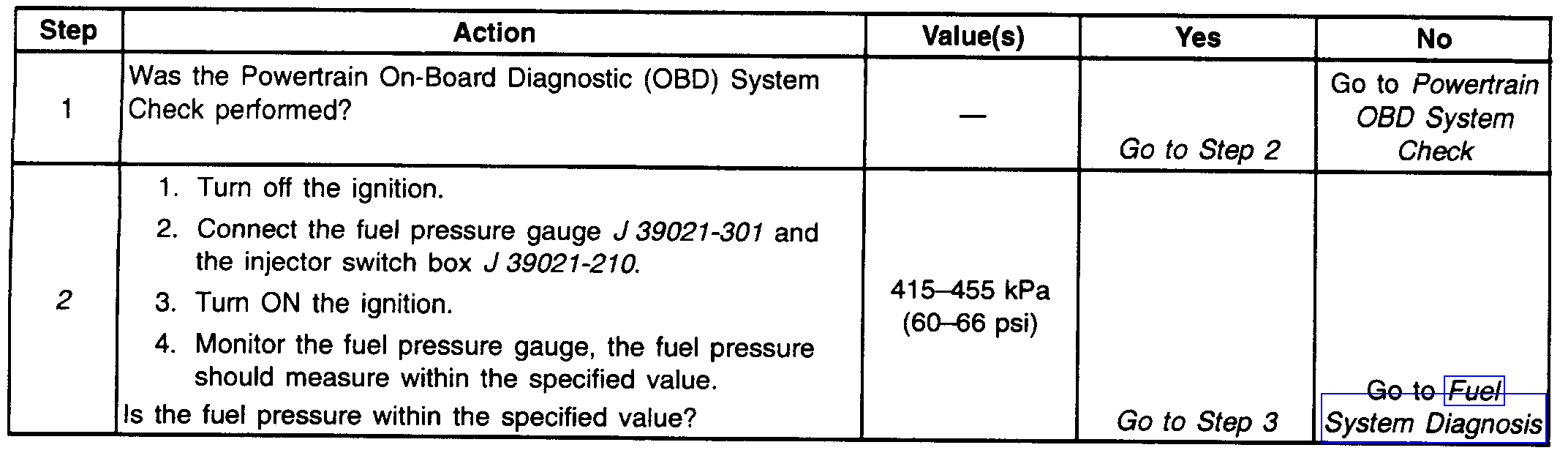

2. This step checks for the proper fuel pressure.
3. This step checks for a decrease in the fuel pressure after energizing each injector.
