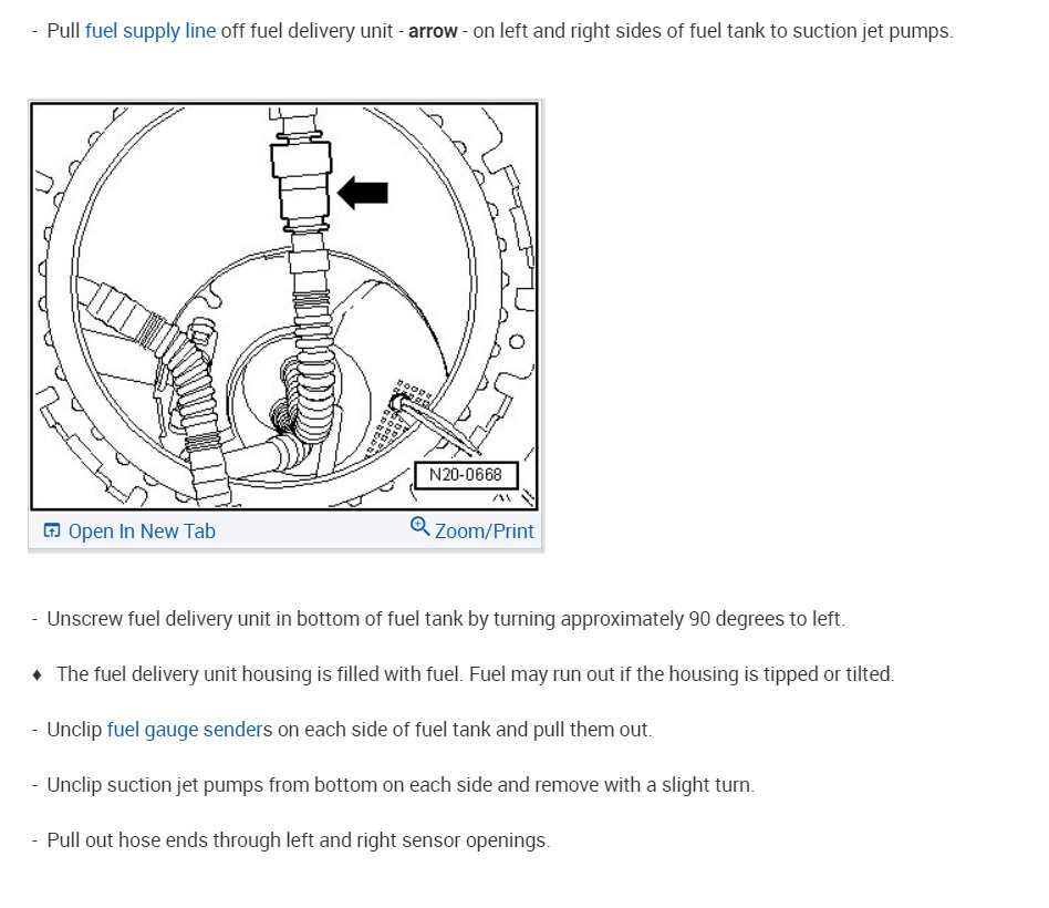

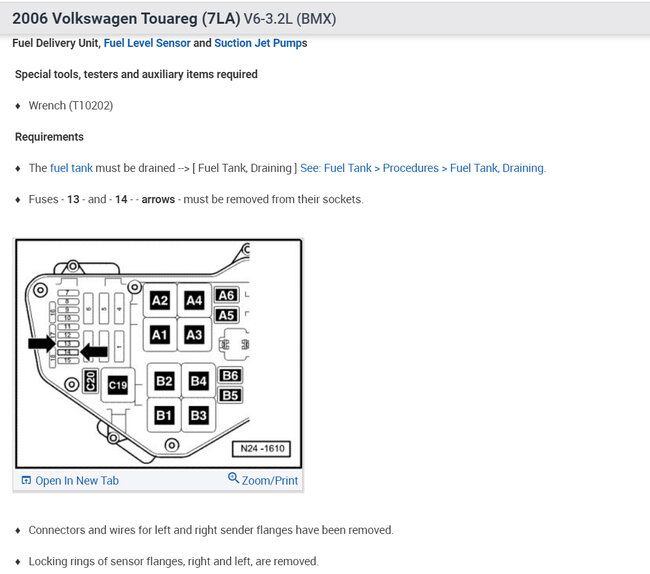

  • 55,399 POSTS
I would first replace the MAF sensor with a new unit and then check the fuel pressure because it sounds like the fuel pump is starting to go out. Also do you have any exhaust leaks?
This guide can help:
https://www.2carpros.com/articles/repair-lean-mixture-codes-p0171-or-p0174-on-some-manufacturers
The fuel pressure regulator maintains fuel pressure at a constant 4.0 bar.
Check for leaks and residual pressure. Observe pressure drop on pressure gauge. After 10 minutes there must be a residual pressure of at least 3.0 bar

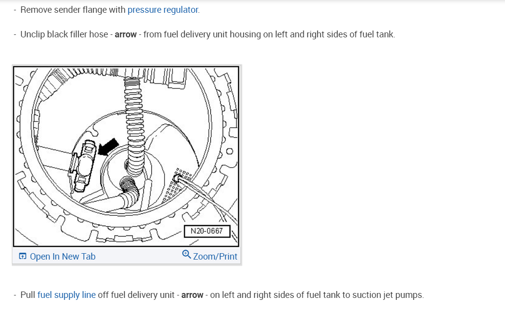

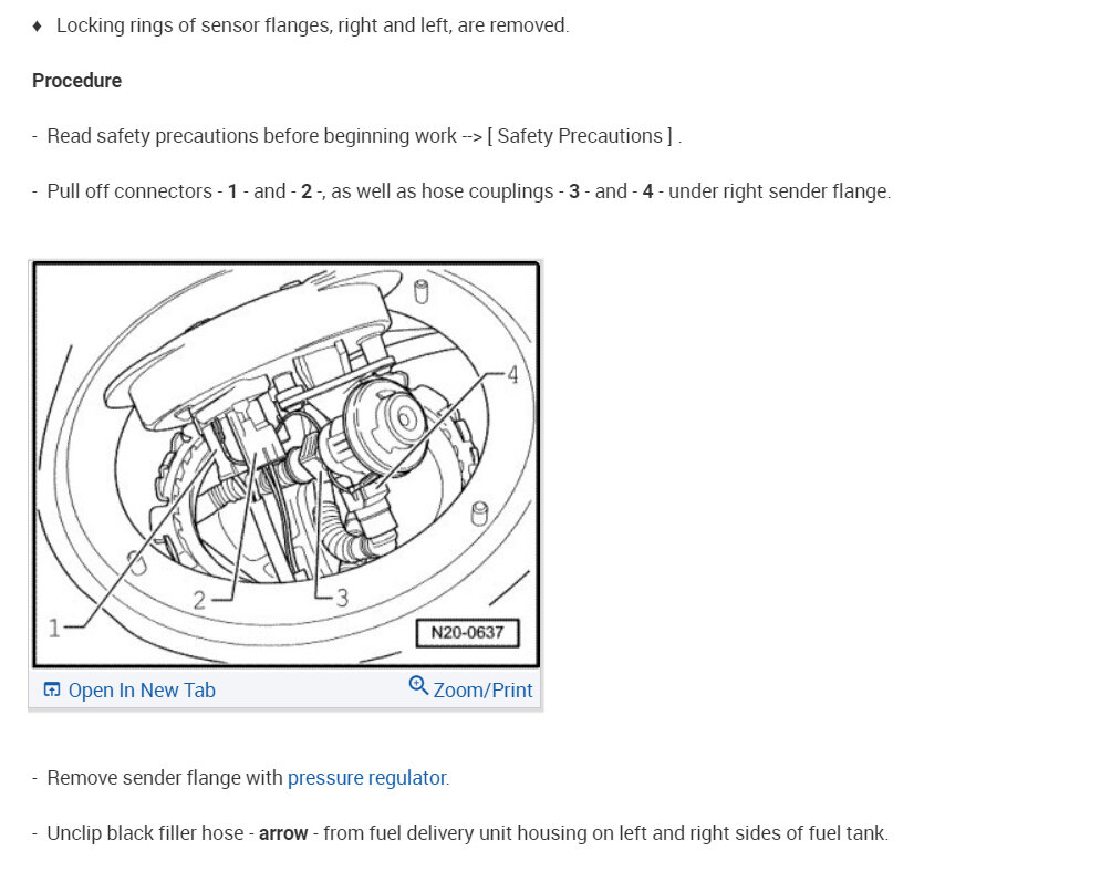

This guide can help test it and you can rent a fuel pressure gauge at the local auto parts store. Check out the images (below). Let us know what happens and please upload pictures or videos of the problem so we can see what's going on.

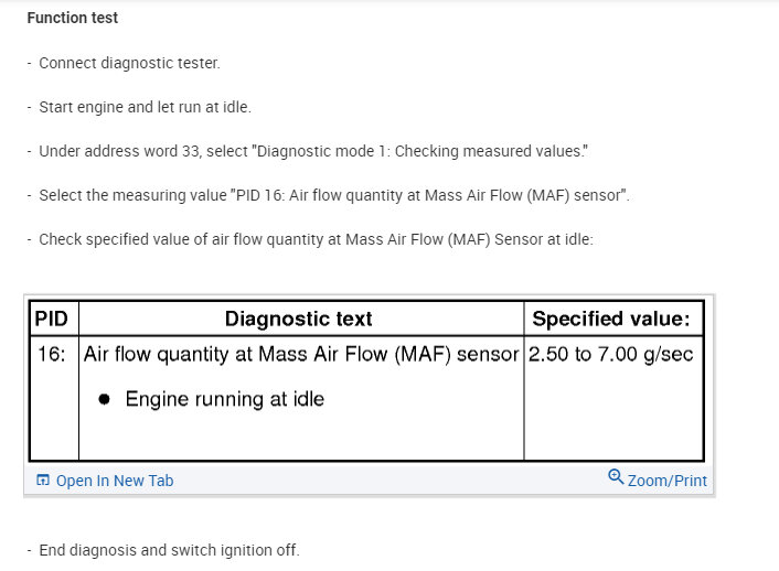

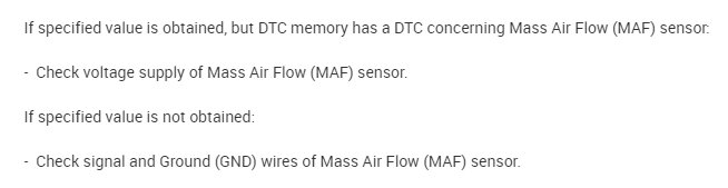

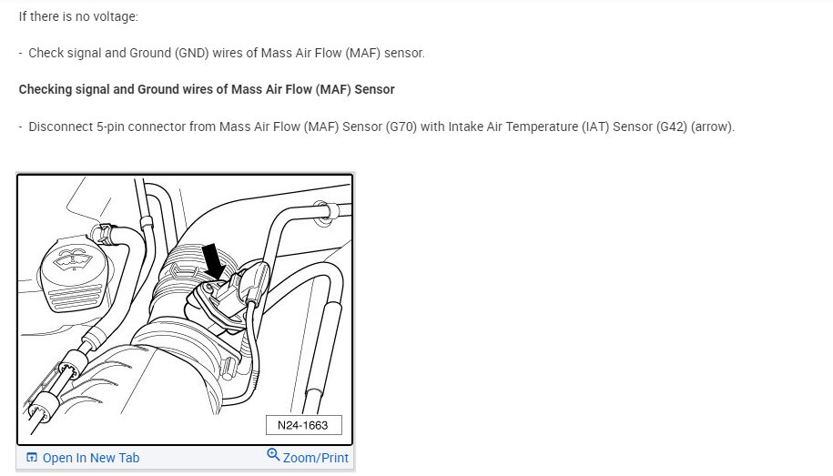

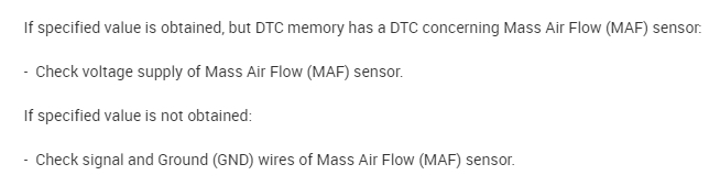

  • 110,241 POSTS

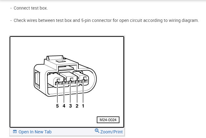

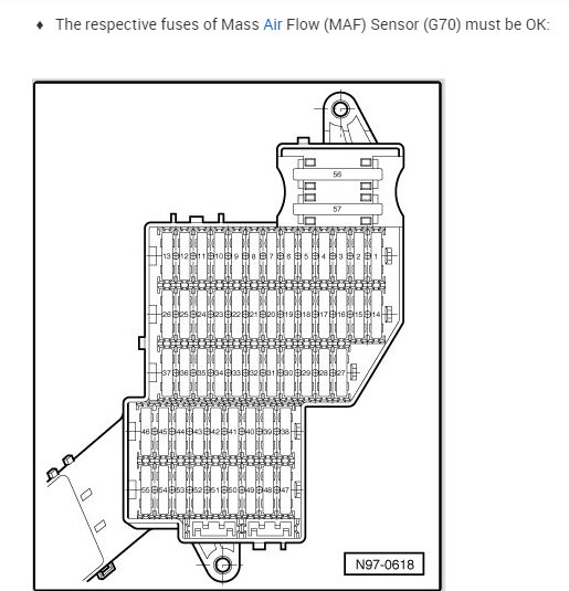

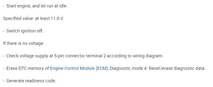

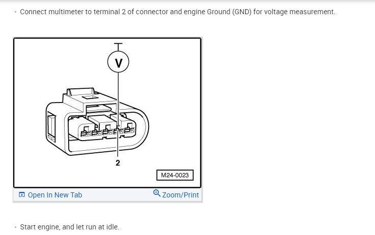

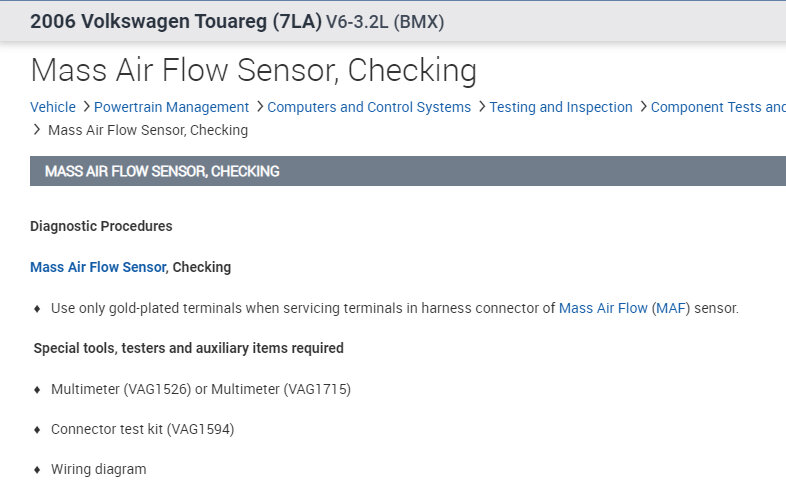

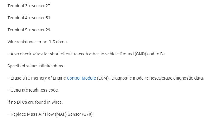

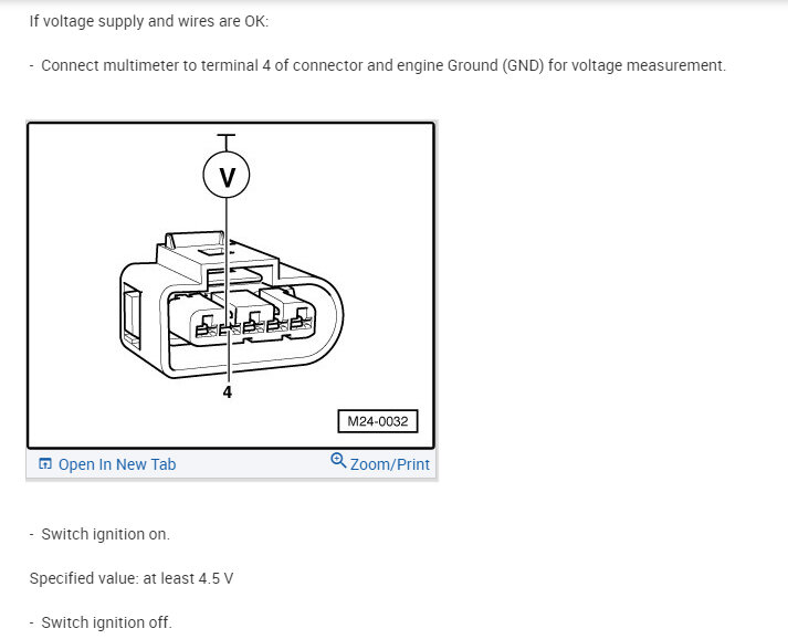

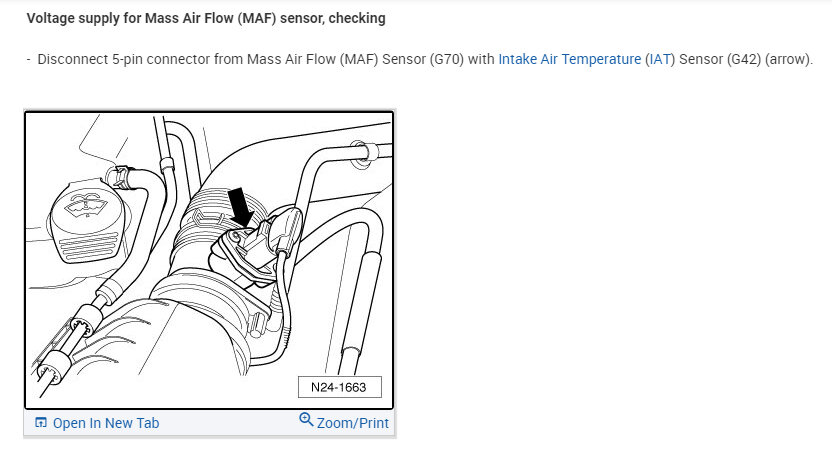

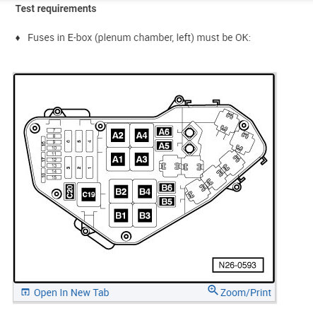

Since you are getting a P0101 code, the problem is either a vacuum leak or an issue with the MAF. Keep in mind, there could be a wiring issue related to the MAF as well.
I attached the diagnostics below specific to the code. Take a look through them and let me know if you are comfortable performing them.
May 13, 2023 at 3:26 PM

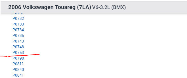

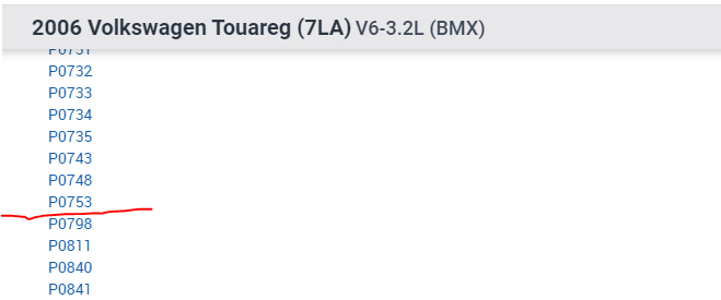

  • 110,241 POSTS

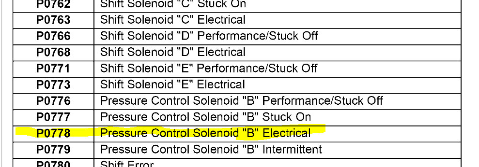

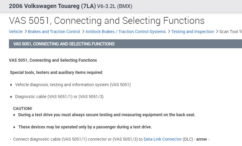

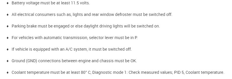

I'm not showing that code for this vehicle. See pic below. Could you have transposed a number?
See pic below.

HABIBPALLATH
  • 12 POSTS
Hi Jacob, it's P0778 code from VCDS Ross tech VAG scanner. this code may wont available in OBD2 code list. I have photo of this code took from my laptop on jpg format but can't upload it. The page says the filetype not allowed.

  • 110,241 POSTS
I tried to research the code, P0778 for VW. Everything indicates it is a pressure control solenoid in the transmission.
I also checked my manuals for a 2005 and a 2007 thinking there may have been a mid-year production change, and neither have that code.

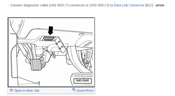

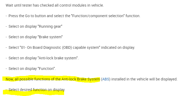

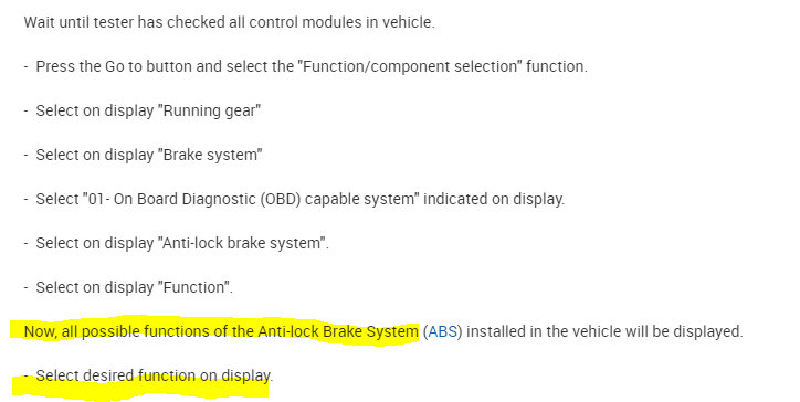

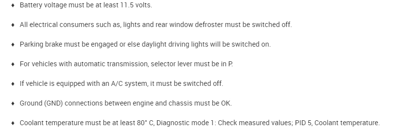

  • 110,241 POSTS
I did look at the page you provided. Is that specific to this year, make, and model vehicle? Also, that is indicating multiple variations to the code. However, I did note that each variation appears to indicate a basic setting issue.

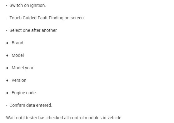

I went in a different direction in checking for your vehicle and found the code is related to the transmission. See pic below. That is listed as a code, but when I go to your specific vehicle, it's not present in two manuals.
I feel horrible because I can't figure out why this code isn't indicated. I attached the directions to access the basic settings. It is done through the ABS module. You may want to try this to see if it helps.
May 20, 2023 at 2:00 PM
