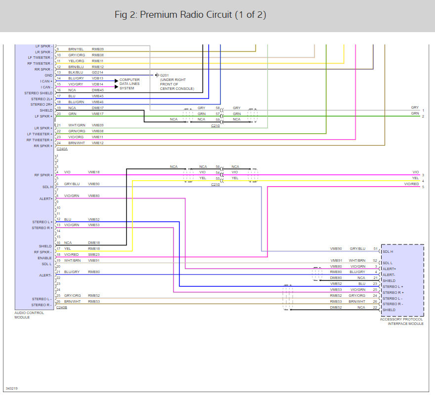

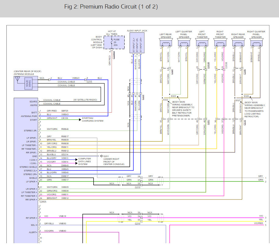

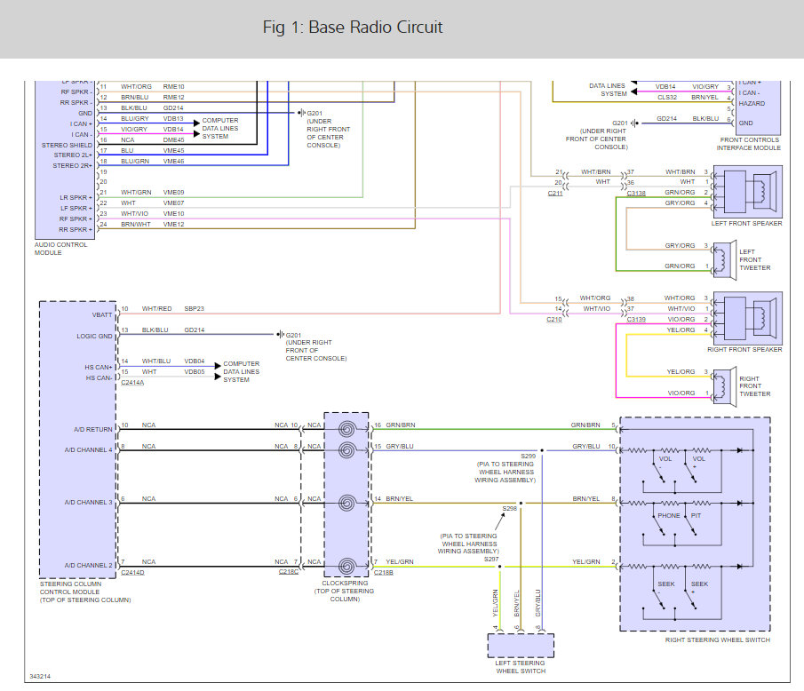

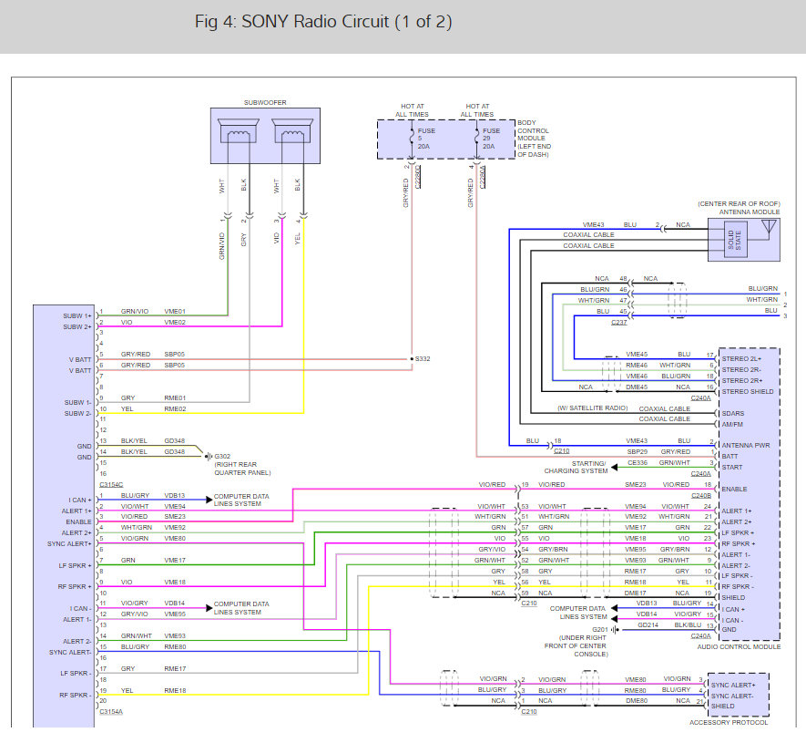

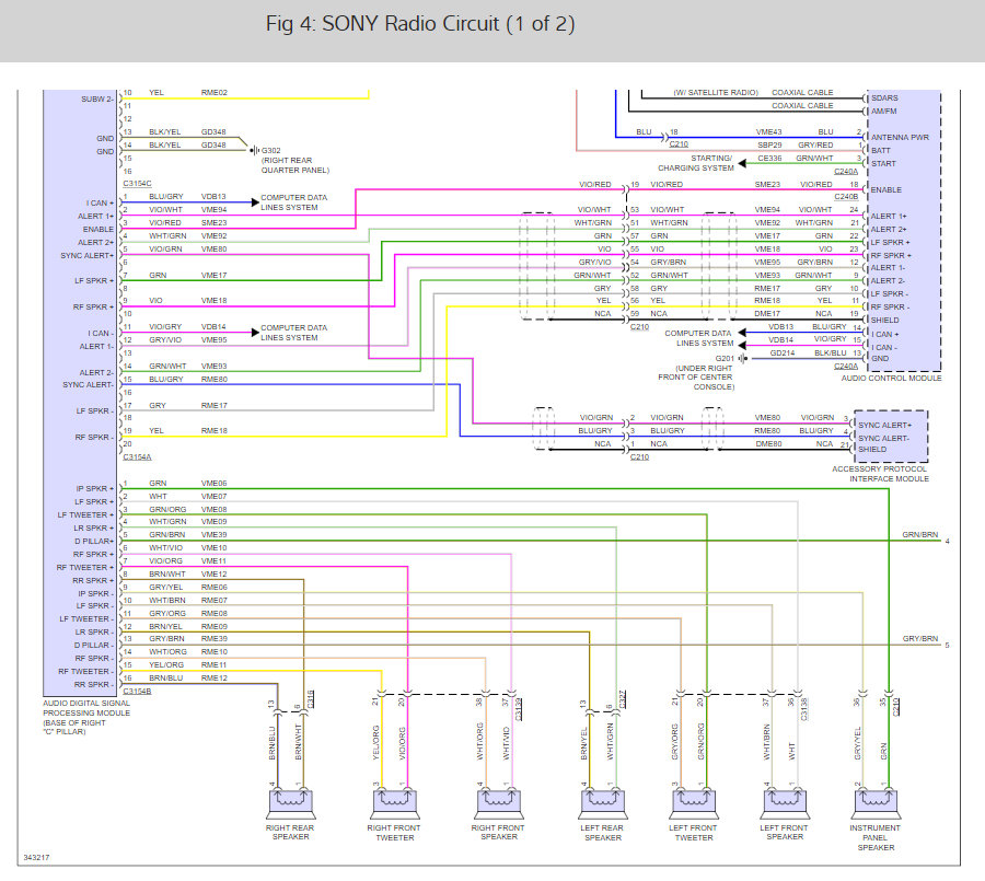

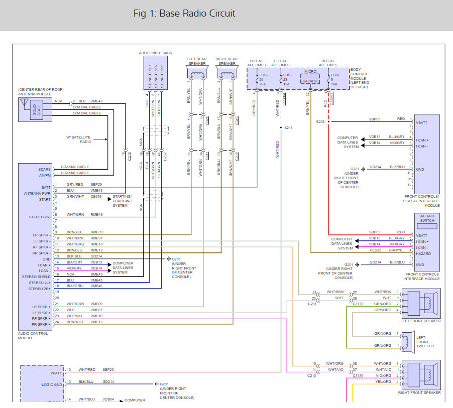

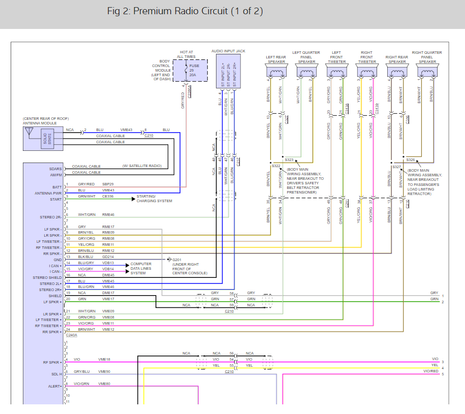

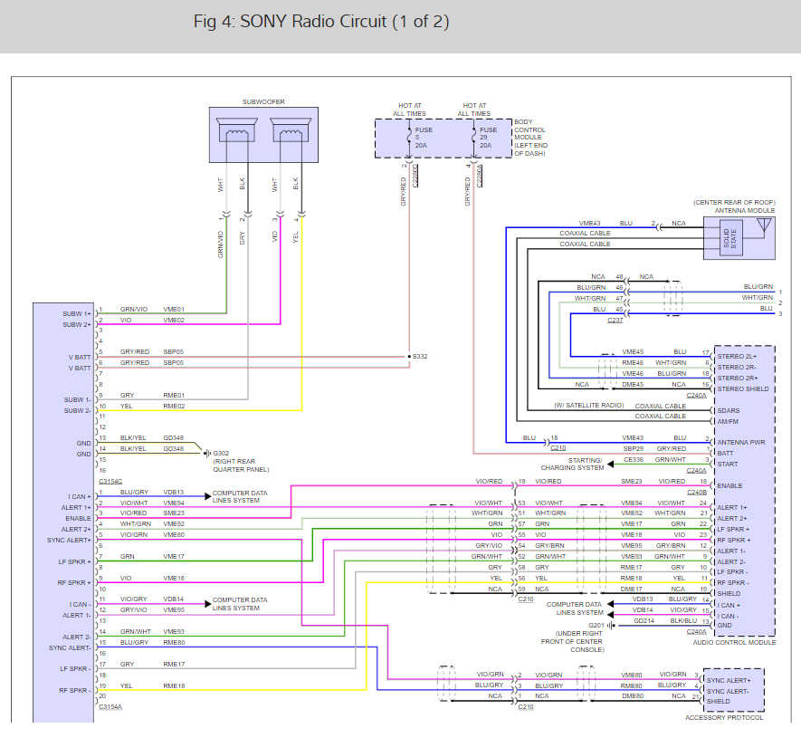

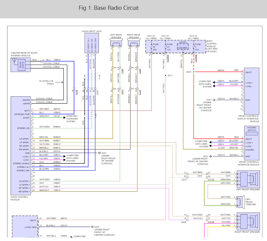

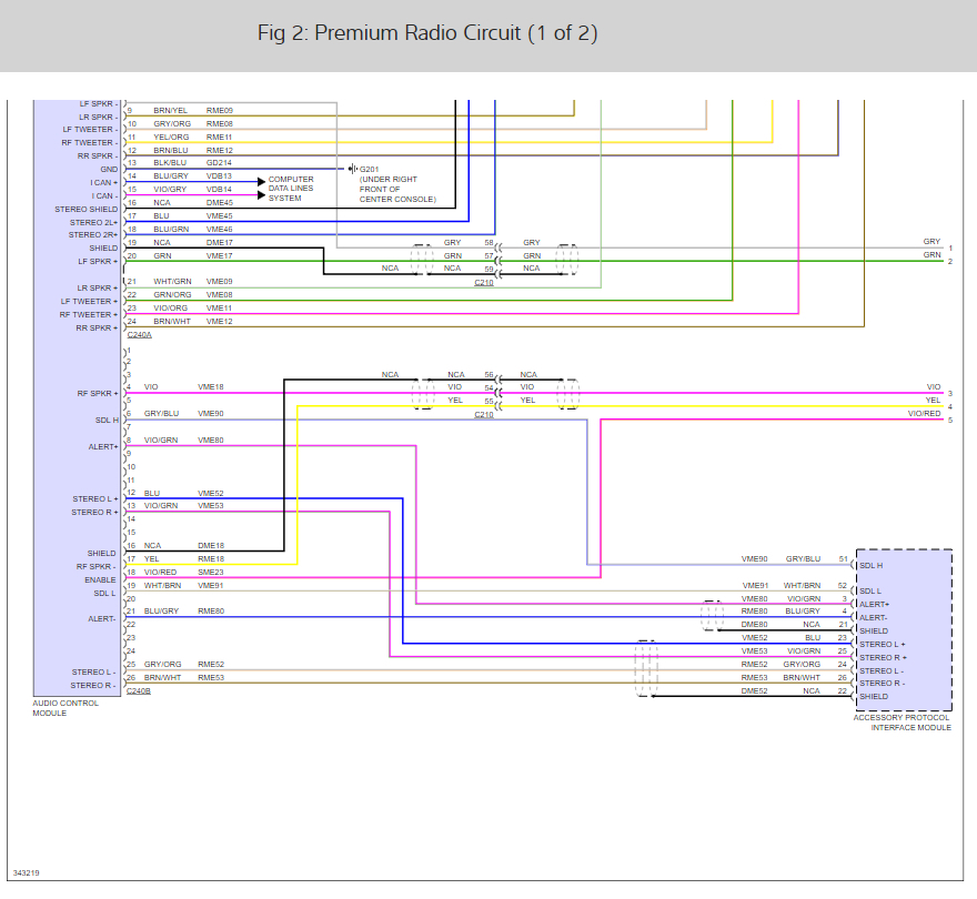

Temporarily lost communication with touch screen. I removed an aftermarket remote start system.
Jul 23, 2018 at 8:28 AM
  • 55,433 POSTS
It sounds like you have a connection problem lost the power or ground somewhere. Here is guide to help you test the wiring and the radio wiring diagrams below. I have listed all three radios that come in the car below.
Check out the diagrams (below). Please let us know what you find.
