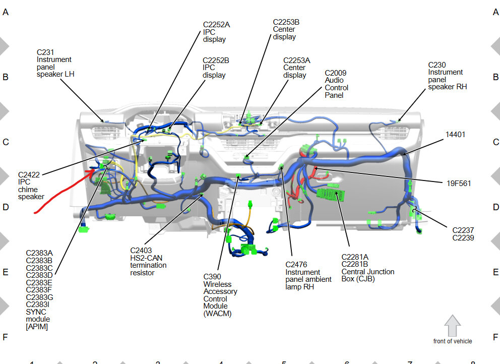

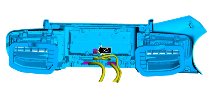

Need to removal the Sync system from a 2025 ford explorer. Heard it was behind the center stack. Looking for removal instructions.
Thanks
Aug 15, 2025 at 12:04 AM
  • 55,781 POSTS

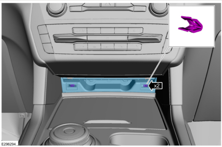

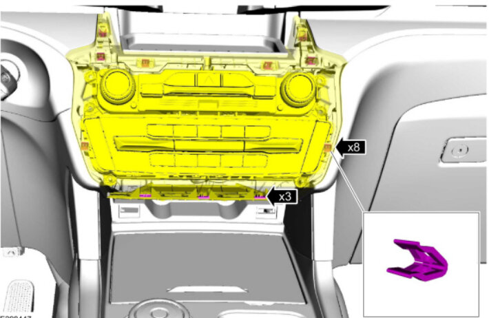

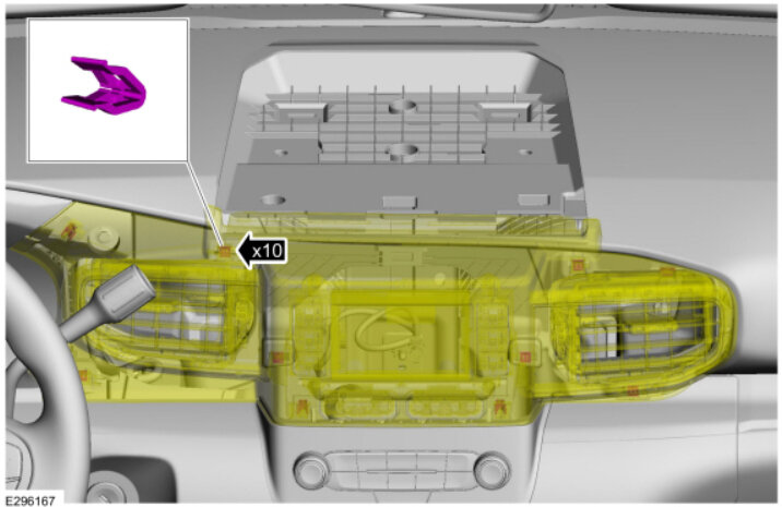

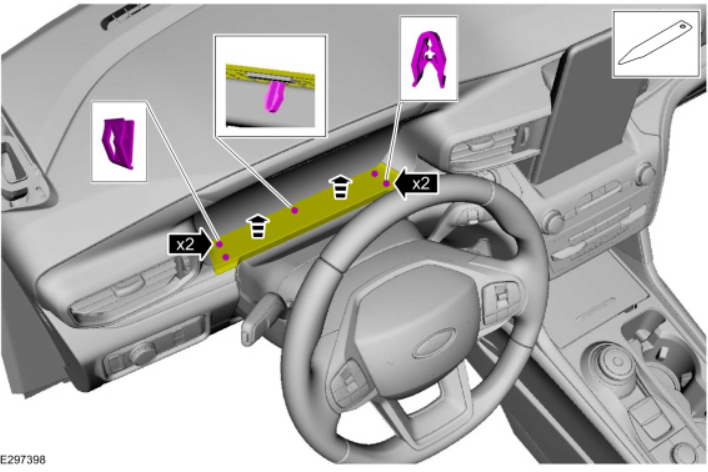

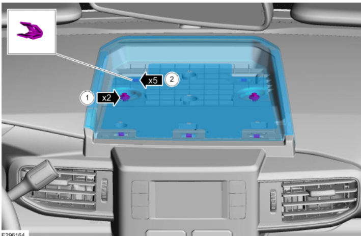

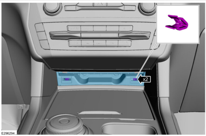

I am not suer what you mean by "sync" but here is how to remove the info screen. Check out the images (below). Please upload pictures or videos in your response so I can see wat you are talking about, also please respond to your older posts so we can close them out.

The (Sync 4 APIM module) thats located behind the the climate control

Sync 4 module

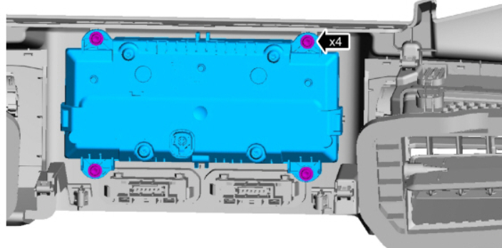

  • 55,781 POSTS
Gotcha, the APIM sits directly behind the touchscreen and HVAC controls. Check out the images (below). Let us know if you need anything else.

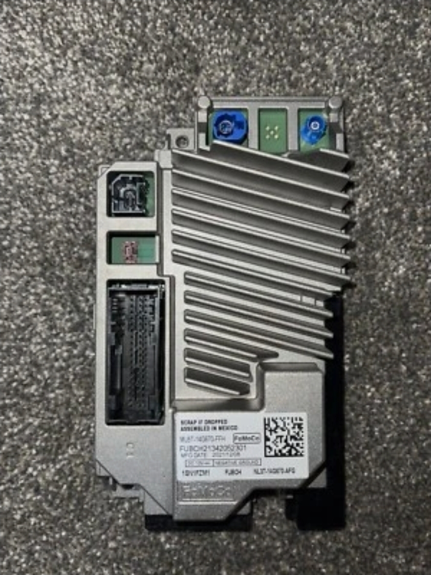

The brake down you sent me, is that for the 2025 model? I think one sent me a later model.. just make sure.
Aug 15, 2025 at 12:04 PM
  • 55,781 POSTS
Yep, it was for a 2024, I did more digging and found the SYNC module, it is at the left side of the dash, here is a diagram that shows its location. You dont need to remove the screen. Check out the images (below). Let us know if you need anything else.
