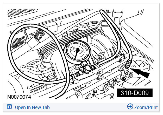

Loss of power while driving Slightly shaking while driving Sometimes won't turn over the first try but does eventually.No check engine light. Not throwing any codes.

This sounds like a classic weak fuel pump issue, here is a guide to help you check the pressure:
Here is the pressure it should be and further instructions.
Engine running fuel pressure .................... 450 kPa (65 psi)
