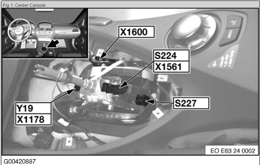

It is a 528i not 528E. I cannot find the neutral position switch.
Someone said it is on transmission.

According to "Prodemand"
Access is through the center console.
"Y19" is the park/ neutral position switch in their diagram.
