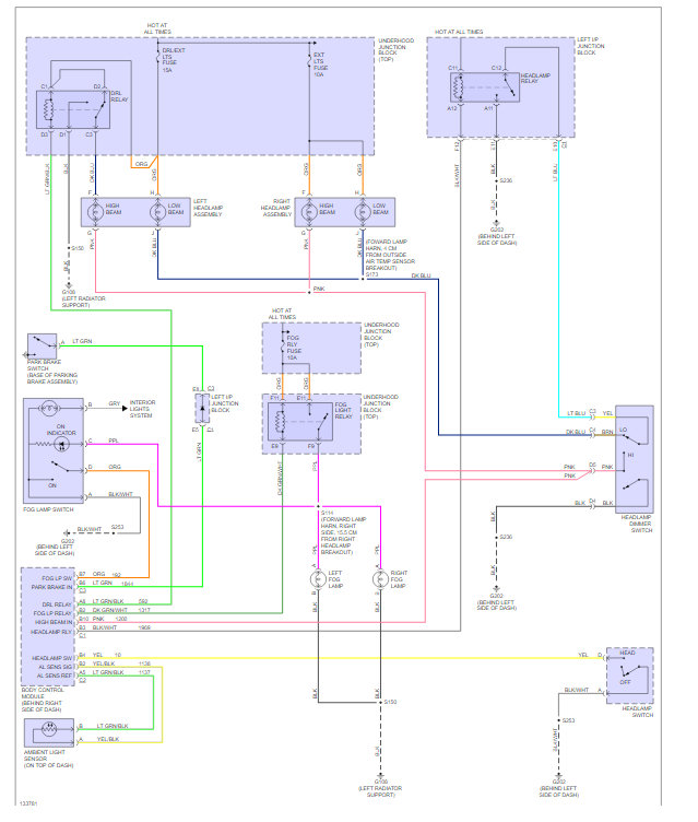

Lost all headlights last night. Smelled burning wires. I have dashboard, parking, fog lights and parking lights. When I pull on the turn signal/low high beam selector, the brights work. Am i looking at a relay issue or a headlight switch?
Feb 1, 2019 at 4:13 AM
SCGRANTURISMO
  • 4,897 POSTS
Hi uspatriot1963, my name is Alex and I will be helping you. It looks to me like you might have a problem in your headlight dimmer switch. I have included a headlight wiring diagram also. Hope this helps, Alex.
