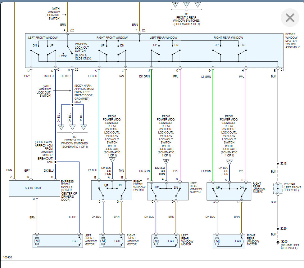

Need to see the wiring diagram for my driver side window switch.

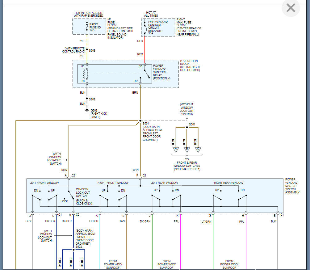

I am attaching the wiring diagram as requested.
Here is a guide that will help with testing these circuits:
Also, here are a couple guides that will help with testing and replacing the switch.
https://youtu.be/HBFBcJrdym4
https://www.2carpros.com/articles/electric-window-repair
Please see the wiring diagrams below. Let us know what questions you have.
