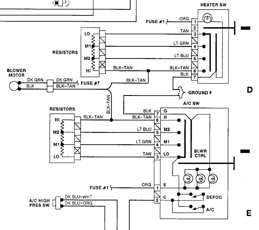

When I bought car It had toggle switch to work heater. The switch burnt up and I have to replace. Now I do not know where to hook wire on back of heater or how to get to the back of heater to see wires.

Make sure if you are not running the power from a fuse that you at least put an inline fuse in the wire to the toggle.
Here is the heater switch wiring diagram,
