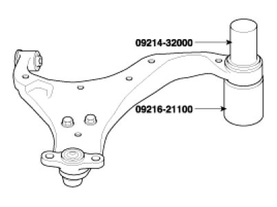

Here are the directions for replacing the control arm bushings. The attached pics correlate with the directions. Also, here is a link you may find helpful as well. It explains in general how the procedure is done:

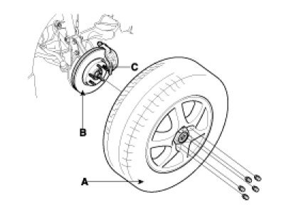

1. Loosen the wheel nuts slightly.
Raise the front of the vehicle, and make sure it is securely supported.
2. Remove the front wheel and tire(A) from front hub(B).
pic 1
CAUTION:
Be careful not to damage the hub bolts(C) then remove the front wheel and tire(A).

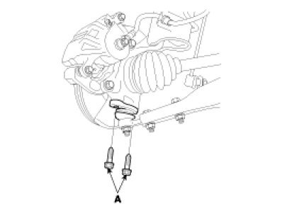

3. Remove the lower arm ball joint mounting bolts(A).
pic 2

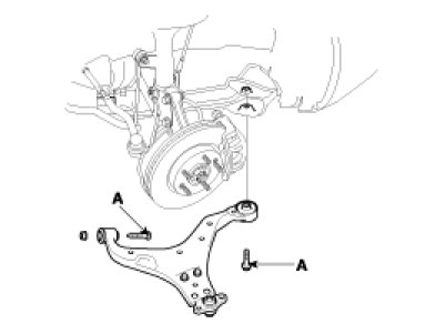

4. Remove the lower arm mounting bolts(A).
pic 3

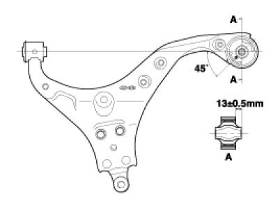

REPLACEMENT

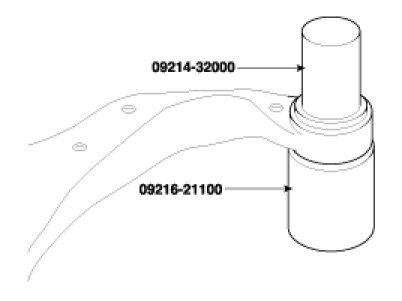

1. Using the special tools(09214-32000 & 09216-211000), remove the bushing from the lower arm.
pic 4
2. Apply soap solution to the following parts.
A. Outer surface of the bushing.
B. Inner surface of the lower bushing mounting part.

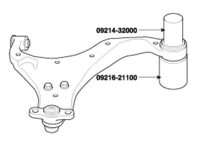

3. Using the special tools(09214-32000 & 09216-21100), install the busing on the lower arm.
pic 5
CAUTION:
Insert bushing in the direction as shown in the illustration.
Separation force is over 8000 N (800 Kgf, 1763 lbf)
pic 6
