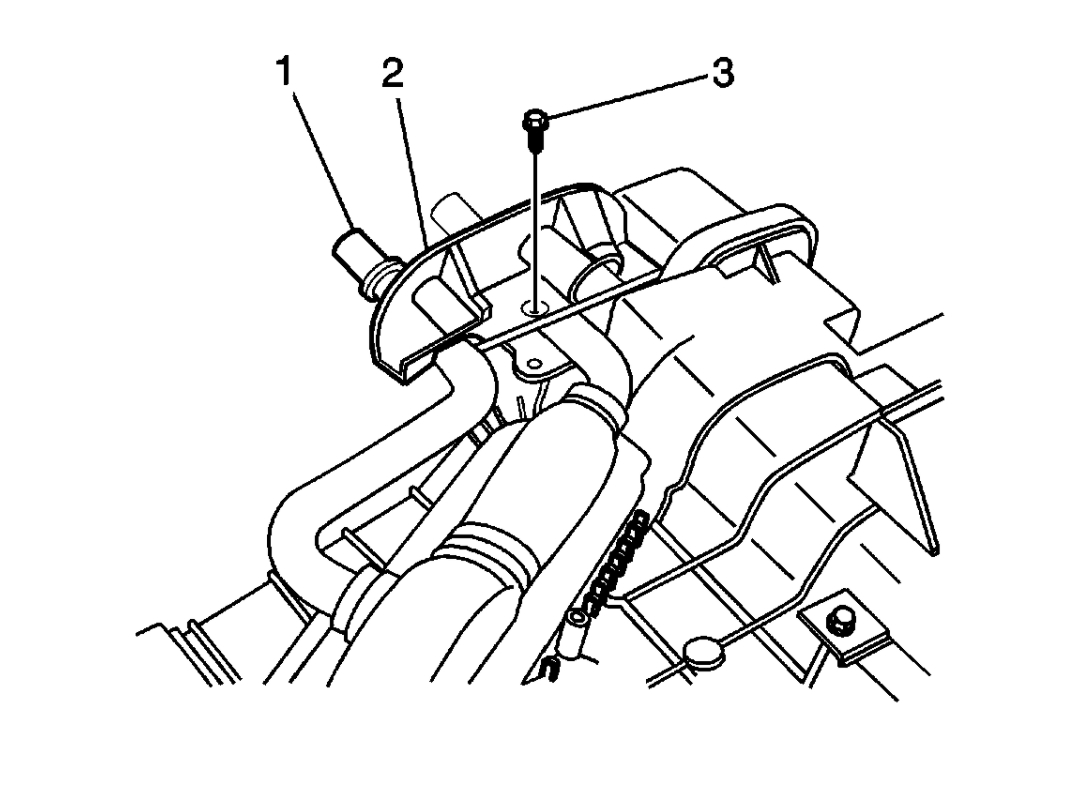

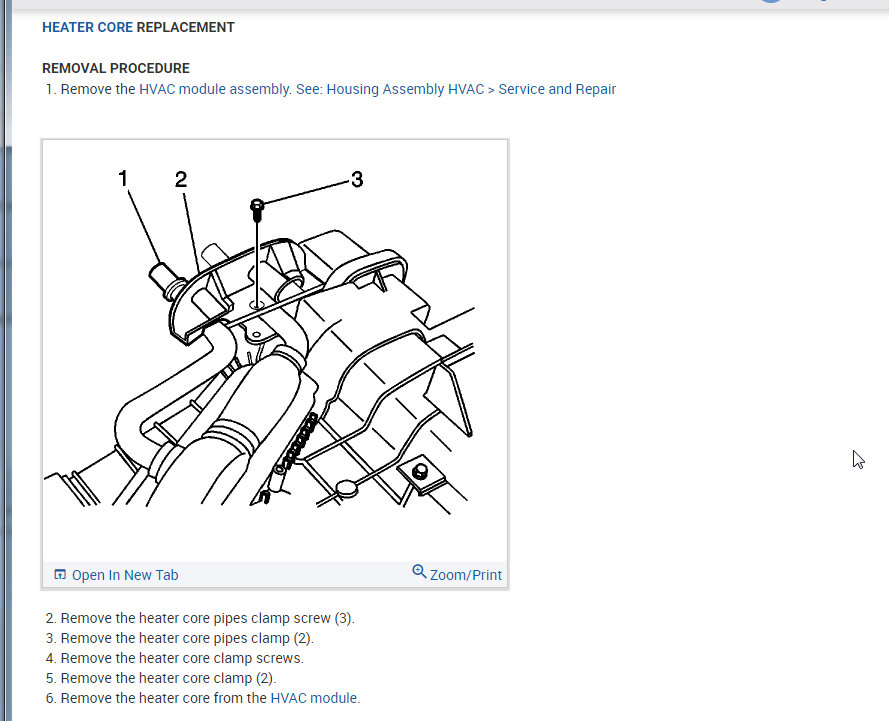

HEATER CORE REPLACEMENT
REMOVAL PROCEDURE
1. Remove the HVAC module assembly. See: Housing Assembly HVAC > Service and Repair
2. Remove the heater core pipes clamp screw (3).
3. Remove the heater core pipes clamp (2).
4. Remove the heater core clamp screws.
5. Remove the heater core clamp (2).
6. Remove the heater core from the HVAC module.

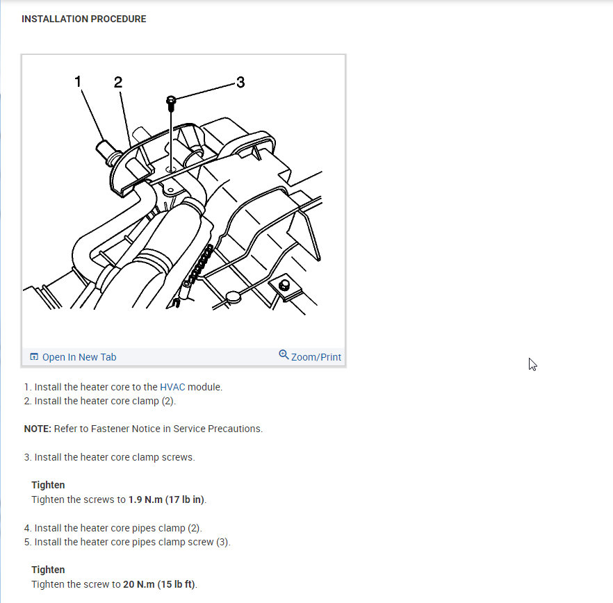

INSTALLATION PROCEDURE
1. Install the heater core to the HVAC module.
2. Install the heater core clamp (2).
NOTE: Refer to Fastener Notice in Service Precautions.
3. Install the heater core clamp screws.
Tighten
Tighten the screws to 1.9 N.m (17 lb in).
4. Install the heater core pipes clamp (2).
5. Install the heater core pipes clamp screw (3).
Tighten
Tighten the screw to 20 N.m (15 lb ft).
6. Install the HVAC module assembly.

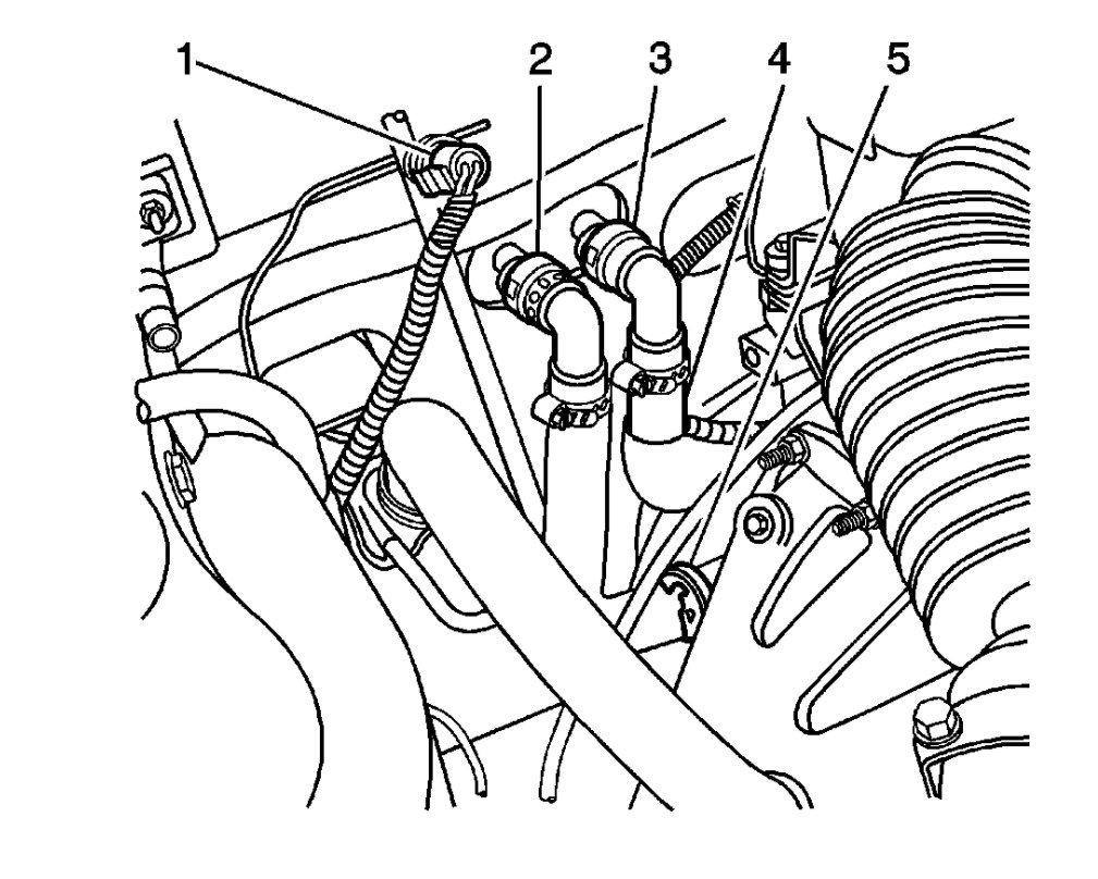

HVAC MODULE ASSEMBLY REPLACEMENT (W/ AIR CONDITIONING)
TOOLS REQUIRED
J 43181 Heater Line Quick Connect Release Tool
J 39400-A Halogen Leak Detector
REMOVAL PROCEDURE
1. Drain the engine coolant. Refer to Draining and Filling Cooling System in Cooling System.
2. Recover the refrigerant. Refer to Refrigerant Recovery and Recharging.
3. Remove the I/P carrier.
4. Release the heater hose clamps using J 43181.
5. Disconnect the heater hose quick connects (2) and (3) from the heater core.
6. Remove the retaining nut from the TXV stud.
7. Remove the evaporator tube and suction hose from the TXV.
8. Disconnect all of the electrical connectors to the HVAC module assembly.
9. Remove the HVAC module retaining nuts from the cowl.
10. Remove the HVAC module assembly.

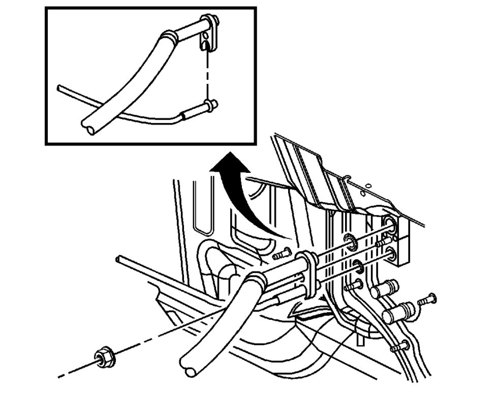

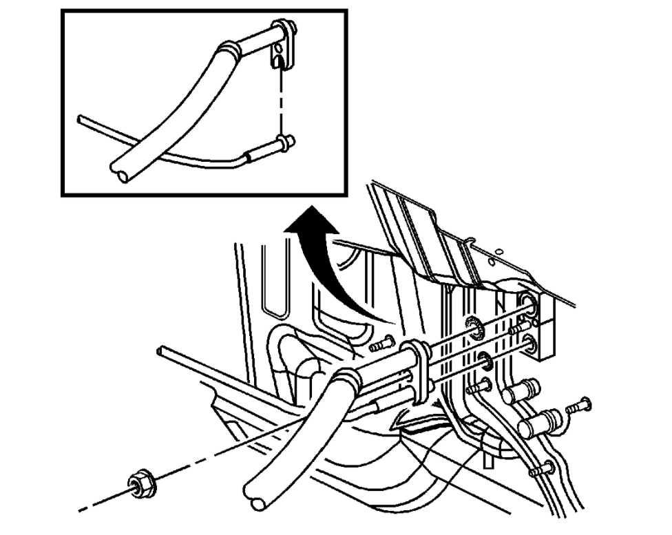

1. Install the HVAC module assembly.
2. Install the HVAC module retaining nuts from the cowl.
3. Tighten the HVAC module retaining nuts.
Tighten
Tighten the nut to 4.5 N.m (40 lb in).
4. If replacing the HVAC module assembly (8), transfer the components from the old HVAC module assembly as necessary.
5. Install the HVAC module assembly (8).
6. Connect all of the electrical connectors to the HVAC module assembly.
7. Connect the heater hose quick connects (2) and (3) to the heater core.
8. Install the evaporator tube and suction hose to the TXV.
9. Install the retaining nut to the TXV stud.
10. Tighten the retaining nut.
Tighten
11. Install the I/P carrier.
12. Evacuate and recharge the A/C system. Refer to Refrigerant Recovery and Recharging.
13. Leak test the fittings of the components using the J 39400-A.
14. Refill the engine coolant. Refer to Draining and Filling Cooling System in Cooling System.
