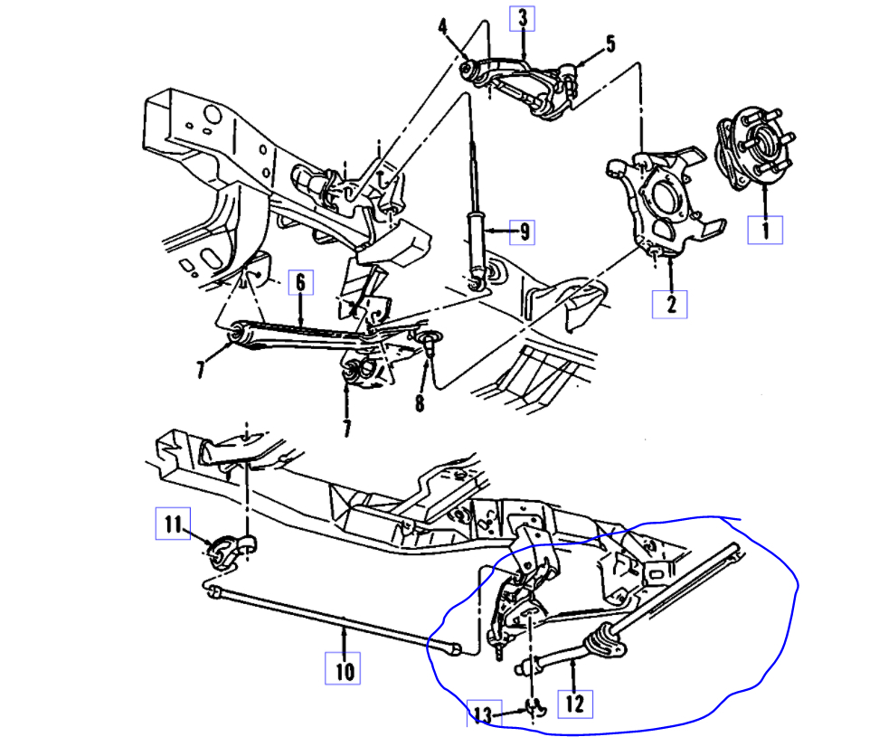

I am hearing noise coming from the stabilizer bar bushings
2000 DODGE DURANGO
170,200 MILES • 5.9L • V8 • 4WD • AUTOMATIC
TERRANCE HILL
Sway bar.
Aug 12, 2021 at 8:37 PM
Good morning,
The sway bar has 2 brackets that secure it to the front cross member. There are bushings between the bracket and the cross member. They are simple to replace by removing the 2 bolts for the bracket and lowering the bar.

There are end links on each side that are common for breaking of wearing out. You can get them at any parts store and they just unbolt and bolt back up.
