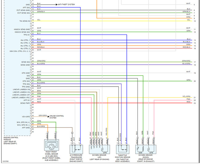

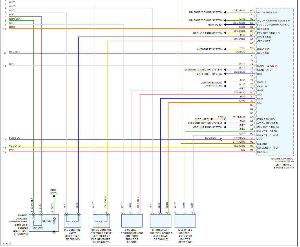

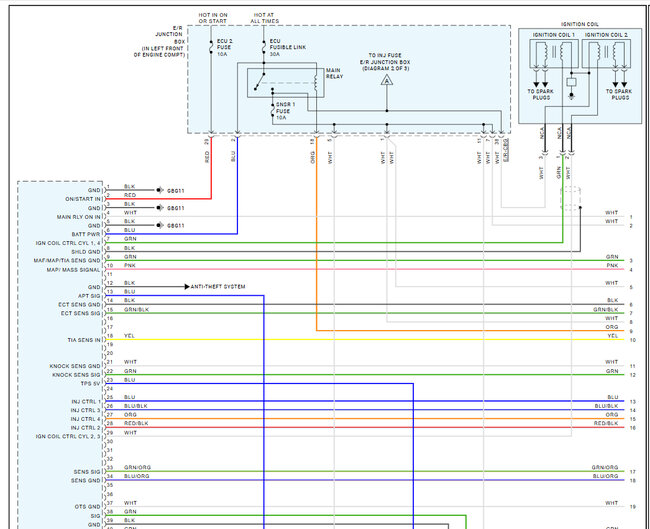

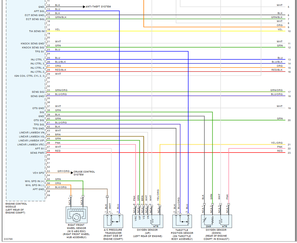

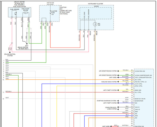

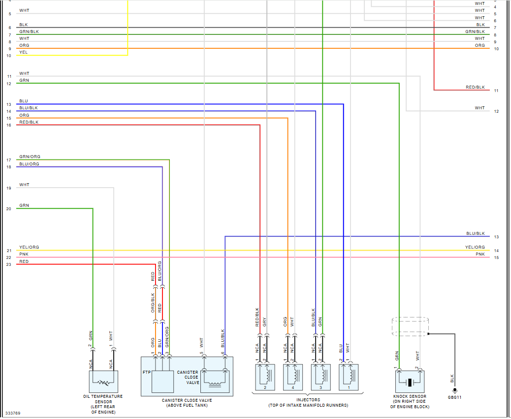

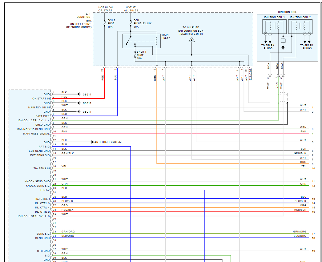

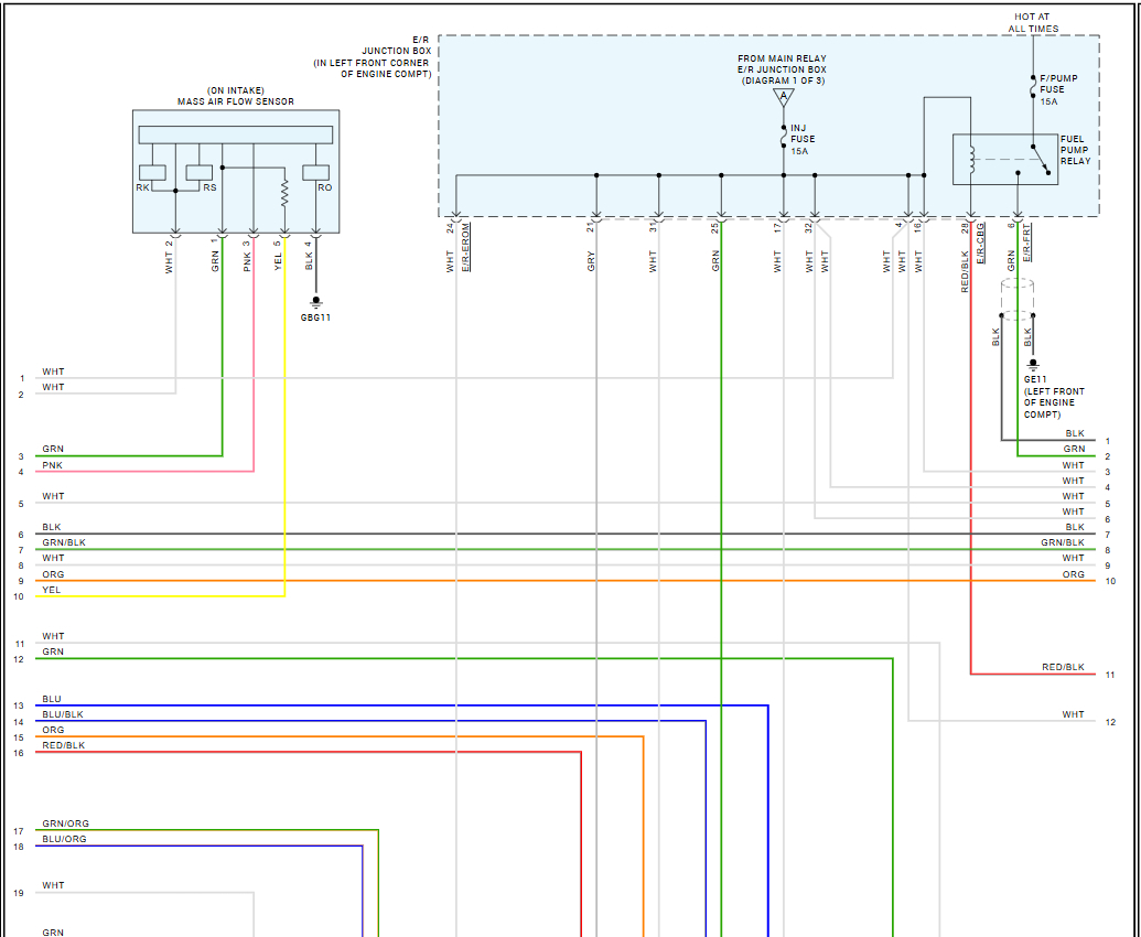

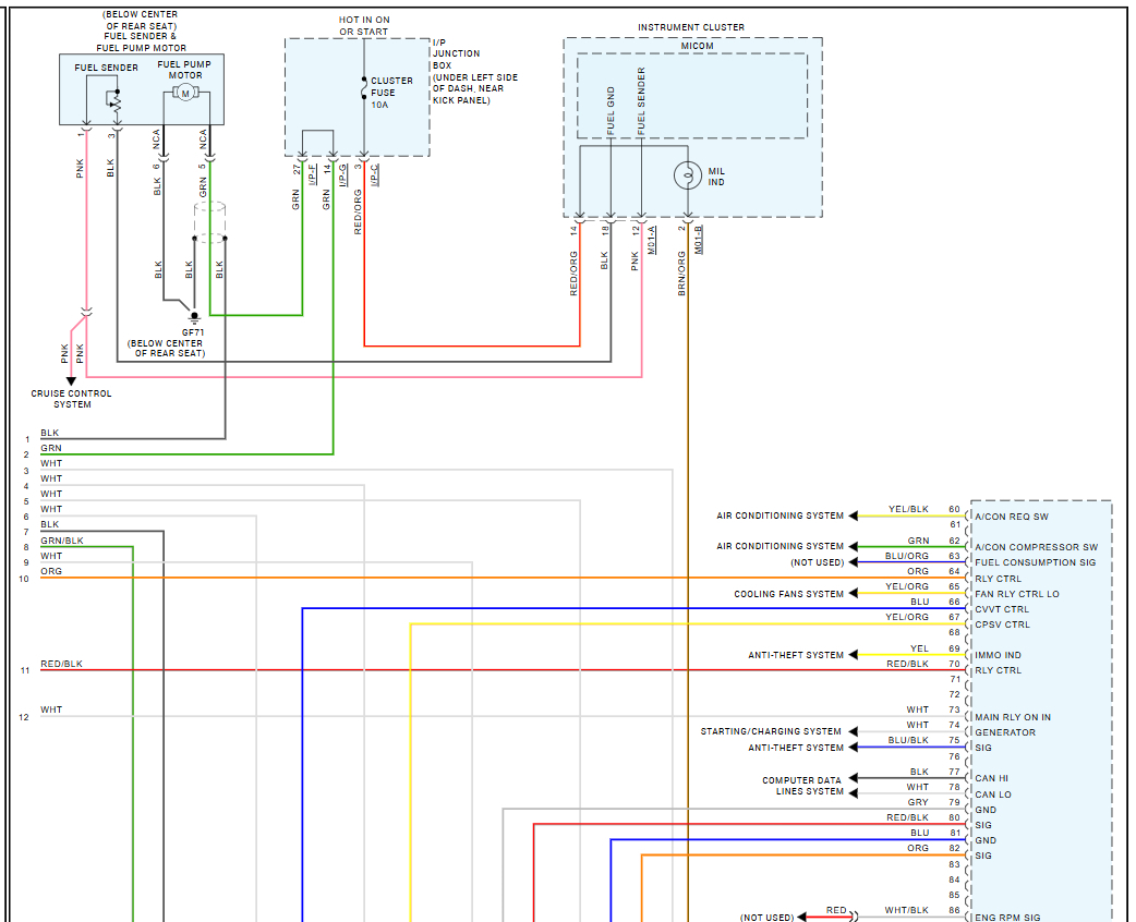

The vehicle was worked on at the garage after few days, the check engine light was on, the vehicle was scanned, misfire code on cylinder one was detected on the engine. After checking vividly, it was observed that the wires of the fuel injector has removed from the connectors and taped. The vehicle wiring has worked on by a technician.
Could I have the wire diagram of the vehicle?
Thank you
Nov 6, 2024 at 3:57 AM
  • 55,423 POSTS
Sure, here is the engine, fuel injector and PCM wiring diagrams. Check out the images (below). Let us know if you need anything else.
