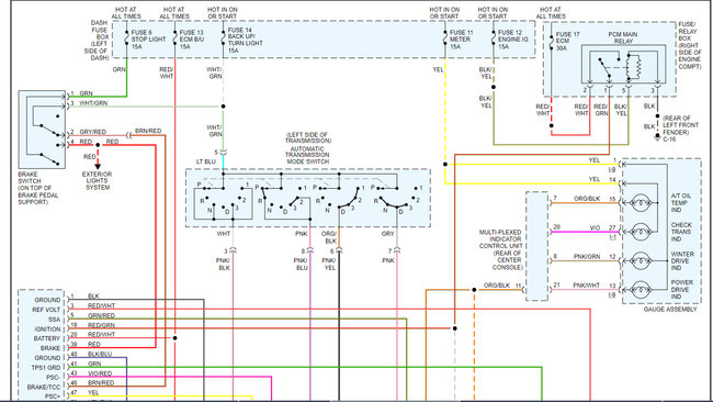

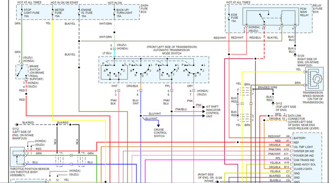

My vehicle listed above transmission was swapped with a 2001 Isuzu Rodeo, but there's one connection that one more wire then my passport. Is there a way through that wiring .
Mar 10, 2021 at 11:13 AM
Good morning,

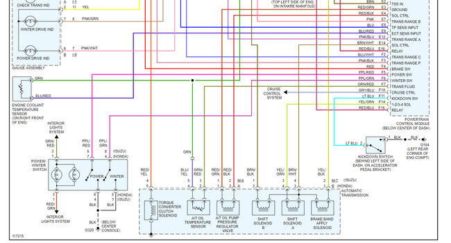

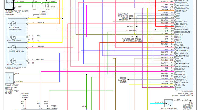

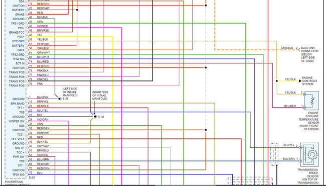

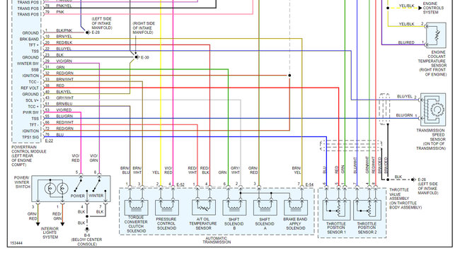

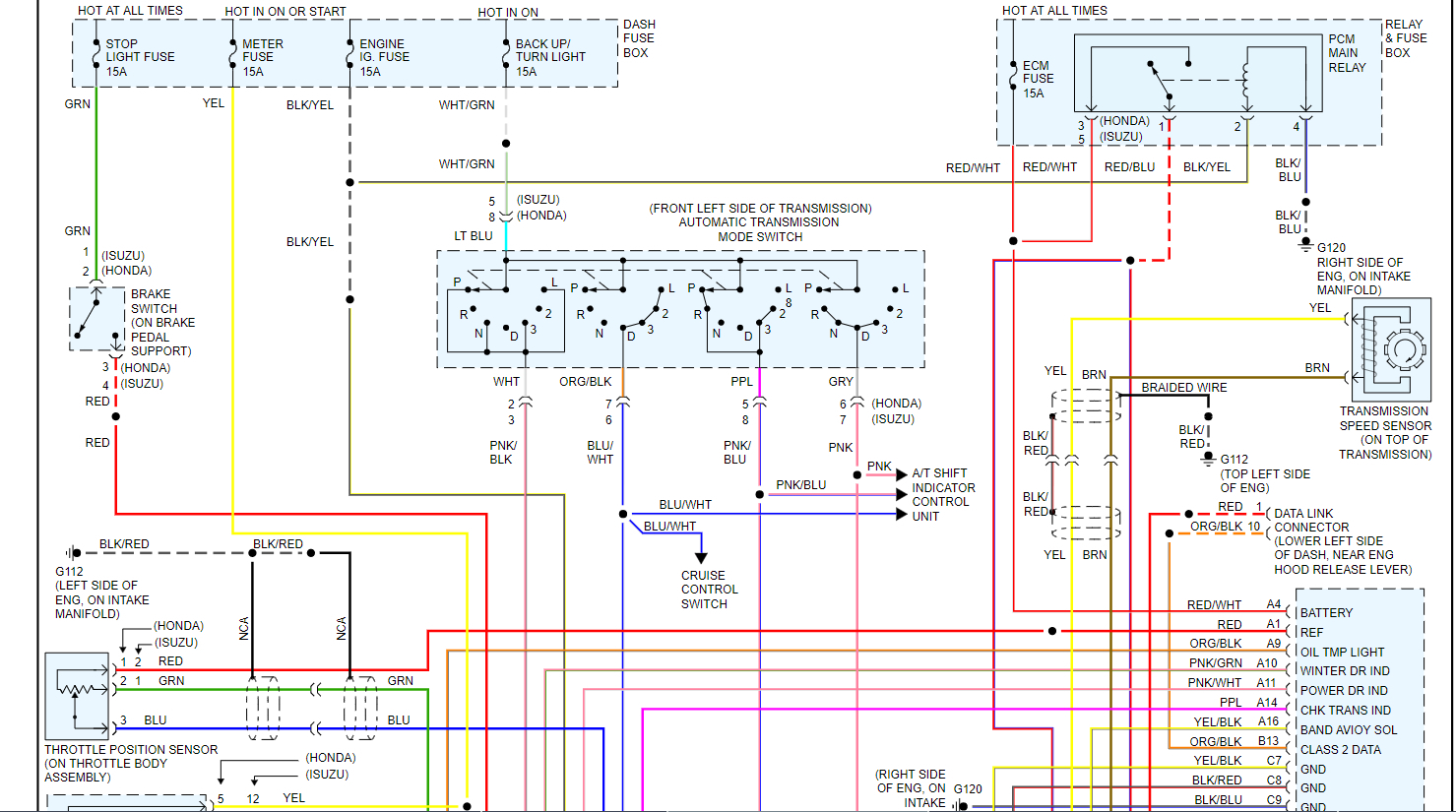

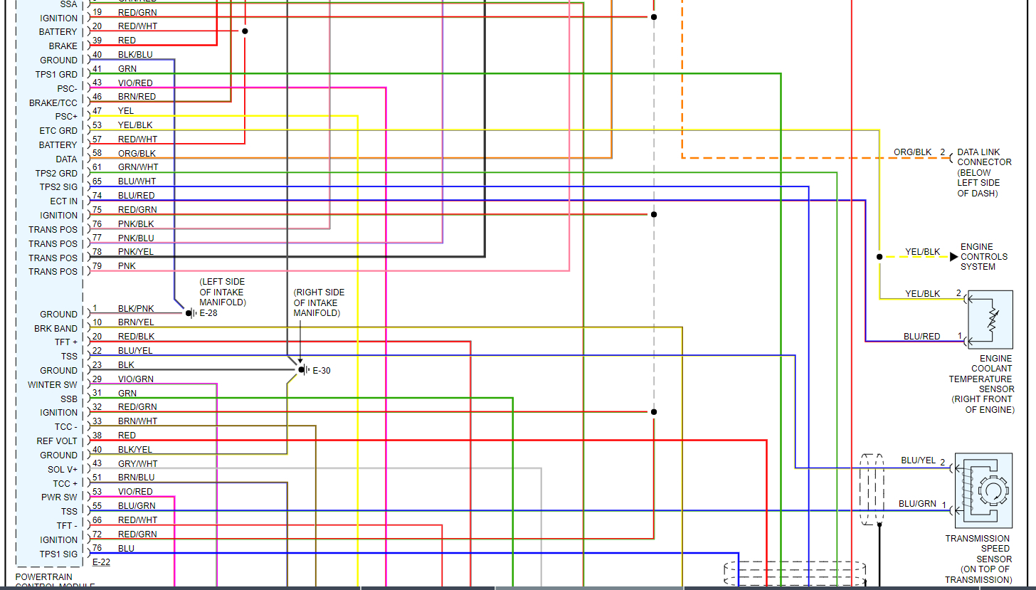

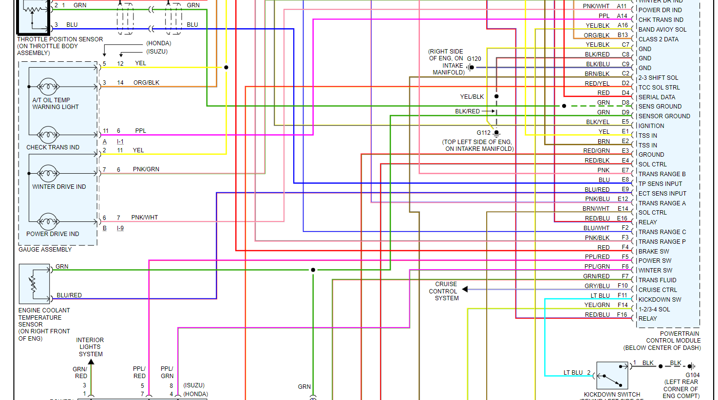

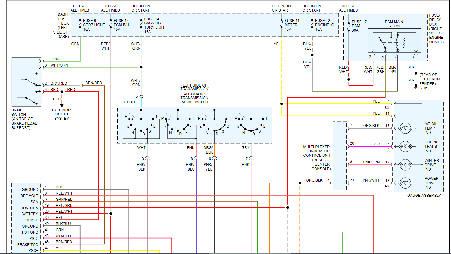

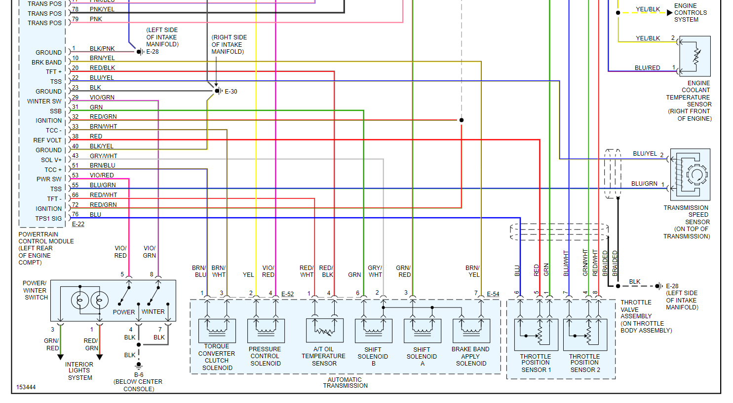

I attached the wiring for both transmissions. The controls are different for each one.
The simple answer is no. You need the correct transmission.
