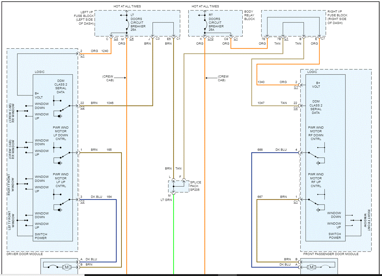

Swapped manual doors for power windows, need wiring diagram
2003 GMC SIERRA
150,000 MILES • 5.3L • V8 • 2WD • AUTOMATIC
CATHY.J.DAY.3

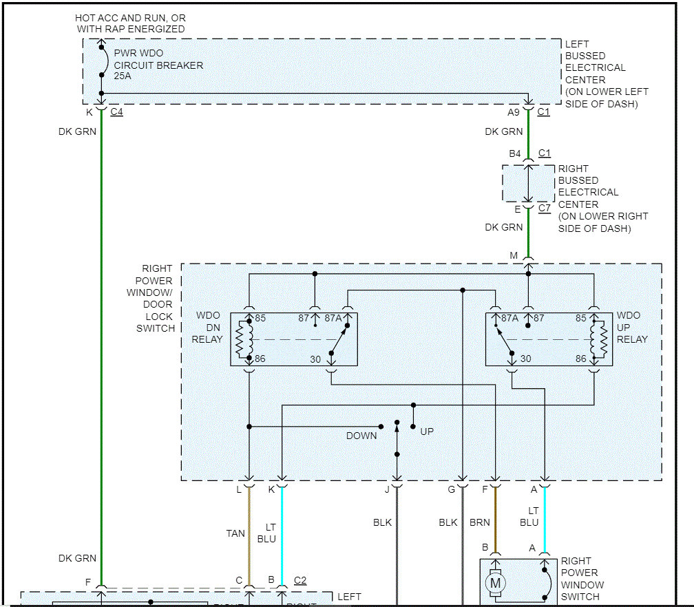

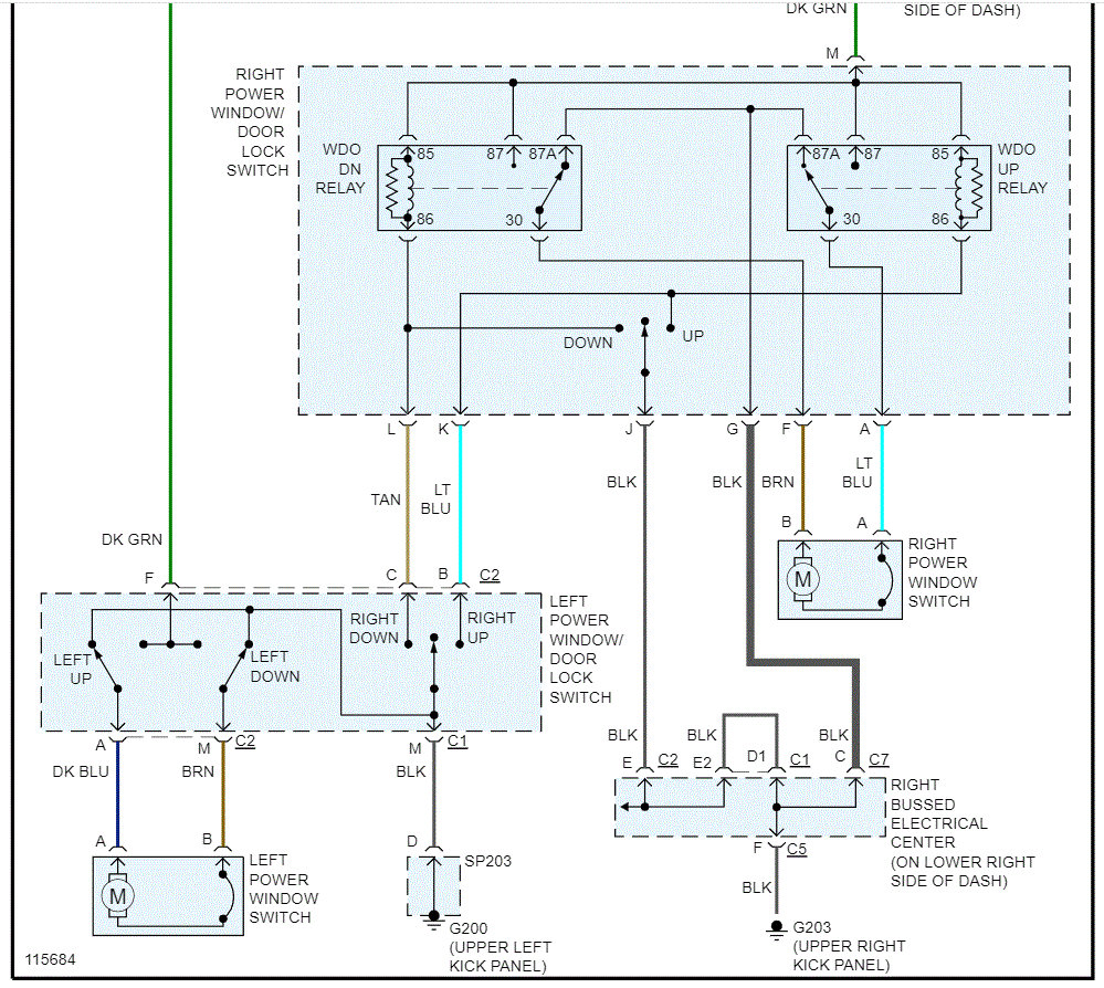

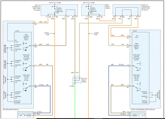

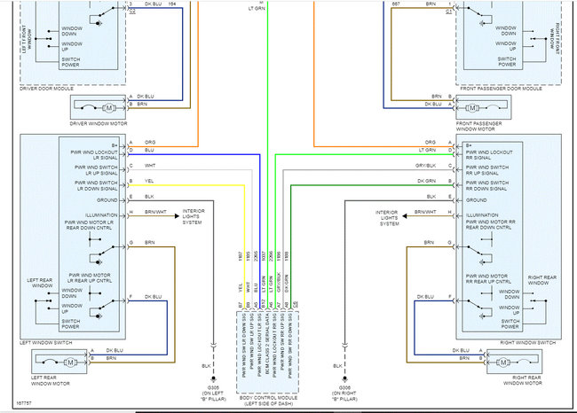

I need instructions on how to wire the power doors off of a 1999 Chevy Silverado onto my 2003 GMC Sierra that had manual windows I need wiring diagrams or how to hook those up please?

The difference in model years changes the design of the circuit. I'm not sure what all you received with the replacement doors, so I added the wiring schematics below for both the 2003 GMC and the 1999 Chevy.
Take a look through them and let me know if they help or if you have other questions. This may end up a little more difficult than you expected. Regardless, let's see if we can get it to work.
Here is a link you may find helpful when working with the wiring:
See pics below. Note: Pics 1 and 2 are the schematics for the 2003 and pics 3 and 4 are for the 1999. Each schematic in my manual was only one page, but I had to cut each in half to make them readable for you. I did overlap them so you can follow from one to the next.
