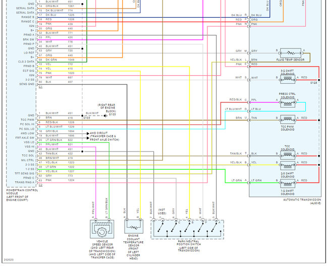

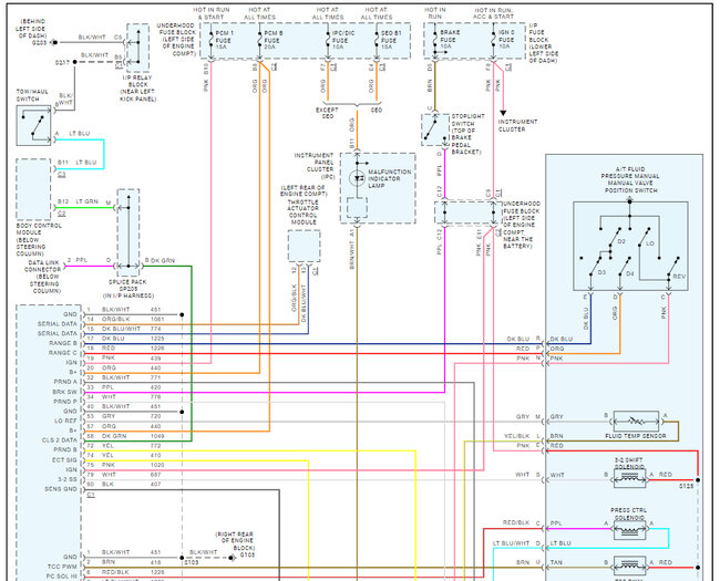

I would double check the pin location. also, did you swap the PCM and complete wiring harness? Here is how the transmission should be wired. Here is a guide so you can check the wiring connections:

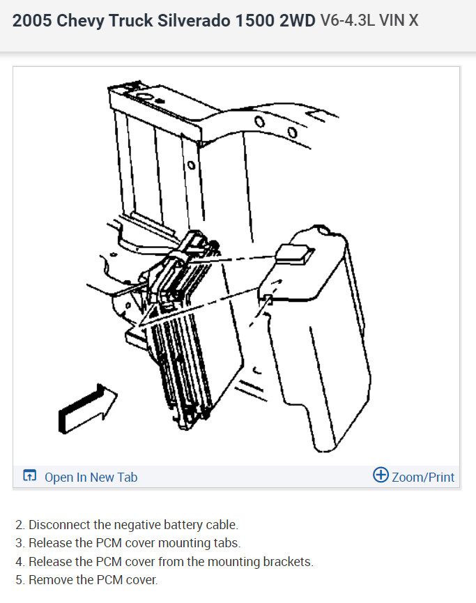

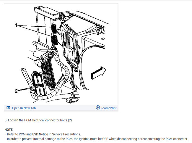

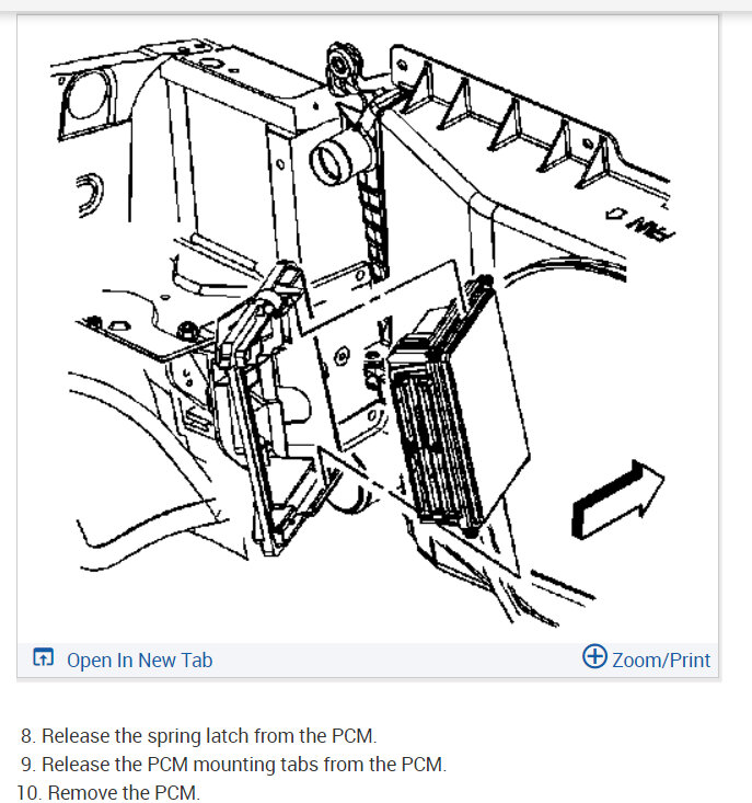

Sorry its Monday! You included the codes my bad. Yes, the PCM is located next to the radiator.
P0740 - Torque Converter Clutch Circuit Malfunction:
P0758 - Shift Solenoid 'B' Electrical:
P1860 - TCC PWM Solenoid Circuit Electrical
So, the wiring looks like it might be incorrect. I would remove the transmission electrical connector so you can match the colors the wires going into and out of the main transmission connector. Here is the location of the PCM. Check out the images (below). Let us know what you find.

So, I did check out the wires yesterday at the tranny. Moved original pin S to U. Created new S pin to ECM pin 79 and new T pin to ECM pin 42.
Mar 4, 2024 at 4:10 AM
CRYPTOKING
  • 27 POSTS
That's how I wired it. Is that wrong?
Mar 4, 2024 at 4:11 AM
  • 55,423 POSTS
I am not sure how you wired it, I would double check the colors going into, and out of the main connector to make sure it matches the wiring diagrams I provided. Can I ask why you repinned it in the first place?
