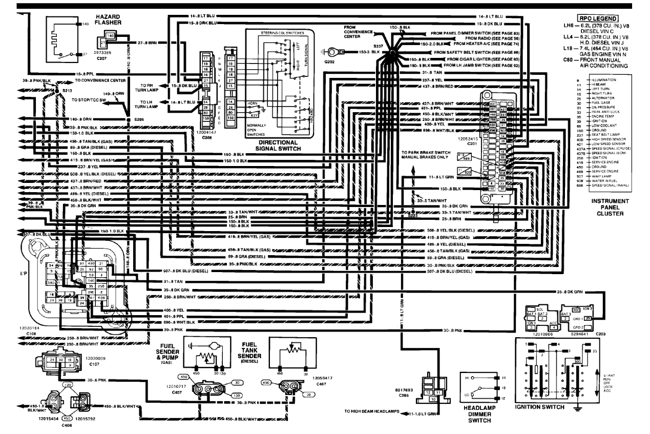

I would like to swap out my 1990 "Moonie" cluster for one of a compatible year model 1988 - 1993 I think. I want to replace with regular analog needle gauges. Is this just a plug in the doner cluster, and it works proposition?

I have heard more and more people interested in doing this lately. This might not be a simple plug-n-play affair. Your vehicle is right on the cusp of when they changed things up.
Can you upload a picture of the back of your cluster? It may be possible that a 1991 needle gauge cluster may work depending on the connector.

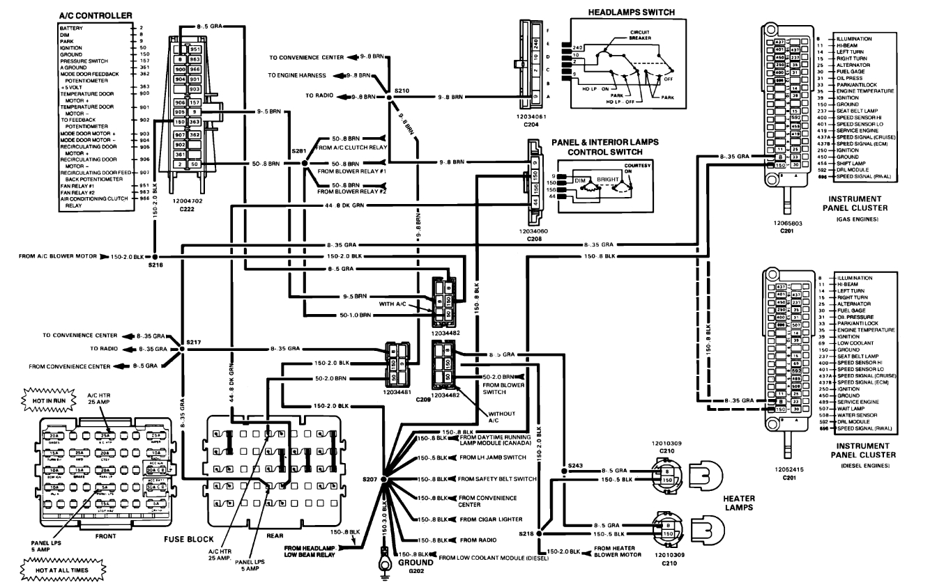

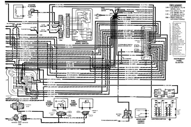

Thanks, how do you feel about the schematics offered in the Haynes or Chilton manual? I can read a schematic, (trained e tech, USAF, from the 1970's analog years, but not 100% ignorant of digital).
Nov 17, 2018 at 12:11 AM
  • 55,421 POSTS
Here are the wiring diagrams for the instrument cluster so you can confirm the locations and connections. This guide can help you as well.
