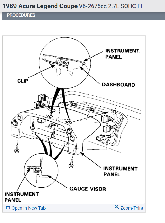

My car listed above fuel gauge failed so I swapped in a used cluster from another 1989 Legend Coupe; however, new cluster's temperature gauge doesn't work. Can I swap the temperature gauge out of my old cluster into the replacement cluster?

Yes, you should be able to do that or just check the wiring going to it. The issue is most likely in the wiring or at the plug that the cluster plugs into. Take a look at that to make sure its secure and nice and clean making sure all the contacts are goods. Look for any cracks in the foil ribbon and check all your fuses just in case. Check out the diagrams (Below). Please let us know what you find. We are interested to see what it is. Tom

Thanks for the quick reply, will give it a shot. Original cluster is fine but when swapping the new one in everything works but the temp. Externally looks okay (no breaks in the ribbon) so something inside, will dig around. Thanks again.

Yes, take a good look, it would be pretty rare for the gauge itself to be bad. Its connections yes or even the sending sensor sure but the actual gauge unlikely. Check the grounds for the cluster too. It way more likely something got disturbed in doing the job.

Thanks for the suggestion. Here's the latest, with the car running I swap in the old cluster and no gas gauge reading but temperature is fine. Then I swap back in the new cluster and gas gauge reads correctly but no temperature. Grrr.... No visible breaks in the ribbon and the temp and fuel gauge look like a paired unit so unless I really dig into the thing, separating them would be tricky. I can live without a gas gauge (I get about 300 miles per tank so I just set the trip odometer) but temperature is my most important gauge so might be going back to the old cluster. Thanks for everyone's help here, much appreciated.
