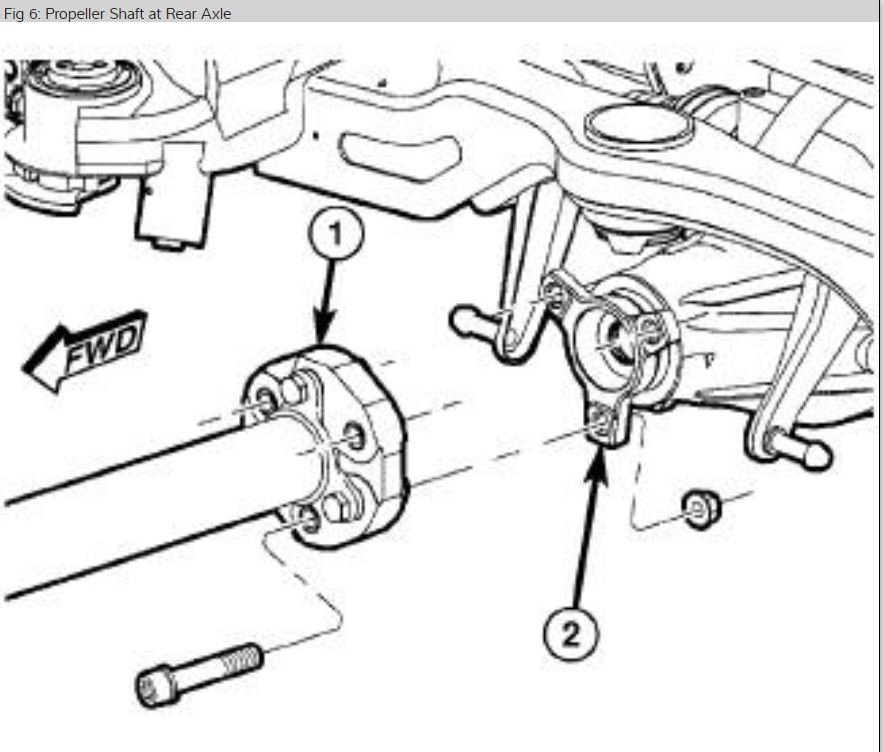

Everything bolted right up but the spindle for the drive shaft would not. so can I use the spindle off the old differential?
Mar 19, 2018 at 10:10 PM
PATENTED_REPAIR_PRO
  • 1,853 POSTS
What are you referring to as a spindle?
Do you mean the flange on the front of the differential that the rear end of the driveshaft bolts to? #2 shown here?
Does that #1 coupler unbolt from the end of the driveshaft?
Mar 20, 2018 at 1:53 AM
LARRY1980
  • 5 POSTS
Yes, the flange on the differential.
Mar 20, 2018 at 1:55 AM
PATENTED_REPAIR_PRO
  • 1,853 POSTS
Does the coupler unbolt?
Mar 20, 2018 at 1:58 AM
LARRY1980
  • 5 POSTS
Yes.
Mar 20, 2018 at 5:40 AM
PATENTED_REPAIR_PRO
  • 1,853 POSTS
Okay, does the coupler from the other driveshaft fit on this one? If you do not have it you may want to check if it will fit on this driveshaft because you know it will fit to the differential flange.
Mar 20, 2018 at 6:34 AM
LARRY1980
  • 5 POSTS
I have it but it does not fit the drive shaft.
Mar 20, 2018 at 6:36 AM
PATENTED_REPAIR_PRO
  • 1,853 POSTS
You may want to check near you for a driveshaft shop that can help you fix this problem. perhaps they could cut off and weld the end of the driveshaft that this coupler does fit the flange onto the driveshaft that fits this vehicle. Did you by chance just check if the entire driveshaft from the 2010 would fit? Or if it is a two piece if just the back half would fit?
