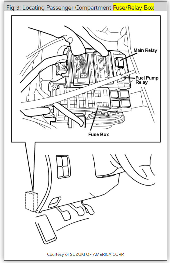

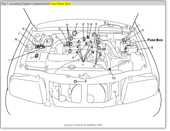

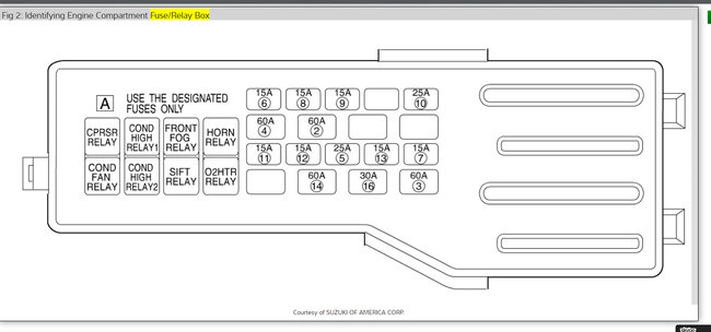

IS THERE MORE THAN ONE FUSE BOX.
Mar 16, 2009 at 6:39 PM
Experienced Mechanic
55,682 POSTS

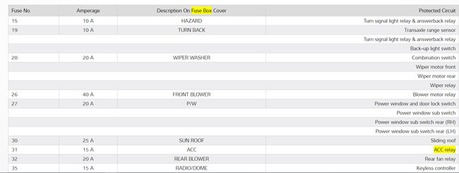

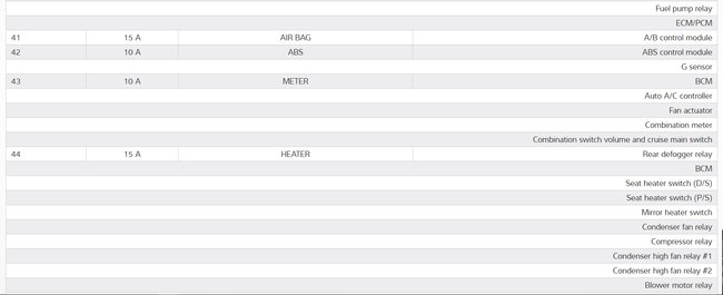

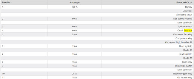

Here is a guide to show you how to check the fuses.
Here is the location of the fuses (Below)
