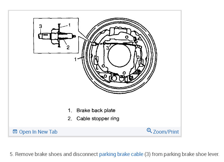

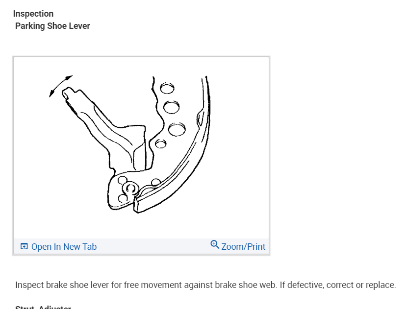

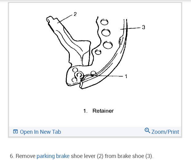

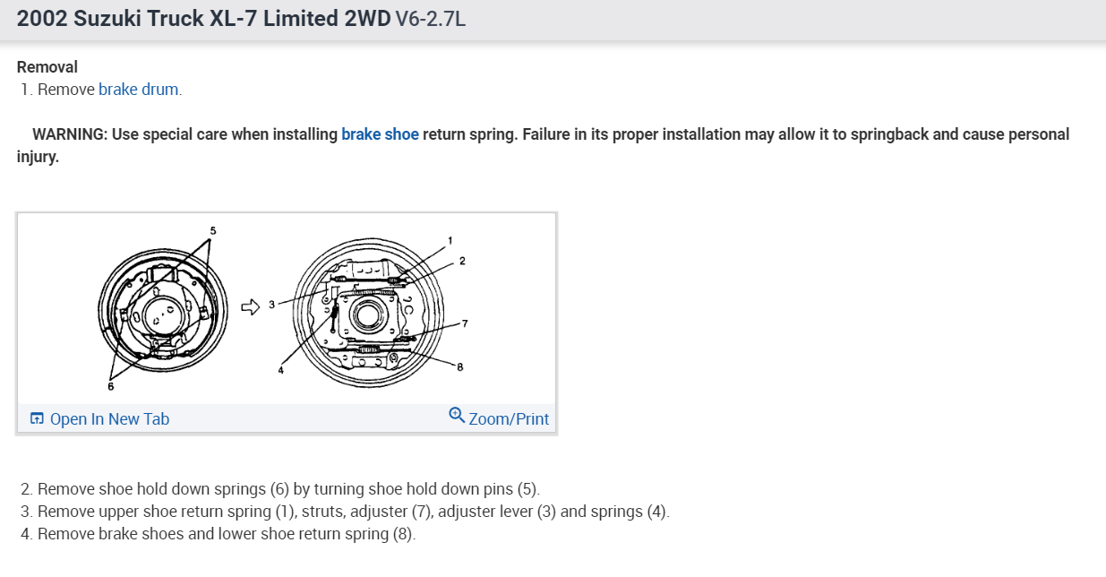

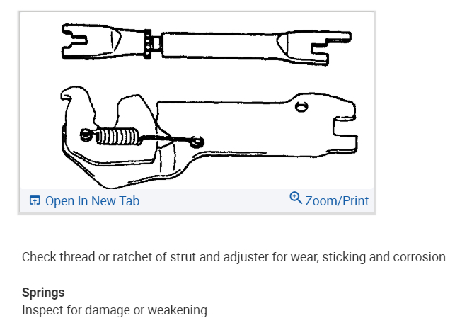

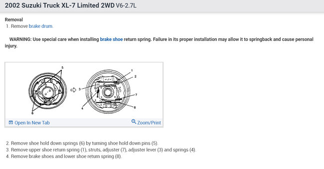

How do you change the rear brakes?
Oct 11, 2008 at 9:21 AM
DAVE H
  • 13,384 POSTS
This style of brake is super common and most car manufacturers use them so this video will show you how even though it is on a similar car the process is the same Plus I have included the instructions for you car in the diagrams below.
