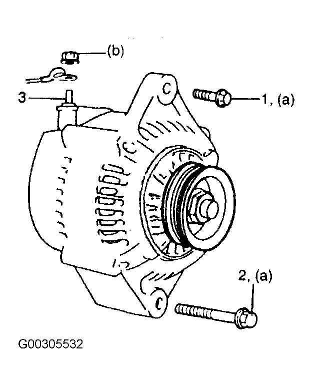

Can you please tell me the tool type and size I need to remove the lower alternator bolt on my 2002 Suzuki XL7? thanks...

I believe itis a 50 Torx, be careful not to strip it
GENERATOR
Removal
Disconnect negative cable at battery.
Disconnect generator lead wire ("B" terminal wire) and coupler from generator.
Remove generator belt. See GENERATOR BELT .
Remove generator drive belt adjusting bolt and generator mounting bolt.
Remove generator.
Installation
Mount generator on the generator bracket.
Tighten generator bolts (upper bolt "1", lower bolt "2") to specification. See TORQUE SPECIFICATIONS .
Install generator (cooling fan) belt. See GENERATOR BELT .
Connect "B" terminal wire "3" and coupler to generator. Tighten "B" terminal outer nut "b" to the specification. See Fig. 18 .
Install canister.
Connect negative cable at battery.

It is a torx T50 but good luck. Mine is stripped too. I am going to try to take holding bracket off and work with it on bench.

So do you need to know what size socket to remove the bottom bolt i don't have detail's about that in my repair manual's.Or are you having trouble getting the bolt out by being able to get a socket on the bolt.Let me know. I believe it is a 50 Torx

GENERATOR
Removal
Remove generator.
Installation
Tighten generator bolts (upper bolt (1), lower bolt (2)) to specification.
Connect "B" terminal wire (3) and coupler to generator. Tighten "B" terminal outer nut (b) to the specification. See Fig. 17.
Install canister.
