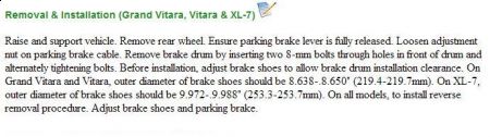

I need to know how to remove the rear brake drum on my car.I have tried everything that I can think of.
