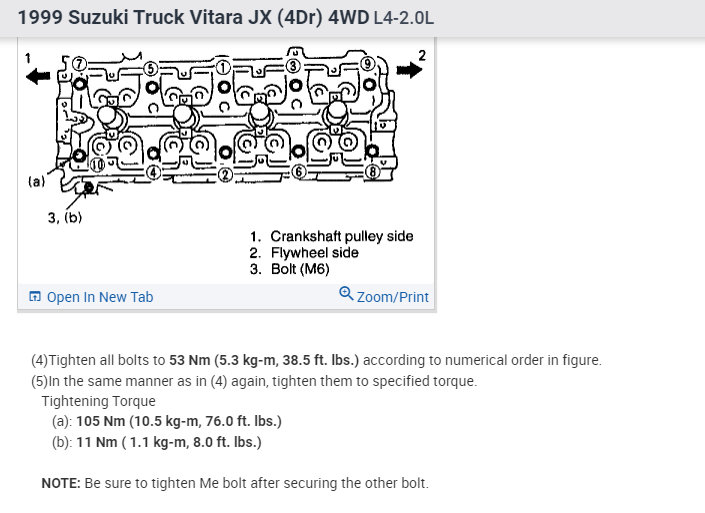

h20a bolt torque needed
1999 SUZUKI VITARA
200,000 MILES • V6 • 4WD • MANUAL
KHALID 36

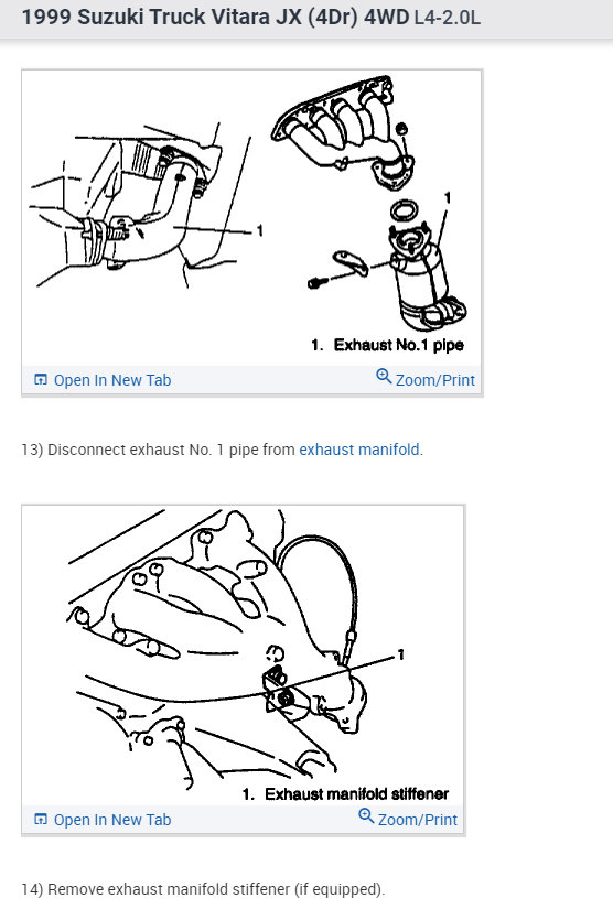

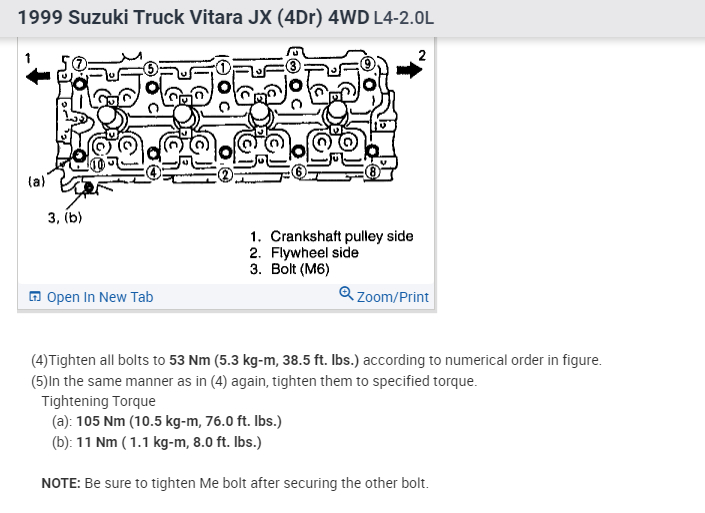

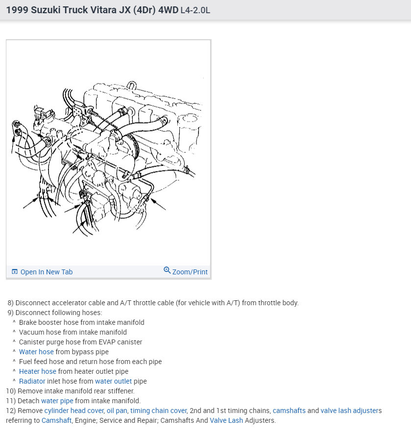

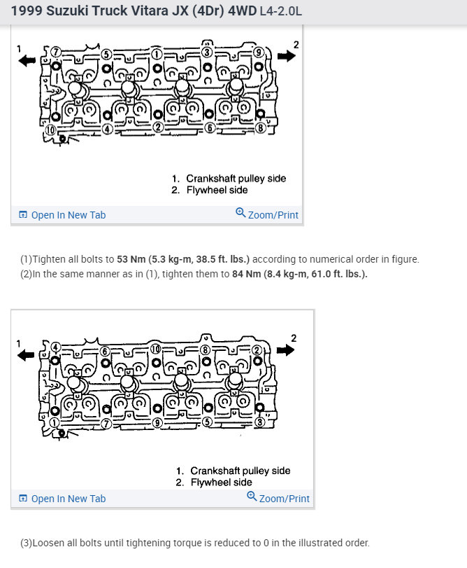

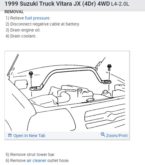

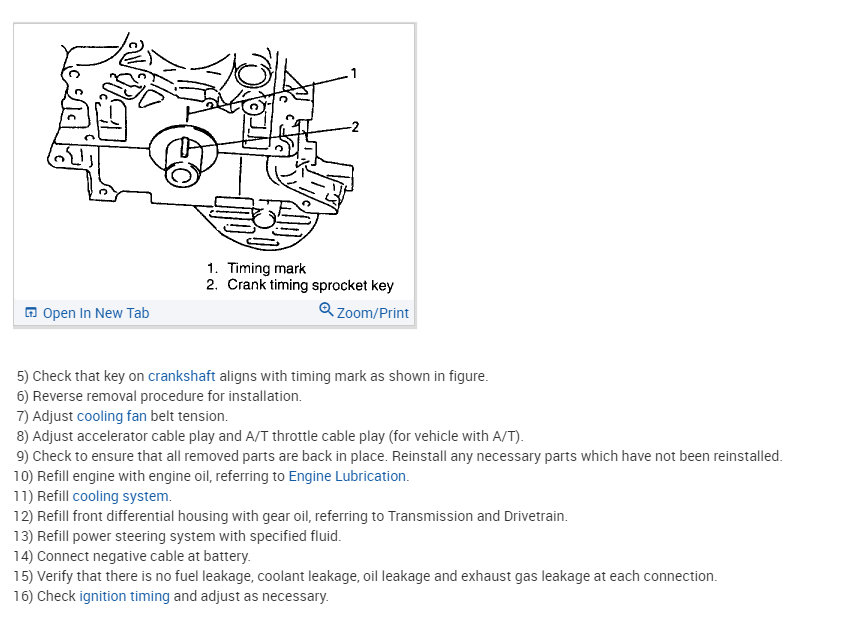

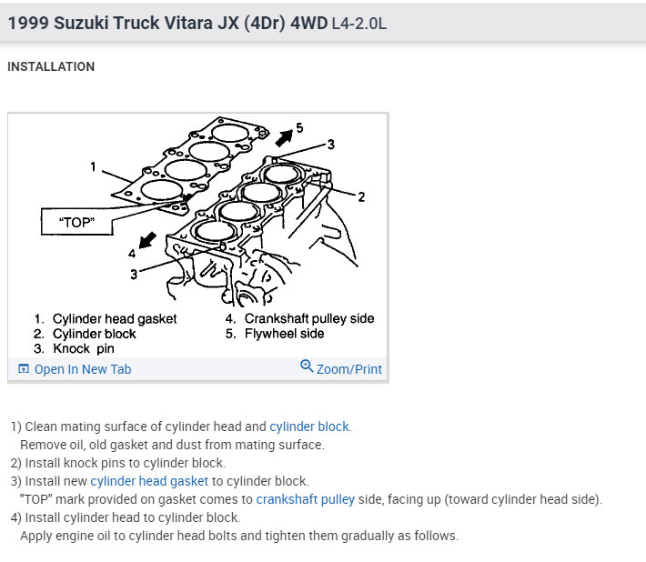

The vehicle listed has an h20a, bolt torque head and rod.
Jun 21, 2022 at 5:51 AM
SQM
  • 6,383 POSTS

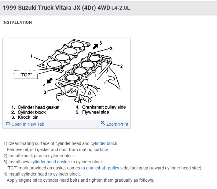

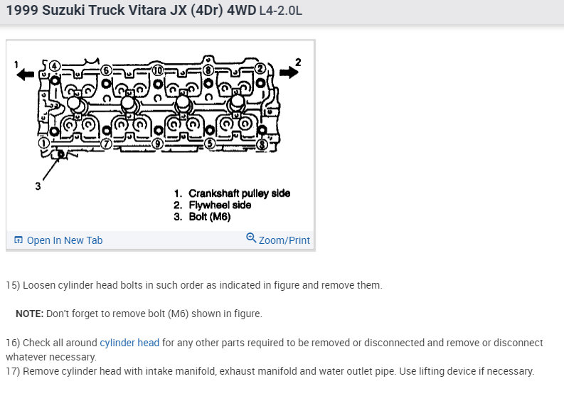

There are a few steps to the cylinder head bolt torque procedure.
I have attached the complete procedure below. That shows the torque specifications as well as the sequences.
Note, you have listed the vehicle as a V6 but the H20a is a four cylinder. So, I have provided the info for the H20a.
Let me know of any questions.

The h20a is a 2.0l v6 not a 4 cylinder?
Nov 7, 2022 at 1:31 PM
SQM
  • 6,383 POSTS
Our catalogs are for US spec vehicles.
Suzuki did not offer a 2.0L V6 engine for the US market.
Only V6 that was sold here was 2.5L.
