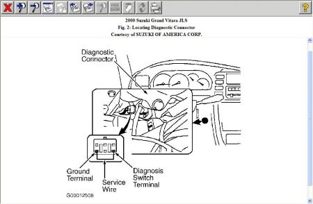

Hi Mario, Thank you for the donation. An error has been detected in the ABS system and you need to get a diagnostic scan done to find the cause of the fault. RETRIEVING DIAGNOSTIC TROUBLE CODES 1. Ensure ABS warning light operates for 2 seconds after ignition switch is turned on (bulb check). 2. Connect jumper wire between ground terminal and diagnosis switch terminal on diagnostic connector. See Fig. 2 . Turn ignition on. Monitor ABS warning indicator light. DTCs are indicated by "blinking sequence". First and second digits of 2-digit DTC are separated by a one second pause. Lowest number DTC is displayed first.

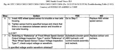

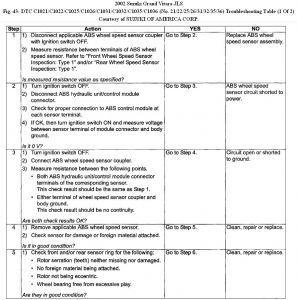

I have the following ABS code:
-21
-22
-25
-63
But the car is now fixed but ABS light still on... What can I do to reset to code?

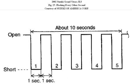

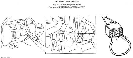

Hi GyroTechTom, Thse codes are for faults with the wheel sensor and the failsafe relay. There are 2 types of system and the code clearance is for Type 1. Let me know if it is the correct one. Diagnostic Trouble Codes Clearance WARNING: When performing a driving test, select a safe place where there is neither any traffic nor any traffic accident possibility and be very careful during testing to avoid occurrence of an accident. After repair or replace malfunction part(s), clear all DTCs by performing the following procedure. 1. Turn ignition switch OFF. 2. Using service wire (4), connect diagnosis switch "PNK" wire terminal (2) of diagnosis monitor coupler (1) to "BLK" wire terminal (3).
https://images.2carpros.com/forum/automotive_pictures/192750_ABS02VitaraFig24_1.jpg
3. With connection described in Step 2 maintained, turn ignition switch ON. 4. Repeat disconnecting and reconnecting of service wire between diagnosis and ground terminals 5 times or more at about 1 sec. interval within 10 seconds.
https://images.2carpros.com/forum/automotive_pictures/192750_ABS02VitaraFig25_1.jpg
5. Turn ignition switch OFF and disconnect service wire from monitor coupler. 6. Perform Driving Test in ABS CHECK and DTC CHECK and confirm that normal DTC (DTC 12) is displayed; not malfunction DTC.
Aug 25, 2010 at 11:30 PM
GYROTECHTOM
Thanks for your help,
All codes were clear execpt code 25.
Do you know what it's stand for because all abs wires seems to be fine now...
Thanks again,
Thomas
Aug 27, 2010 at 9:18 AM
KHLOW2008
  • 41,814 POSTS
Code 25 = Wheel Speed Sensor Circuit or Sensor Rotor. The repair information from our database does not indicate which wheel it is from as the Suzuki people expects us to be able to guess the wheel correctly, lol. It should be Left Rear Wheel. If any work was carried out on the rear left wheel bearing etc, echeck those. Check the wheel sensor for broken wirings etc.
