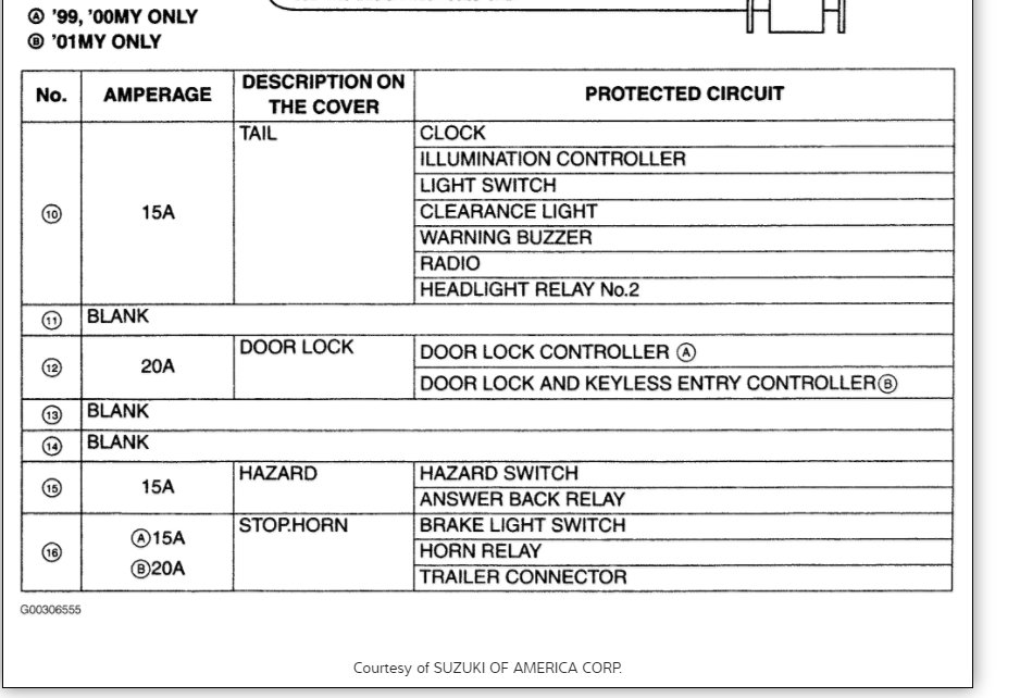

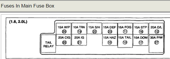

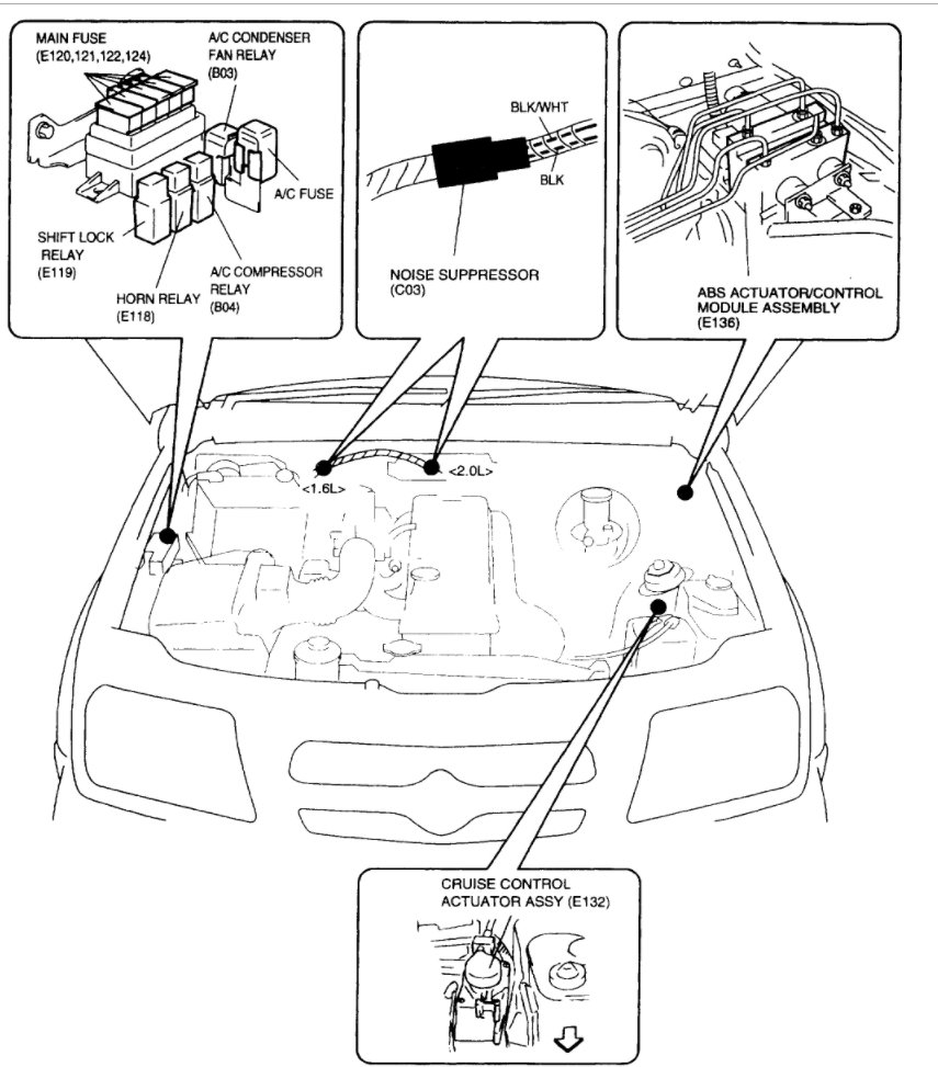

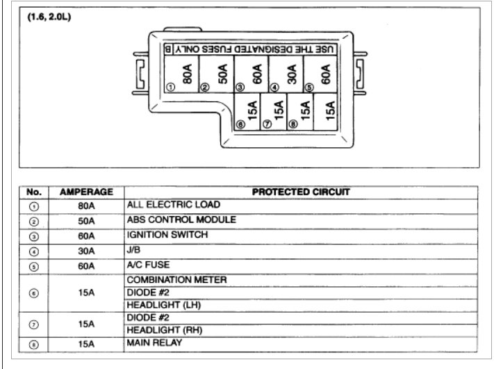

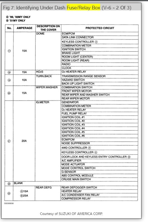

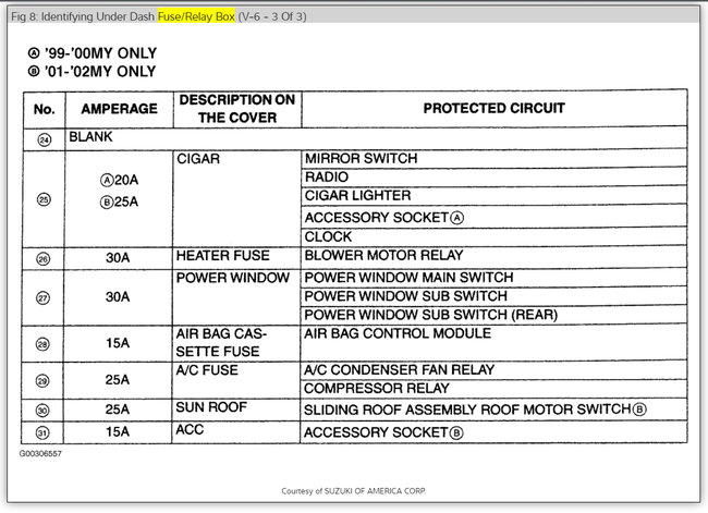

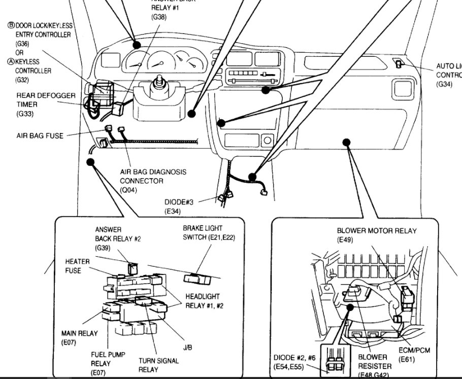

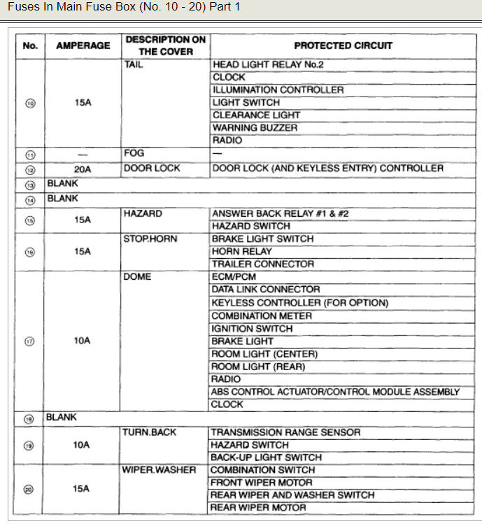

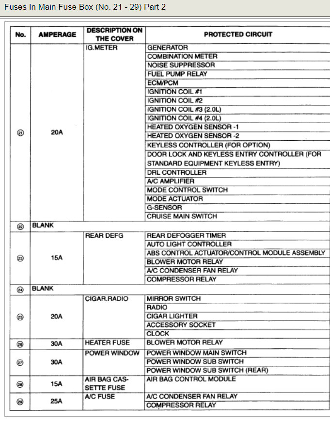

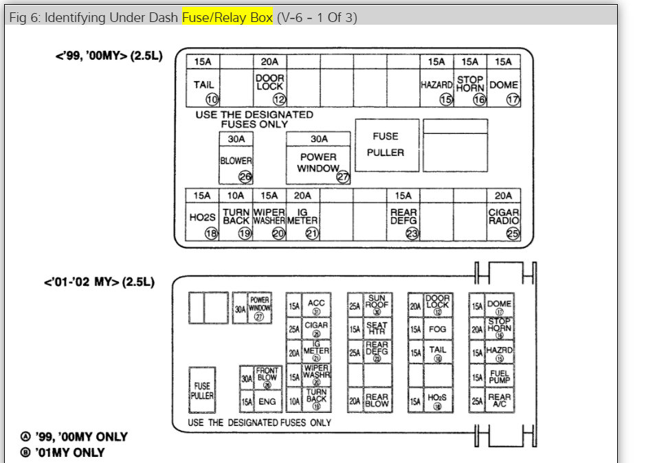

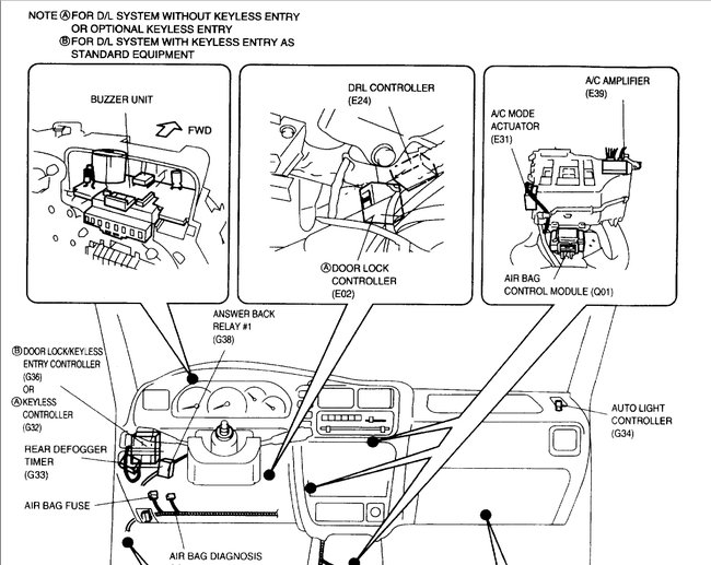

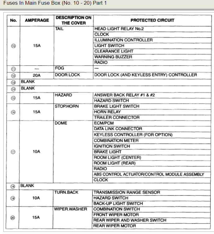

My radio and cigarette stopped working. I need to replace the fuse but cannot locate?
Dec 2, 2009 at 1:07 PM
  • 55,428 POSTS
There seems to be a bit of confusion among the repair manuals so I have all options for you. Here is a guide to help you test the fuses I think it will help.
