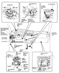

I am having a heck of a problem locating the blower motor on this 2001 vitara. It did work sporadically but now does not work at all. I have replaced the relay and that didn't do it so i'm thinking the blower motor is next but i can't find it. Where is the darned thing???

The blower motor is on the right side of dash behind the glove box.
https://images.2carpros.com/forum/automotive_pictures/12900_blower_24.jpg
