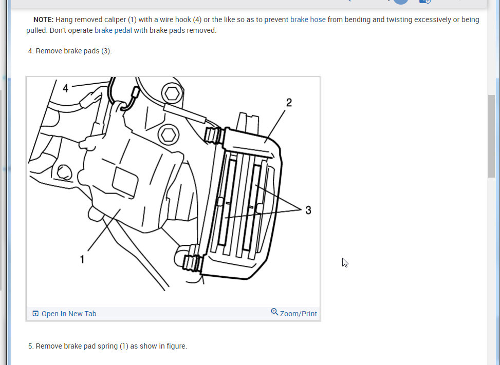

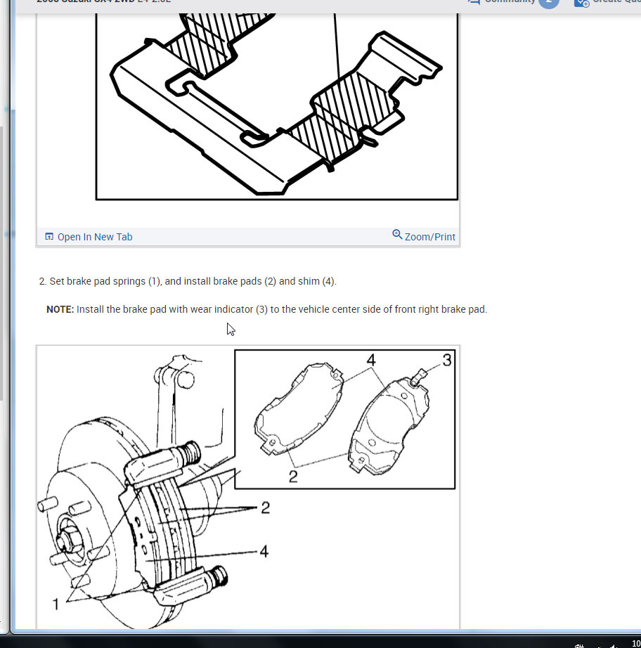

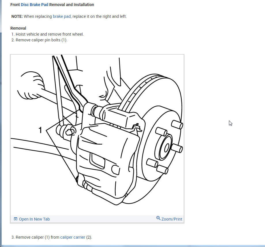

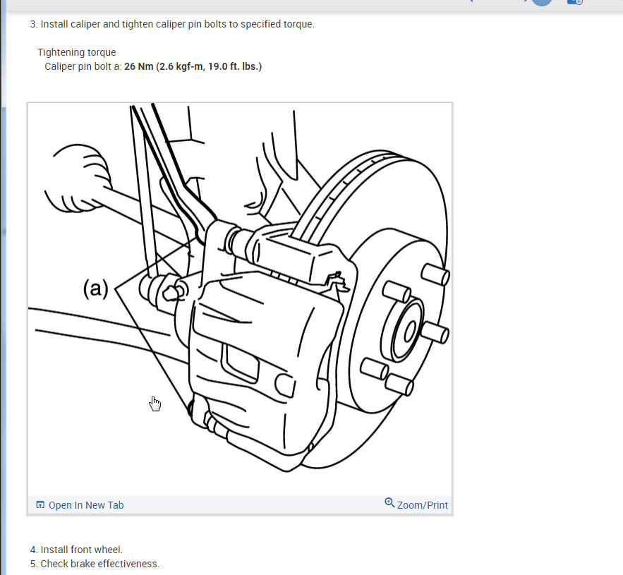

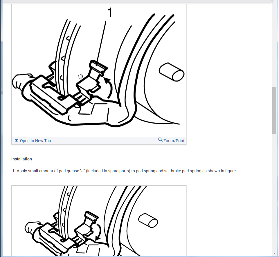

My new 2008 Suzuki Swift+ will vibrate when I hit the brakes can you help me replace the pads and rotors?
Tuesday, April 7th, 2009 AT 2:29 PM
MECHANIC
18,907 POSTS
Here is a guide that will help with replacing the front brakes:
Below is the process from the manual on how to replace the brakes. Let us know if you have other questions. Thanks
