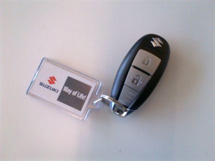

how we can make suzuki swift car model 2007 made for japanese market chassis model ZC71S
ACCEPT one virgin smart keys
we have one transponder key shell

Immobilizer Programming Procedure
Turn the ignition switch to the ON position.
Install the scan tool.
Select IMMOBILIZER PROGRAMMING FUNCTION from the BODY menu.
Follow the scan tool instructions with each key until all keys are programmed.
Cycle the ignition 3 times as indicated by the scan tool.
Turn the ignition to the LOCK position, disconnect the scan tool and test all the keys.
If any key does not function, perform this procedure again with all keys.
If any key does not accept the programming, replace it with a new key and perform this procedure again with all the keys.
