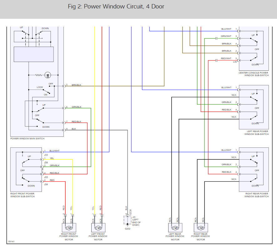

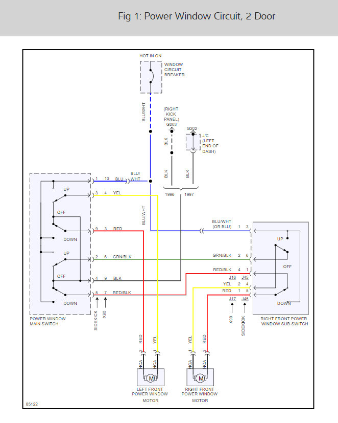

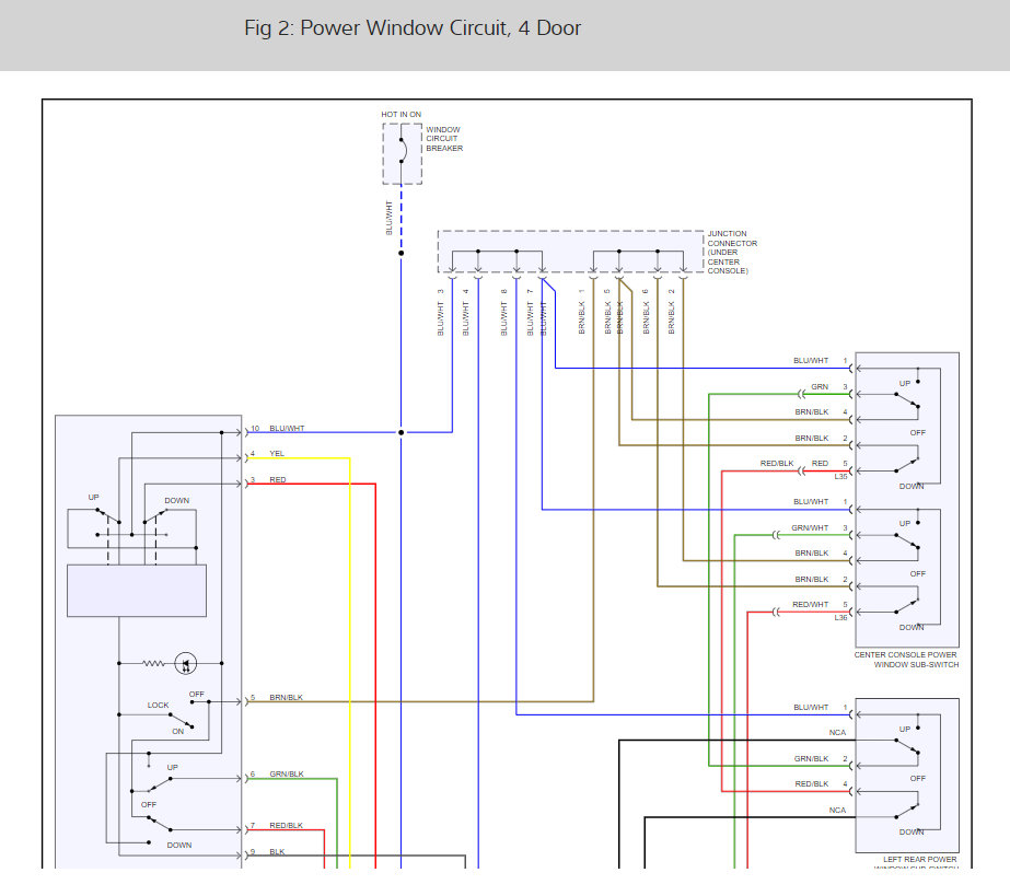

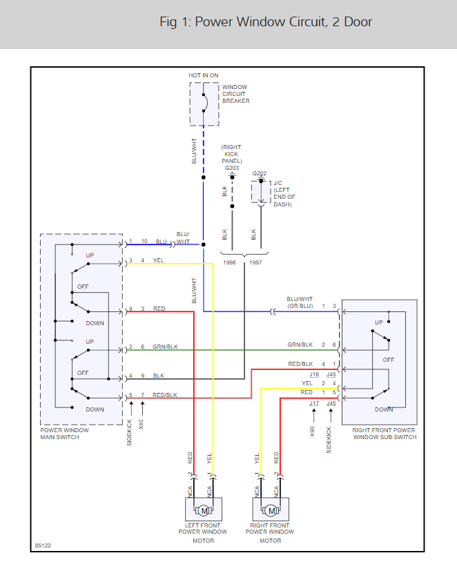

I have wiring diagram for the window circuit it shows a circuit breaker but doesn't show where it is, neither does the owners manual, none of the windows work I would like to find out where the breaker is.

I have posted a diagram of where the circuit breaker is for the power windows and a guide to help test the connections.
