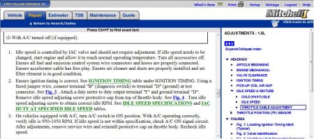

How do I set the idle for a 1997 Suzuki Sidekick 4WD 1.6 Liter?
May 7, 2009 at 6:22 PM
  • 75,992 POSTS
See below follow it to the T
https://images.2carpros.com/forum/automotive_pictures/12900_suzuki_idle_speed_1.jpg
