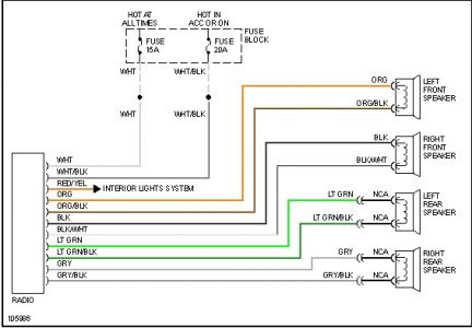

what is the color coding for the radio power wires

https://images.2carpros.com/forum/automotive_pictures/261618_Noname_1884.jpg
