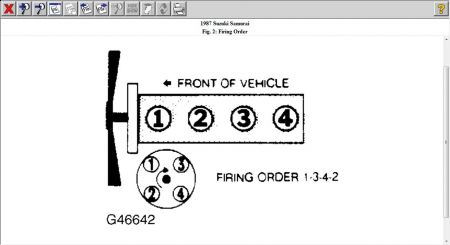

i need a diagram of which plug wire hooks to each plug.
Apr 9, 2009 at 2:24 AM
  • 75,992 POSTS
Welcome to 2carpros Here you go
https://images.2carpros.com/forum/automotive_pictures/12900_fo_43.jpg
