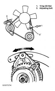

I have a 1997 Suzuki Sidekick. The serpentine belt is slipping. I have looked but can't decipher how to tighten the belt. Also is there any way to tighten the short v belt on the water pump? Can you also furnish a diagram of the belt/pully installation?
Thanks, Jeff

Check out the images (below). Let us know if you need anything else.
https://images.2carpros.com/forum/automotive_pictures/266999_suz_13.jpg
