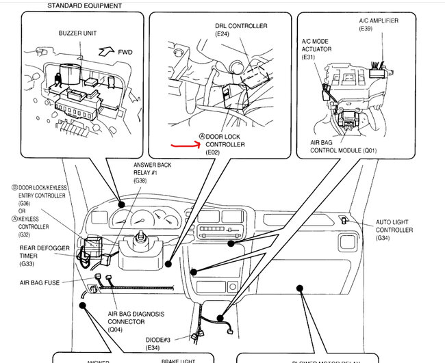

My power locks lock all doors properly, but when i try to unlock the doors, only the driver side unlocks. Also, when I lock the door before i close it, it unlocks again.

check the owners manual for reset procedure

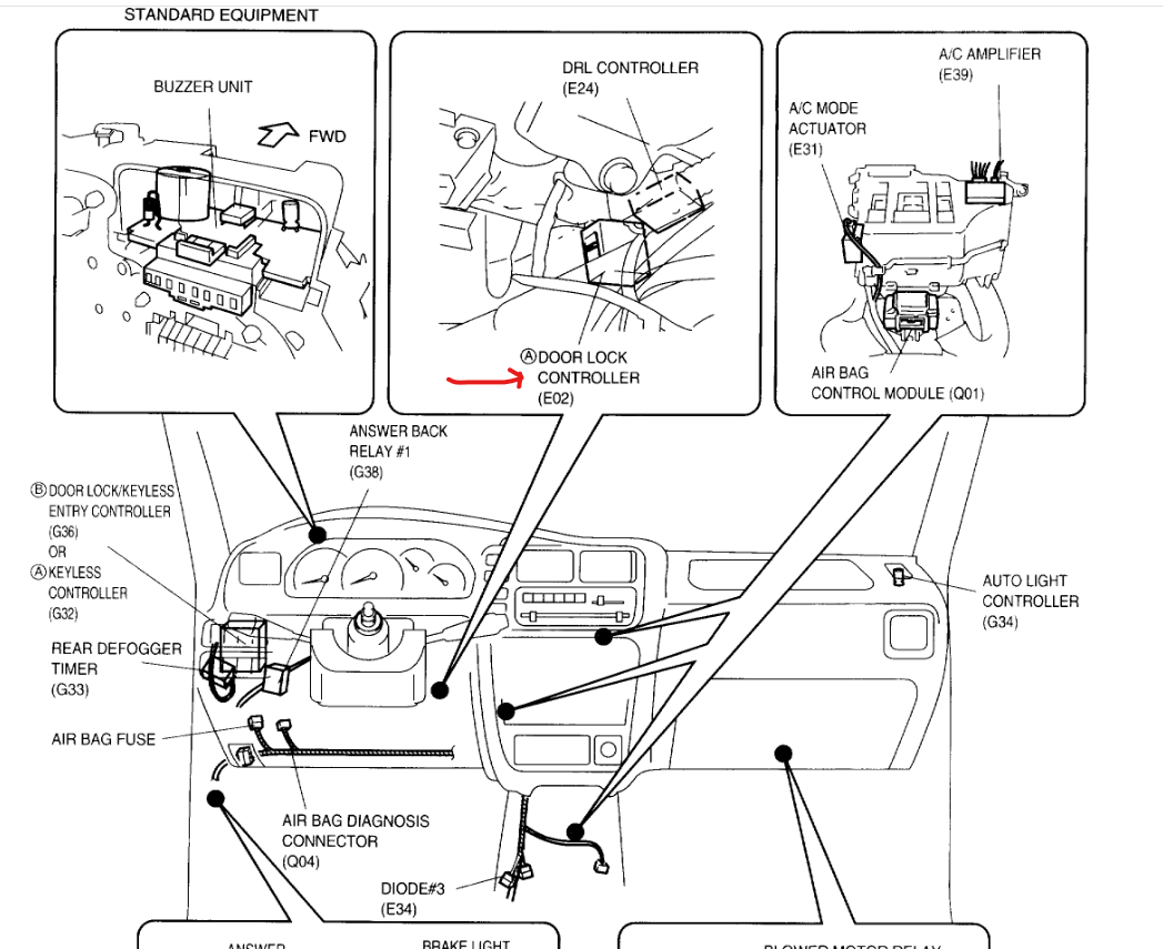

This happens when the door lock controller goes out, here is the location so you can change it out to help fix the problem. Check out the images (below). Let us know how it goes.
